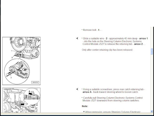

    I have brought all of the nexessary parts but have a problem with removing the black connector in step 5....i have tried everything ...pulling/pushing/messing with the little red clip but I just ant get it off!! any ideas where im going wrong? i dont have a steeringwheel on my car at the moment and would like to get it sorted ASAP lol

     There is a hidden clip to be pushed, have a look at the link attached it should help.
    http://lh3.ggpht.com/davidpeternolan/SMUDXN7tlRI/AAAAAAAAAWA/ZuNoaek1Gqc/s144/ccm.jpg
    Sorry try the one below;
    http://lh3.ggpht.com/davidpeternolan/SMUDXN7tlRI/AAAAAAAAAWA/ZuNoaek1Gqc/s512/ccm.jpg

     That image is about the size of a stamp on my screen.

     thanks guys :) i did figure it out  eventually! everything is on there now just having a problem with the steering wheel, it seem to have forgot about the fact that i have power steering lol! im going to hook it up to a vag com this week and see if i can resolve it....cheers 4 the help guys
