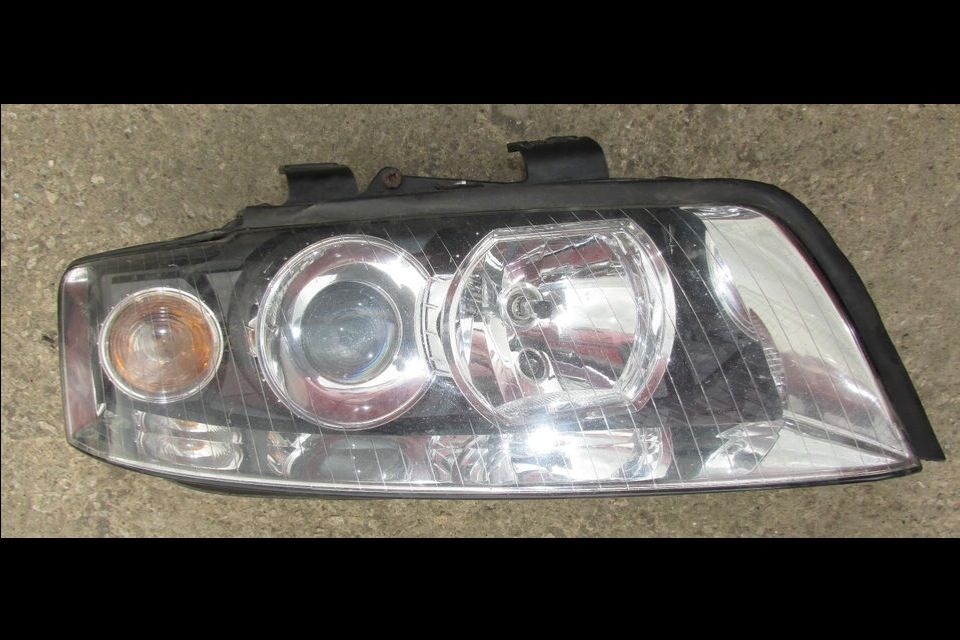

Right Tuesday I got a bit of time to myself so I set aboutchanging all of my bulbs, bar the fogs as they were that fused i snapped my T20bit so I've sprayed them with a bucket load of WD40 to soak, and I will try toget them swapped at the weekend if I have time.
Here is a little comparison shot of the standard and nightbreaker bulbs next to each other
mmmmmmmm look at those sexy golden bits

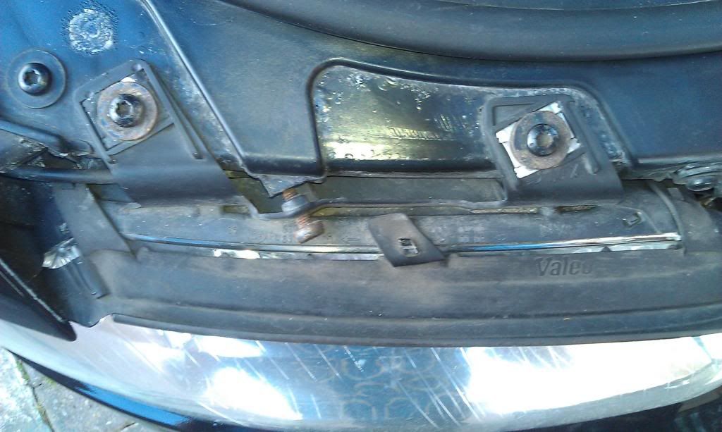

Right down to the nitty gritty, and before you start if your planning on doing this in front of the car because your lazy and can't be bothered walking all the way to the kitchen table get a nice big piece of cardboard.
There are 4 Torx bolts/screws holding each light unit inplace.
There are two on top that are clearly visible
One down the left hand side by the radiator hose
One down by the power steering reservoir
The two on the top need to come out completely, but the twoat the bottom only need to be loosened off.
There is a little plug that holds part of the loom to theunit that you have to pull out also that is on the inside
48ea8387-6fe9-4e87-9024-262db1accd0c_zps
Once this has been done the unit will slide out a few inchesto allow better access to the main loom plug.
Once out a few inches you can then get a flat headedscrewdriver into the release hole for the loom which needs to be pulled off theunit to fully pull it out
The drivers side involves a little bit more as you have toremove the cold air feed pipe, but this is only a case of removing two screwsthat you can see below. Once these have been removed you simply pull the twopieces of plastic pipe up, and the top piece just clips into the air box.
Also be mindful of the bonnet release cable whenremoving/refitting the drivers side as it passes along the top of the lightunit
Then there are two on top again
One on the inside where you can also see the small loom plugneeds to be pulled out
And one down the back near the air box
Now remember that piece of card I spoke of earlier well thisis where you use it. Stick it on the floor so you can put the light unit downwithout damaging it.
There are two metal clips that need to be popped open so youcan remove the plastic covers. You can use your fingers so don't be tempted touse a screwdriver, or similar as you will most likely break them.
The indicator bulb holders simply twist then pull out. It'sat this point that you need to put a clean pair of gloves on as the oil, dirt,and grease on the gloves you have on will just damage your nice new bulbs.
When you take the plastic covers off you will notice thatthe sidelight holder is hidden behind the leveling motor, but it simply twistsout of the way
Once you have replaced the bulbs its time to fit the lightunits back into the car which is pretty easy you simply push them back in sothat the clips sit into the bottom of the light and around the lower screws.
If the lights won't simply push in with minimal effort thenthey aren't lined up properly, so don't force them just pull them back out abit and try again. Once in you just have to push the loom plug back on until itclicks, and clip the little loom back onto the side.
Then sit back and enjoy no more orange in your headlights,and much better light output.
