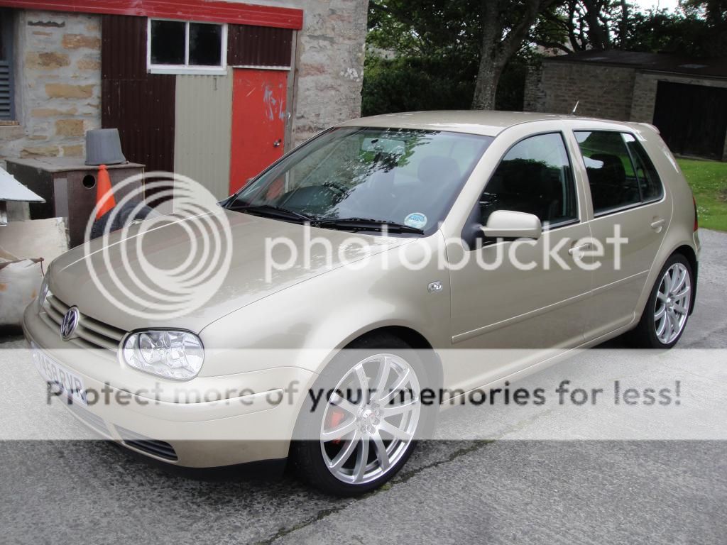

Hey guys, Thought id join this site and share my car build with you guys. Its a 2001 golf GTTDI 115, Colour is storm beige which a lot of people seem to either love or hate. This is a pic of when I got the car in July 2011. It already had some poly bushing, was lowered about 35mm on Koni springs and adjustable shocks. Wheels are 18x7.5" Kei force 10, Nice enough wheels just not very dub style in my opinion "not wide enough". Car was also fitted with a Tunit chip.
