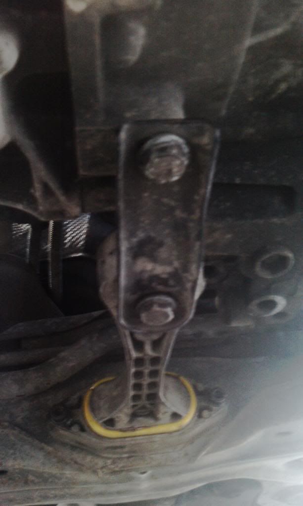

* Firstly I Jacked up nearside of the car to gain access to the DOGBONE MOUNT and support on an axle stand. Here is the Dogbone mount.
* Using a trolley jack and an old piece of wood (as a sacrafical material not to damage G/Box) find an appropriate area of the Gearbox to 'support' while removing the DOGBONE Engine mount. Which is held in by 2 x 16mm bolts and 2 x 13mm bolts. [nb DO NOT SUPPORT THE ENGINE USING THE SUMP AS THERE IS A HIGH RISK OF DAMAGING IT.]
*Once you remove the bolts the DOGBONE mount should pull out of the chassis, nb. one of the bolts snapped on me while trying to remove it thus causeing a sleight problem, enough of the threaded portion was still visable so i used the 2 nut method of removing the rest of the bolt.
