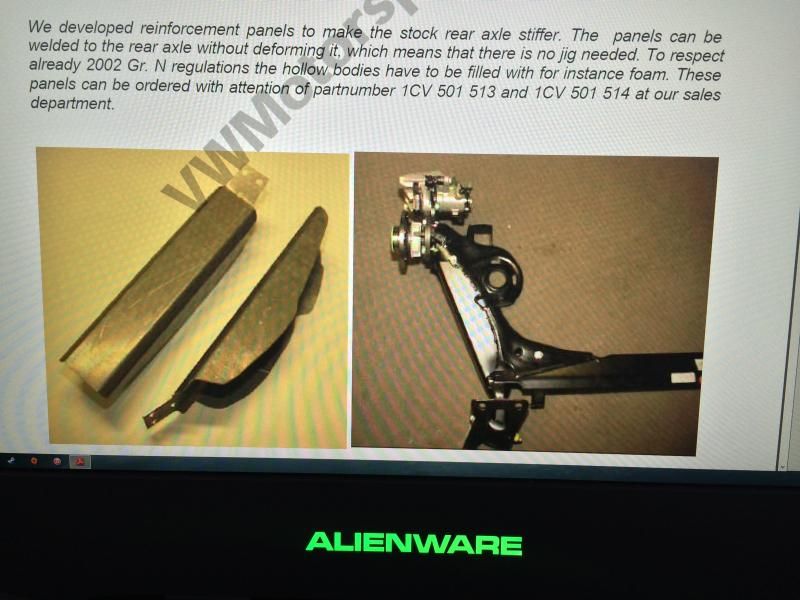

Some people might remember my plan from earlier. I'll recap anyway.
I've spent a fair while researching the design of the rear beam and how it flexes. Which has brought me to the conclusion that the best way to modify it would be to copy the discontinued VWMS reinforcement plates that get welded between the stub axle mount and the beam pivot.
This design keeps the dynamic camber ability (the reason the beam pivots are at an angle on the mk4) without restricting it. But reduces unwanted toe deflection when cornering hard..
They used these only for one season but that was only due to homologation rules not really allowing this type of mod. I'm not going to be racing so obviously those rules do not apply to me
DC1CB133-0844-4A15-8104-327C03440B94_zps
Hopefully start fabricating these tomorrow :)
#18 northpole
northpole
  • 5564 posts
  • Suffolk
  • Golf IV TDI 1.9 AHF 110PS
Posted 02 October 2015 - 06:10 PM
just a note for you it could mean the wheel can hit the axle so make sure you have the right wheels before you start ;)
#19 MonK-E
MonK-E
    Si
  • 2366 posts
  • East Sussex
  • Mk4 Models
Posted 02 October 2015 - 06:19 PM
Plenty of clearance with 7"wide wheels and 15mm spacers. Won't actually need the spacers but I like to keep the track reasonably square front to rear ;)

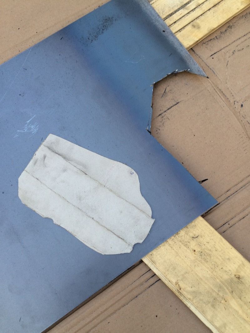

Made a good start on the beam today. As with all good fabrication you have to start with a bit of C.A.D.
So I made a template up and cut it out.
6032DB77-5A7C-47FD-A3A8-F74A3F3BAAC8_zps

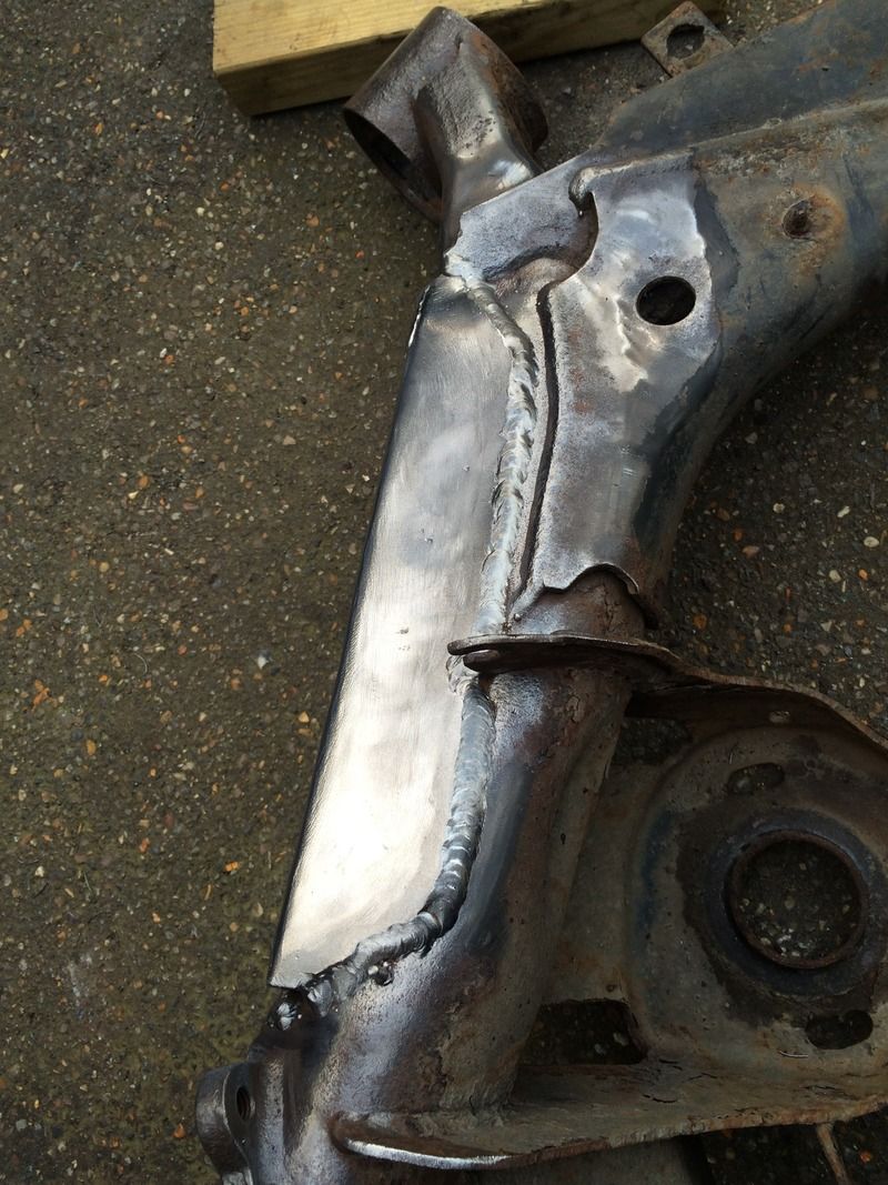

Once again I may have gone OTT with the material. 3mm plate is a bit of a pita to bend in a vice but after a fair ammount of thrashing about i managed to get it in to shape. Then I proceeded to weld it on
D8540493-AA9D-4BE4-9DDB-F819EE279C3F_zps
527CA19F-F963-4F57-A9CC-C87A00DF01AB_zps
7DA06BF6-F60B-4782-9B03-9B77421420DA_zps
That'll be one side done :)
#24 Mr Alex
Mr Alex
  • 142 posts
  • Hastings birth place of the pothole
Posted 03 October 2015 - 08:18 PM
Bloody good job dude.
#25 MonK-E
MonK-E
    Si
  • 2366 posts
  • East Sussex
  • Mk4 Models
Posted 03 October 2015 - 08:42 PM
Cheers bud :Y:

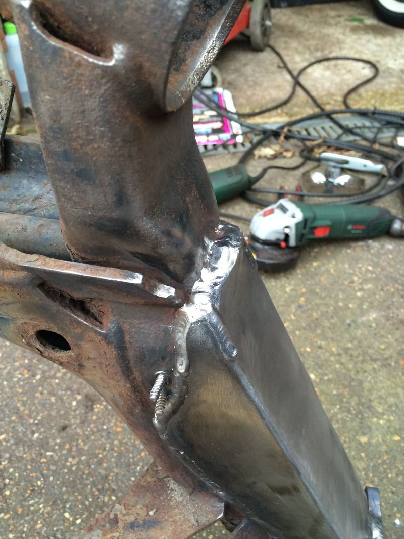

#28 MonK-E
MonK-E
    Si
  • 2366 posts
  • East Sussex
  • Mk4 Models
Posted 04 October 2015 - 10:53 AM
I'm not quite sure what you mean bud, not that I'm actually going to reuse them any way.
8FAACDAF-8667-4D79-B4ED-60FB41F19627_zps
If you mean the two little threaded stubs that hold the brake cable bracket, it doesn't matter about them as I run the cables at a slightly different angle/placement due to the side exit exhaust. Plus the plastic brake line clips are going as I'll be running full braided lines up to the chassis. No need to worry mate I have though this through ;)
#29 northpole
northpole
  • 5564 posts
  • Suffolk
Posted 04 October 2015 - 11:49 AM
sweet that was what i was on about but if you are running full braided lines you can route them differently.
