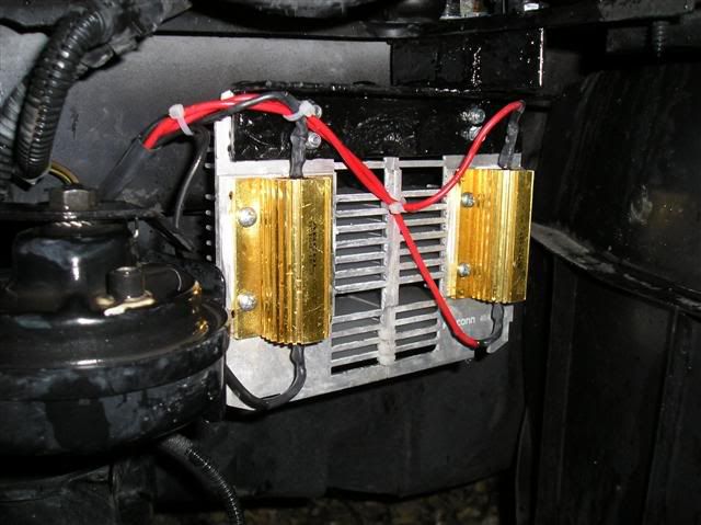

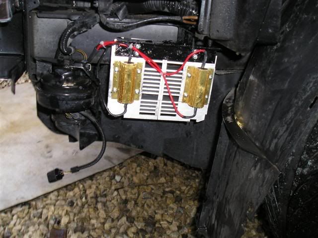

BIGAL: My fix is more straightforward, it only involves mounting two resistors on to a metal plate and splicing into the fan wiring. It does not involve any disassembly of the car (especially the fans) and does not damage the cars wiring loom. The only hassle is making the metal heatsink plate, it is only approx 30 mins work for anyone with simple metalworking tools. I have drawn up the heatsink and can email the drawing to anyone interested.

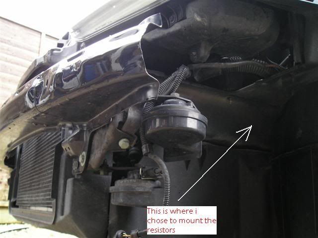

BIGAL: (The fix)I have been setting up my webspace to host this guide, hopefully it will be finished shortly, it will be viewable at http://website.lineo....james.lorely/
Andy, both resistors are on one heatsink which is mounted under the passenger side headlamp. It is not in the fan airflow and doesn't need to be provided the heatsink is the same or larger than mine. I tapped into the wiring on the fan side of the wiring, this means if anyone want to replace the fans later and remove the mod then the cars wiring is undamaged.

ANDYMAC:
I have done the resistor mod and it works fine, howver you do need a fairly substantial piece of aluminuim as they do get exceptionally hot (Still going 10000 miles on)

RHEMINGWAY:GET YOUR ALI PLATE HERE!
I did the external resistor mod last weekend and they work a treat.
A mate in the metal industry, laser cut a piece of 3mm ali using the template on Big Al's site.  I followed all the instructions on his site so thanks a lot Big Al, you saved me a fortune and the template was spot on.
This shape fits fine on V5, V6 cars (thats what Big Al had) and I have a 150tdi so assume it would fit all the TDI's.
If anyone wants a plate laser cutting then I can get them for 13 each, but the minimum order is 10 pieces.  If anyone wants one then send me a pm or maybe reply here, I could set up a group buy if enough interest.  I am not making any profit on this, its cost so if anyone can get it done cheaper then thats cool.
Hopefully there should be a pic attached.
Rich
RHEMINGWAY FIX GROUPBUY: http://www.uk-mkivs....0/ShowPost.aspx

hi guys, did the 'fan fix' over the weekend and it works a treat! these instructions on here are brilliant and easy to follow.
i took the bumper off my 4motion to make it easier because i couldn't get the headlight out, but with the bumper off i discovered that there was no way that i was ever going to fit the resistors on the plate under there, so i made a bracket and mounted them infront of the wheel arch by the horns:
then mounted the resistors on some old computer heatsinks i found and voila!! they fit a treat and being where they are, they get loads of air flow when on the move! all joints were soldered and shrink wrapped to stop any crap getting in too, cos i hate having to re-do connections because they corrode! stupid gonky spade terminals..
