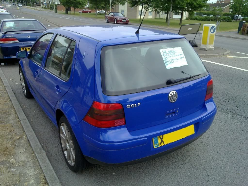

Hi, im sootpig, welcome to my build.
As sold:
Current list of mods:
Repairs since ownership (because it's not all mods and happiness):
Then
well, i sold my 1.6 8V AKL.
it was a brilliant first car, and it taught me alot about working on cars, which is worth alot, knowledge is power, as they say. but it was just time for something a little... better.
It all started out when one morning, on the way to work, i spot this
I noticed it was up for sale, so the next day after work, i
stopped to have a look at it, when i noticed the v5 badge on the front
grill, i started to get excited, so i headed home, to do some research,
as i knew very little about these engine.
a little dabble on uk-mkivs later, and i knew what i was looking for,
a 170ps engine under the bonnet, 312mm brakes etc so i gave the guy a
call, and had a (very short) test drive...

thats a tidy car. I saw it for sale on my way home from work. Usually just heaps of rubbish for sale on that road
