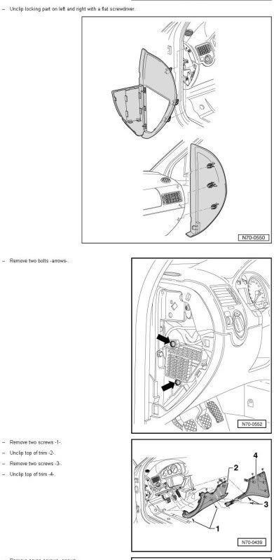

Removing lower dash (under steering column):

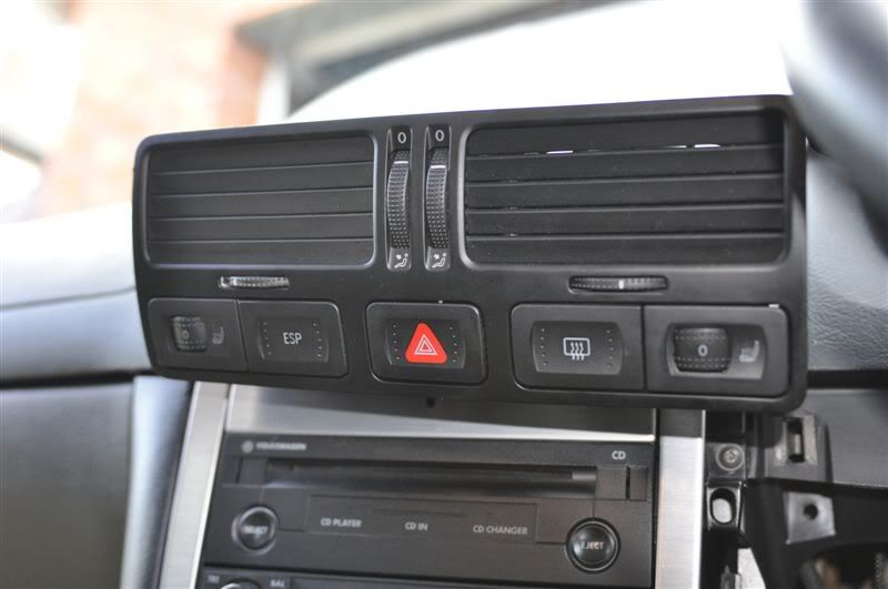

Installing the heated switches:

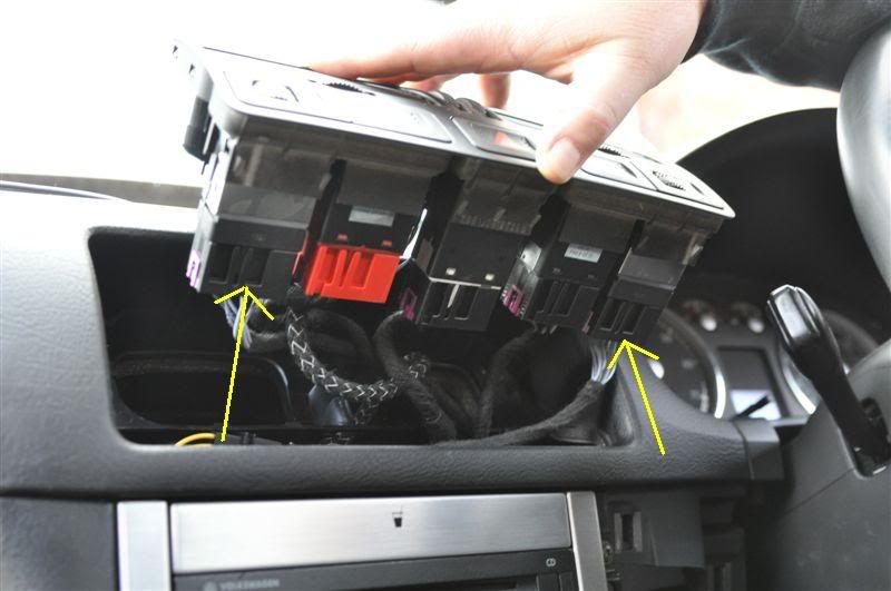

  • feed the 2 x larger plugs (rectangular & black) on the Kufatec loom from the steering column area to up and behind the centre vent area
  • remove the 2 x blank switches within the centre vent frame
  • install the 2 x heated seat switches in their place
  • plug the 2 x larger plugs on the Kufatec loom to the switches - DO NOT REINSTALL CENTRE VENTS YET....50/50 chance of having the plugs the correct way round as they are not labelled L and R

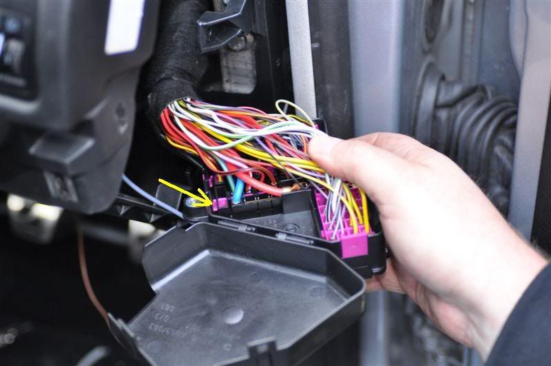

Wiring up the Kufatec loom:
  • wire 'label masse-' (earth) connect under steering column (round end connector attached)
  • wire 'label zondungsplus S5' (switch live) connect to 75x on relay board but you will need to add a round end connector to the wire
  • wire 'label schraubklemme KL30' (permanent live) connect to 30 on relay board (round end connector attached) - this is the loose wire
  • wire 'label sicherung 44 dauerplus' (fuse 44) connect to rear of the empty fuse slot 44 - you will need to slide the plastic purple locking strip as highlighted in the second picture below
  • wire 'label schraubklemme KL30' (permanent live) now connect the other end to fuse slot 44 - this is referring to the loose wire again
  • install 20amp fuse to fuse slot 44
  • wire 'label beleuchtung PIN17 light shalter' (light circuit) connect to the grey/black wire behind the light switch - to remove the light switch turn to side lights whilst pushing in and the unit will come away

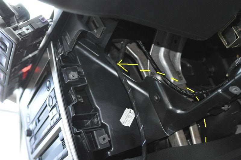

Connecting the seats to the Kufatec loom:
  • feed the remainder of the loom under the centre console/tunnel towards the seats
  • slacken off the 4 x screws holding the centre console/tunnel in place (2 x near pedals & 2 x gear lever - either side)
  • feed the 2 x smaller black/purple plugs under the floor carpet under the centre console/tunnel out to each seat
  • plug into seats and refit seats

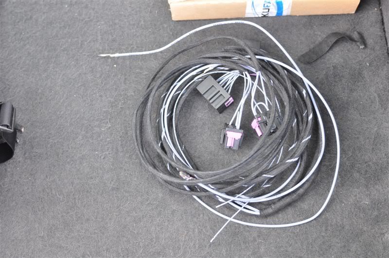

Good quality + detailed pics of the harness before it was installed would be nice.
What harness?
What harness?
I think he means the Kufatec wiring harnes maybe  [8-)]

Only pic I've got of the loom before it was fitted...

Just thought I would add that the loom is designed to run under the drivers side sill plastic to the seats, not via the centre console. The loom is exactly the right length for this. So it should leave the dashboard via the bonnet release pull area.
So first going to the drivers seat, then "up and over" the underside of the centre console to the passenger seat.
Yes
We figured that due to the odd length wires but it is much easier to send it down the centre console.  A lot less trim to remove that way.  Probably saves you an hour or two too.
