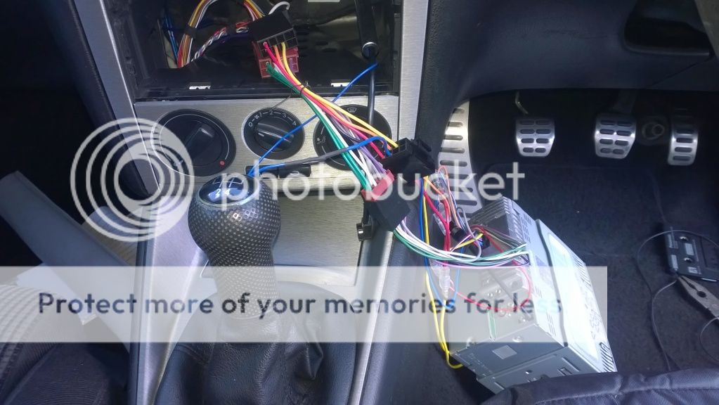

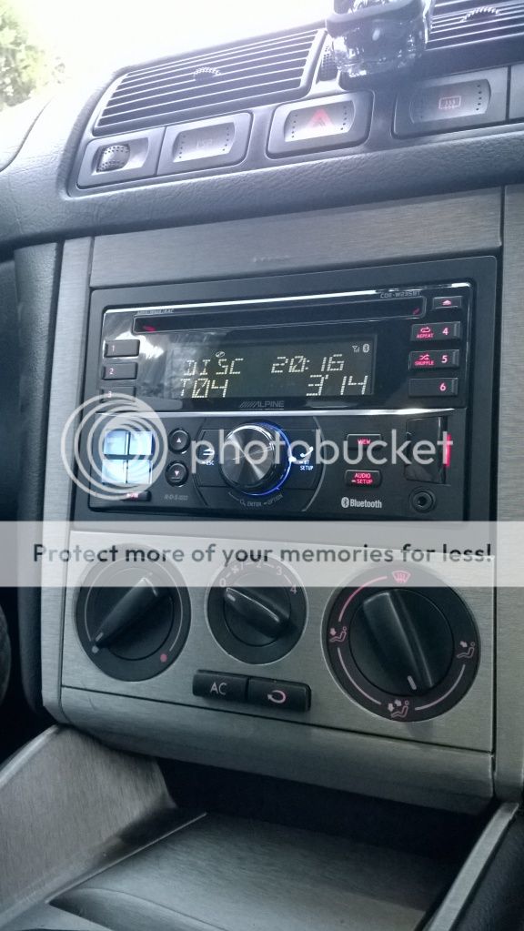

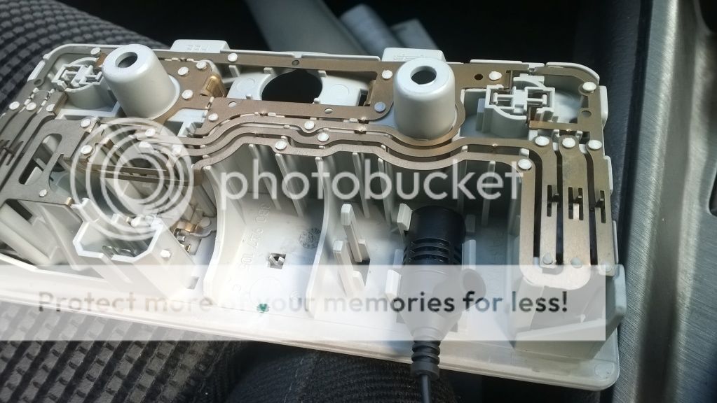

Posted 28 July 2014 - 05:43 PM
Fitted new alpine head unit with Bluetooth hands free. Ran the mic up to the grill in the light for an eom+ style install :-) sounds great and nice not to have wires trailing everywhere! Used a pre made loom so if I ever need to go back to oem I can just un plug and refit.

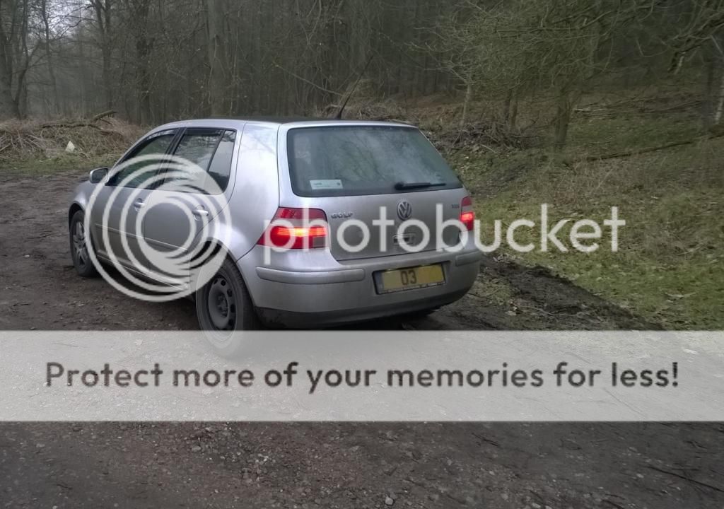

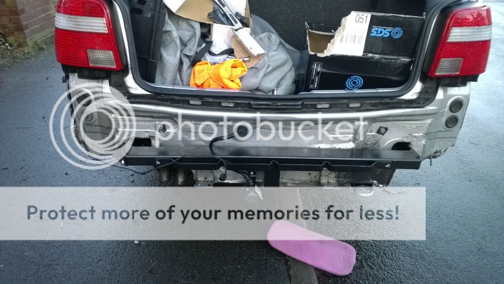

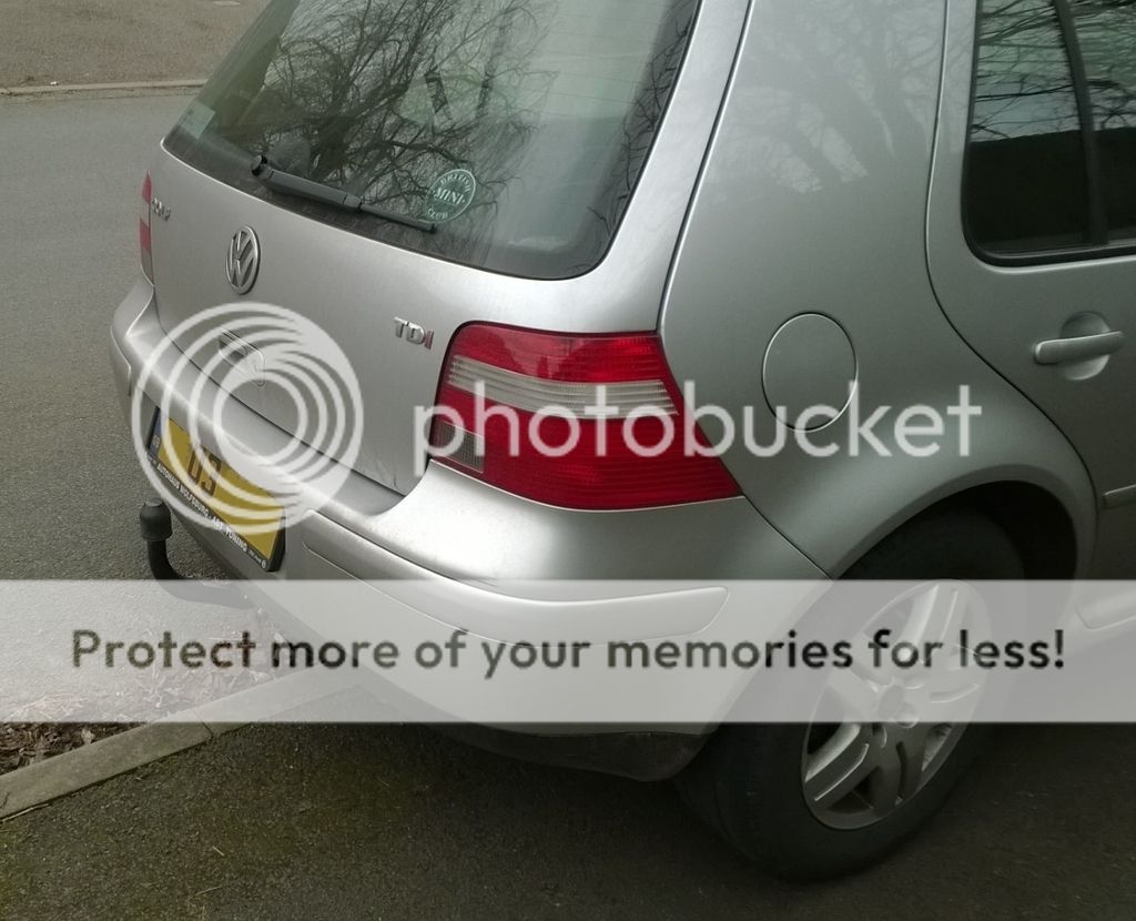

Posted 04 January 2015 - 10:29 PM
Fitted a detachable towbar.
Car been running faultlessly although is extremely dirty at the moment after a trip through wales.
Its also missing most of its interior at the moment, why? Well because racecar!! Well because I am cleaning of the horrible soft touch sticky rubber so it can be painted with a matt platsic paint. Done a test piece already and finish is perfect, looks just as if it was brand new and should last far longer than the oem rubberised finish

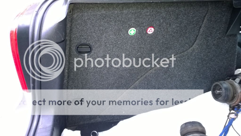

Posted 10 February 2015 - 08:45 PM

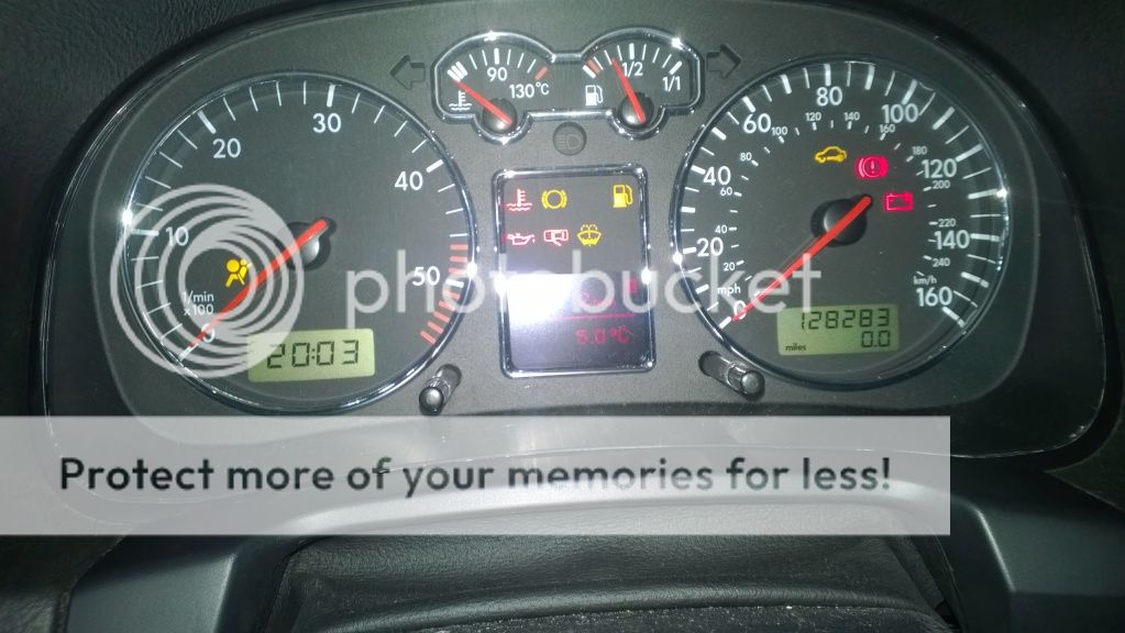

 Few minor mods.
Fitted chrome surrounds to the dials, and also retro fitted a low washer warning sensor as I was fed up of being victim to vw being too tight to give me 2 wires! Admittedly it took 2 attempts after following a pre 2002 wiring diagram first time around! :facepalm:
Also had MOT which it flew through no problems with a clean sheet. I did change track rod ends the night before in the snow which was fun especially with the fight the passenger side put up!
Surely shes got to be a worthy candidate for the dirty bum thread! rocking a steely as well!
Finally the interior is still in bits but nearly ready to go back in all clean and looking better than new :-)

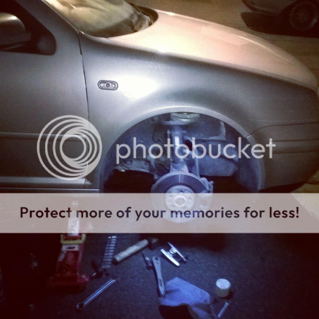

#40 Rob136
Rob136
  • 1377 posts
  • Golf IV TDI 1.9 ATD 100PS

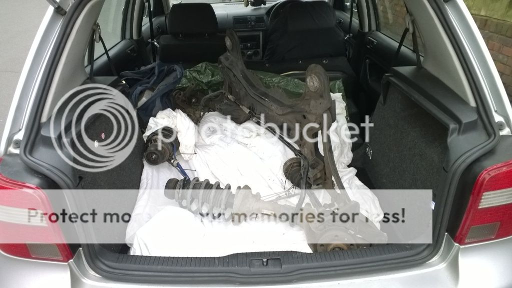

Posted 14 March 2015 - 02:48 PM
fitted a proper boot panel with the door (mine used to just have the strap).
Also had the golf in 'van mode' to go on a parts mission to pick up this:
Full S3 front suspension set up. will be refurbing all parts and replacing bushes and bearings before fitting :-)
  • VTubby TDi likes this

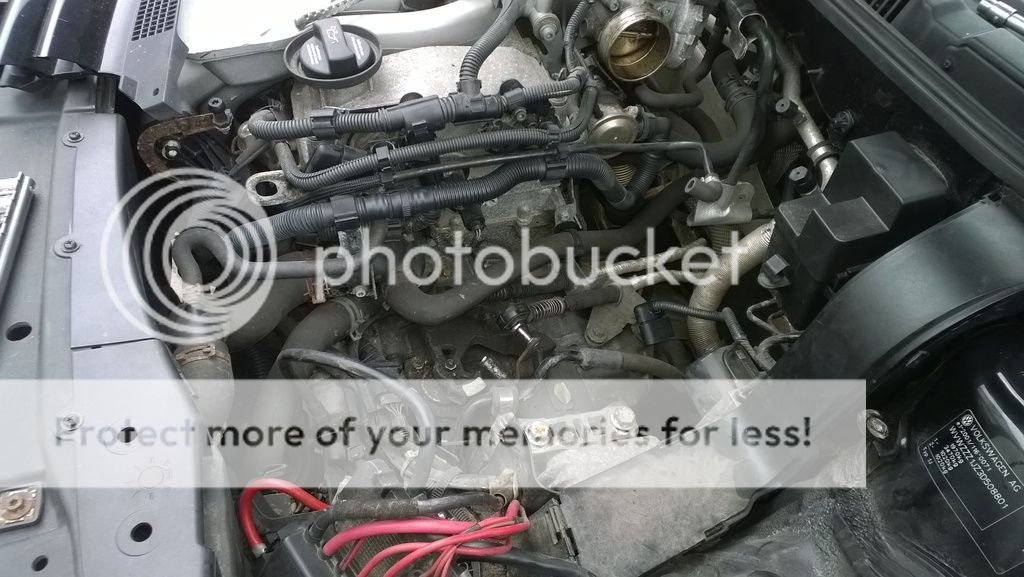

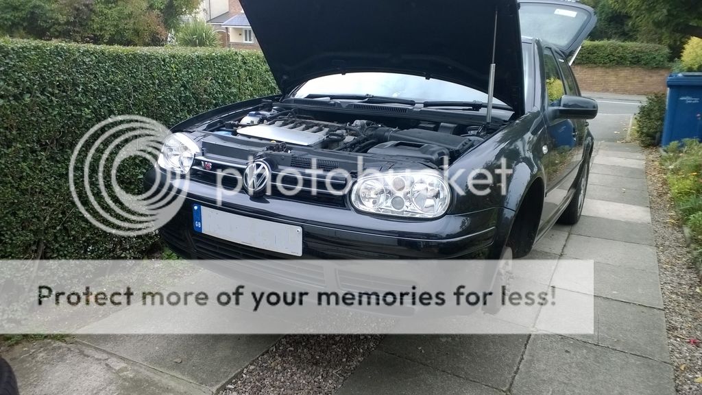

Here it is jacked up ready to start.
Airbox and battery removed and gear selector disconnected.
Front end off. left condenser connected as I didn't want to release the refrigerant and it had enough movement anyway.

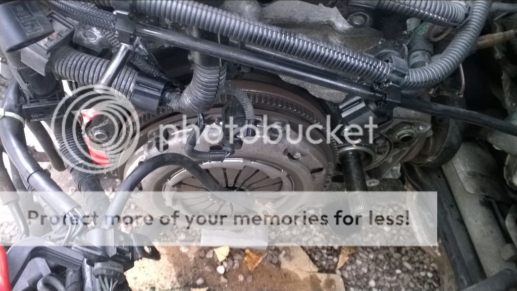

clutch and flywheel off.

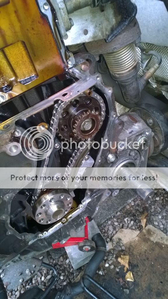

Timing covers off.

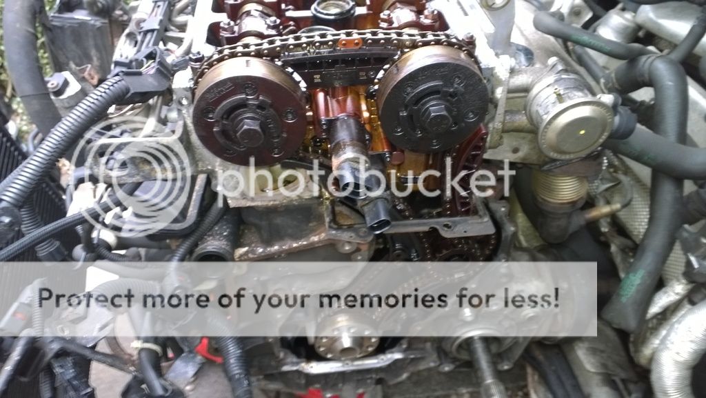

Cam adjuster and top chain off.
Bottom chain, guides and tensioner installed
Top chain and guides installed.

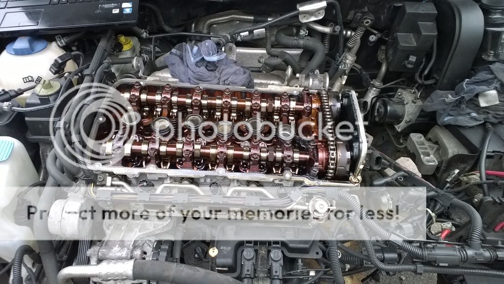

And that's where its at now. Ive turned the engine over by hand and checked and rechecked the timing marks and all looks good. need to get some sealant and the covers can go back on tomorrow but then waiting for a few gaskets from VW which should be on Wednesday. also got a bolt snapped In the steering rack so will need to drill that out ready for some new bolts, which should be fun!
