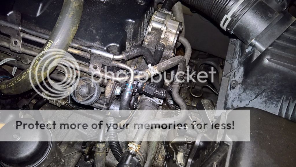

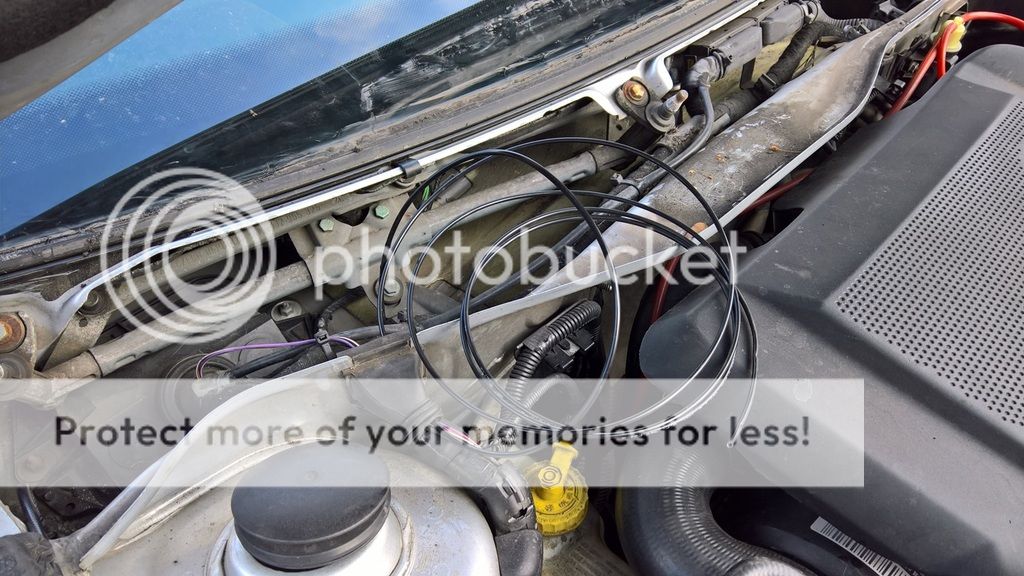

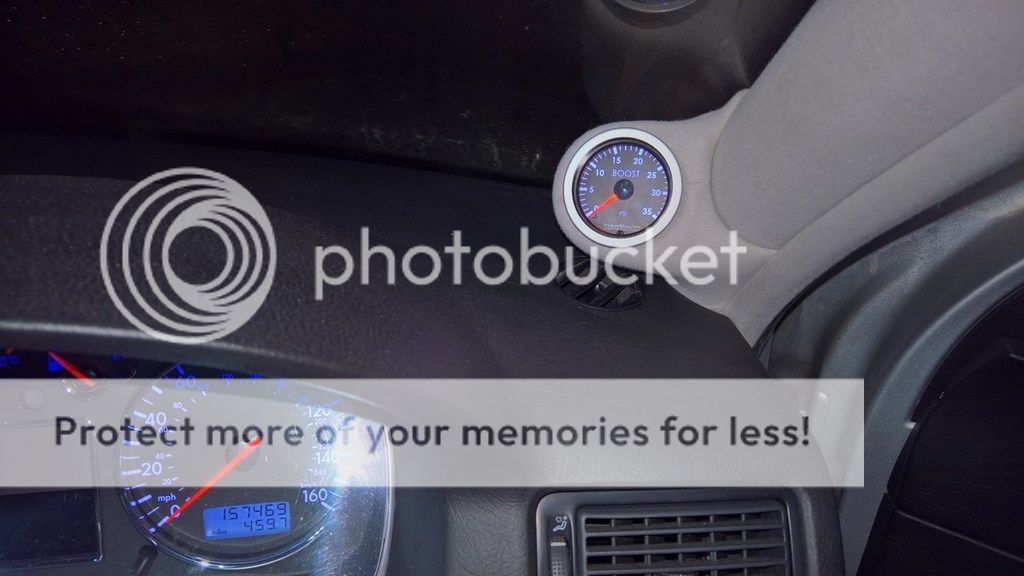

Fitted a newsouth TDI boost gauge for the full 90s max power effect! Fitted really as a gimmick but its actually very interesting (and distracting) to watch how the turbo is controlled! The boost hose take off goes straight into the side of the EGR delete pipe.
