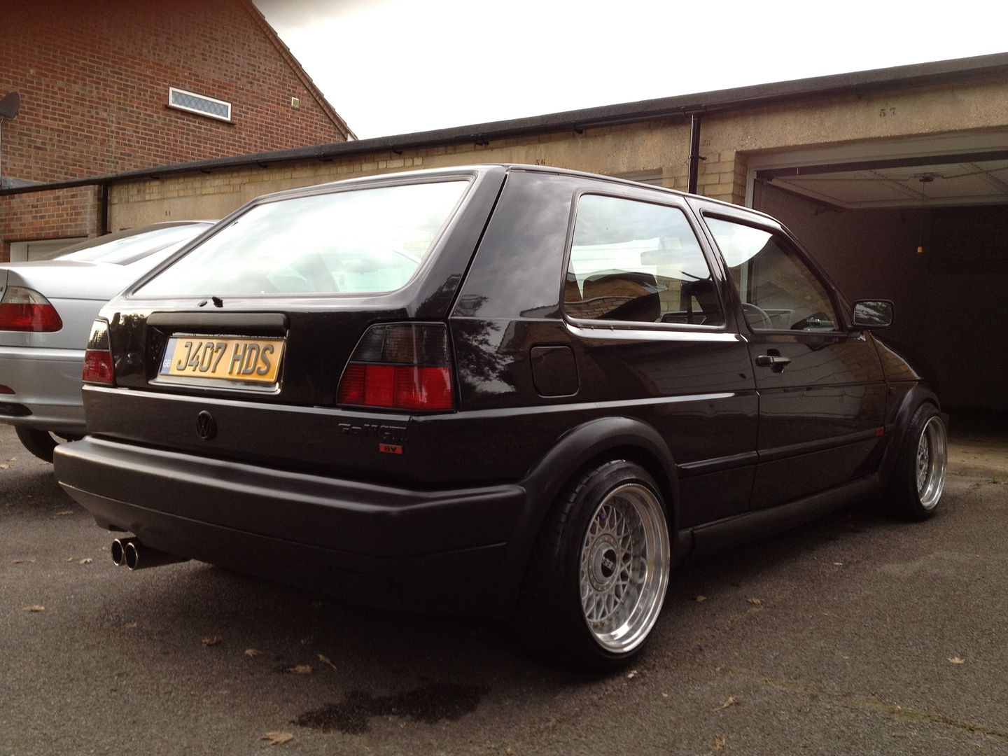

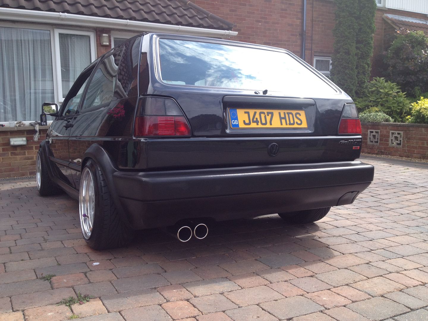

Thought I'd share a few pictures of my Mk2 Golf 1.8T :-)

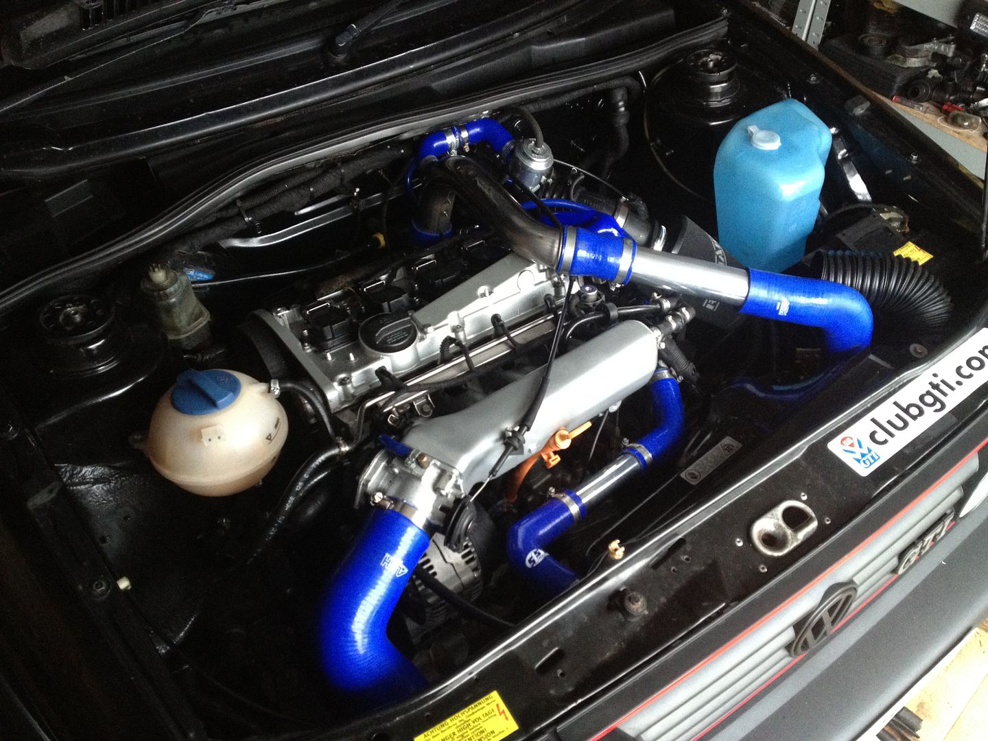

Whats the spec then? The engine install looks really neat and tidy.

But seriously awesome the paint looks spot on along with the clean engine

i think thats the tidiest mk2 1.8t i have seen, nice work! did you do it yourself? and like Tabs said, whats the spec?

very nice but up way to high it should be lower especially with the stretched tyres that are on other than that i wouldn't touch a thing

Looks amazing! Great engine install very neat and tidy :Y: Get the stance spot on and it will be the perfect MK2! :wub:

Spec on engine is as follows -
* Fully rebuilt AUM engine running on AGU management. Reason being is my previous engine dropped some valves, so an AUM replaced it.
I had a loom made up for the engine. Basically the mk4 loom and the mk2 loom were spliced together, allowing me to keep my current fuse box and keep things looking OEM and tidy.
* Uprated rods, valves, ect used throughout.
* K03s turbo.
* Qpeng down pipe 2.5" into Jetex 16v exhaust system.
* 02a gearbox, Mk3 shifter, VR6 Sach sports kit, New G60 flywheel.
* Diagnostic port added.
* Running standard map at the moment, but is going in for a decent mapping session in the new year. Just haven't had the time lately as I've been sorting out the mk4, and have a mk7 GTi on the way.
Cylinder head will be coming off this weekend though, as it over heated on me, and coolant was found in cylinder 3.
Lets hope it's just a failed HG and not a cracked block.
All the work, apart from the engine rebuild with uprated rods ect, have been done by me. Such an easy car to work on, and a car I'll never sell.
I have a 50+ page build thread on it over on ClubGTi if anyone fancies a good long read.

that's insane everything just looks so right with this car! might be able to go a bit lower but the wheels and tyres look spot on, can see why its popular   :wub:

What are the specs on the BBS's mate? My brother is trying to decide what route to go down with wheels on his Bam engined Mk2

They look like 15x9J to me. They sit a little bit further out than mine do:
1610008_10201520809400817_1083409707_n.j
Mine are 15x8.5J all round :)

8.5 on the front, 9.5 on the rear ;)

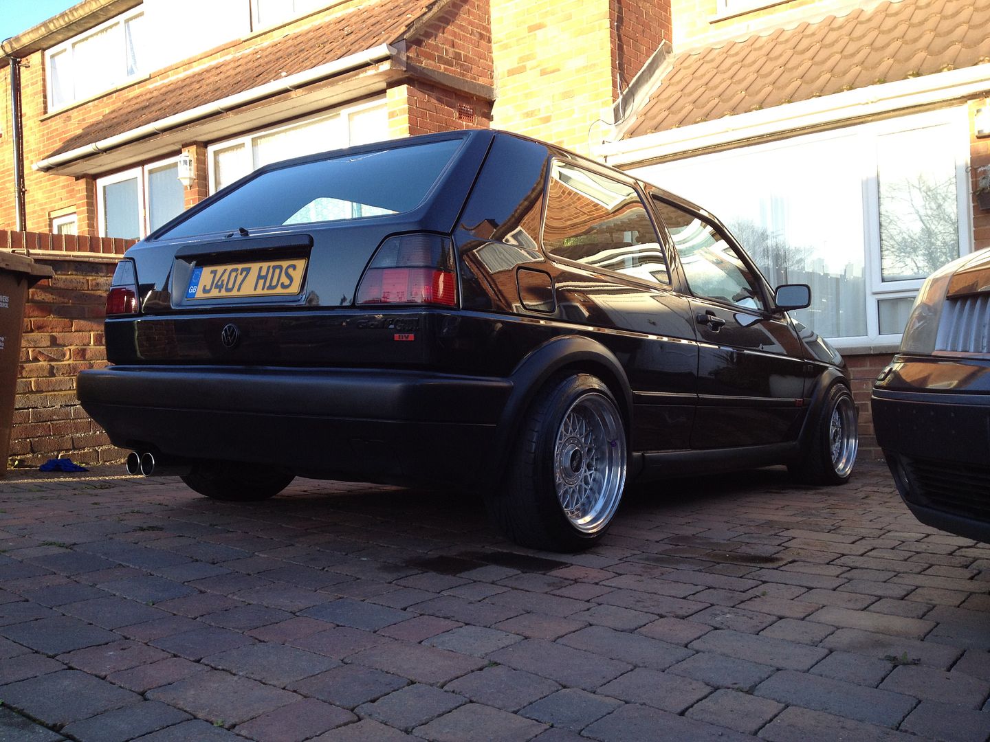

I love the work you've done to it but it needs to be closer to the tarmac mate! If you get the stance right the car is unbeatable especially if you have it mapped.
I don't care if you use coilovers or airbags it just needs to be closer to the tarmac. That's about what i would change at this point. For the rest it's done... unless you can get some really nice interior oem upgrades i wouldn't do anything else (except for the planned remap)

As much as I love it being low, the height it's at at the moment is practical for me, due to too many speed humps and bad roads near where I live.
I tend to take the MK2 out on weekend blasts, and having it drive able is key.
Maybe I might go air in the near future, but its got practically new coilovers on there at the moment.
Next but job is a respray. Will keep you all posted. :)
