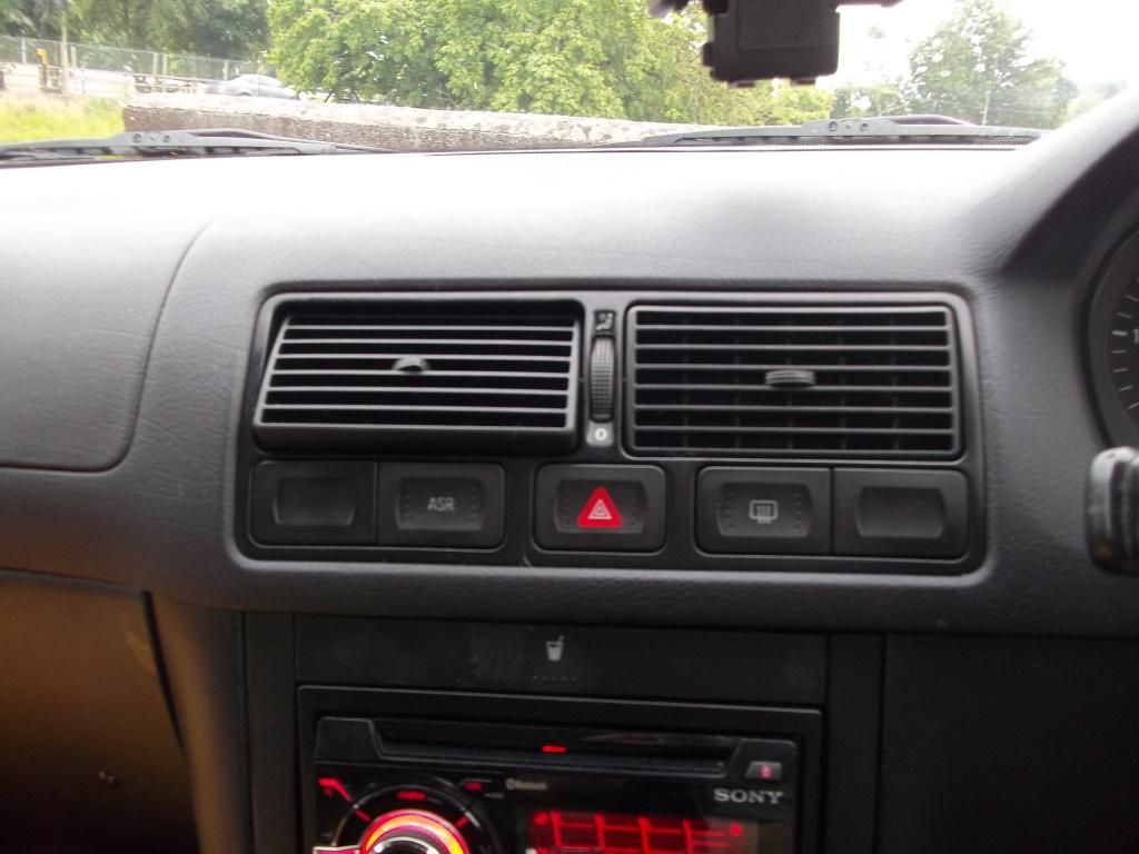

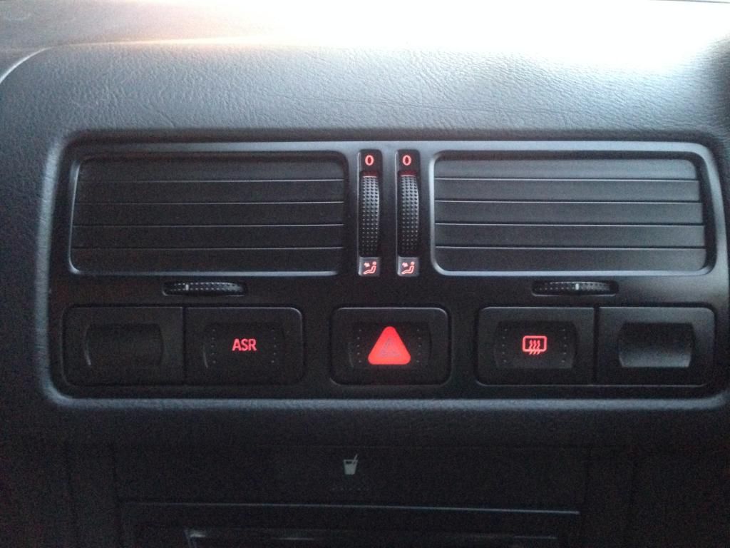

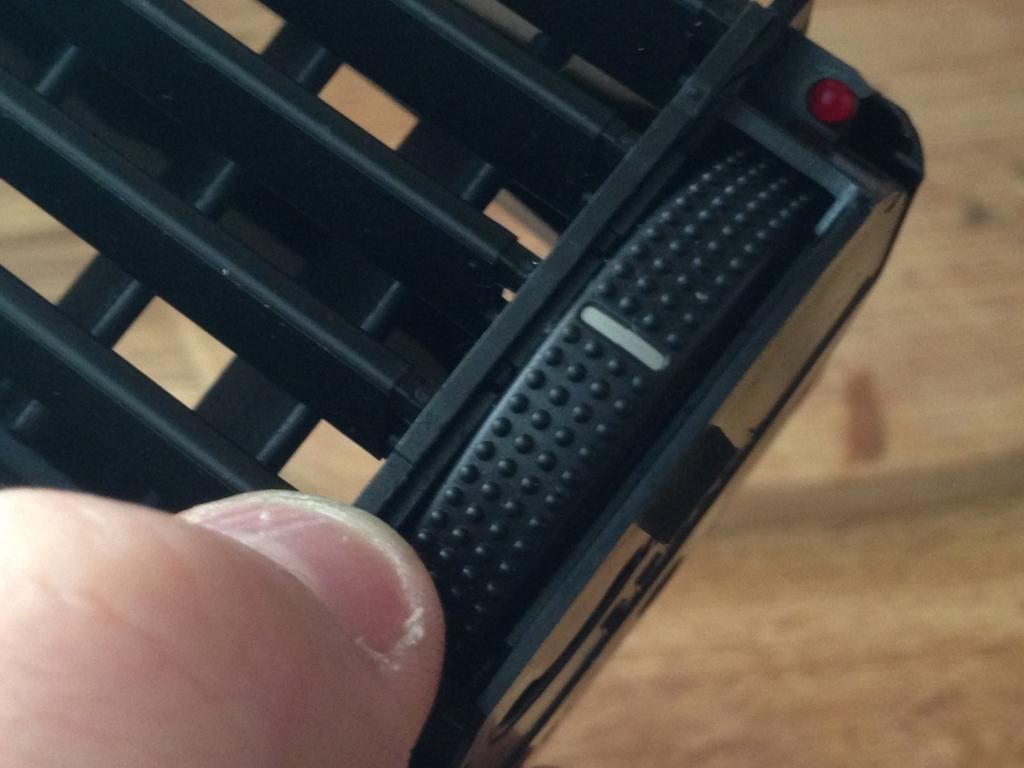

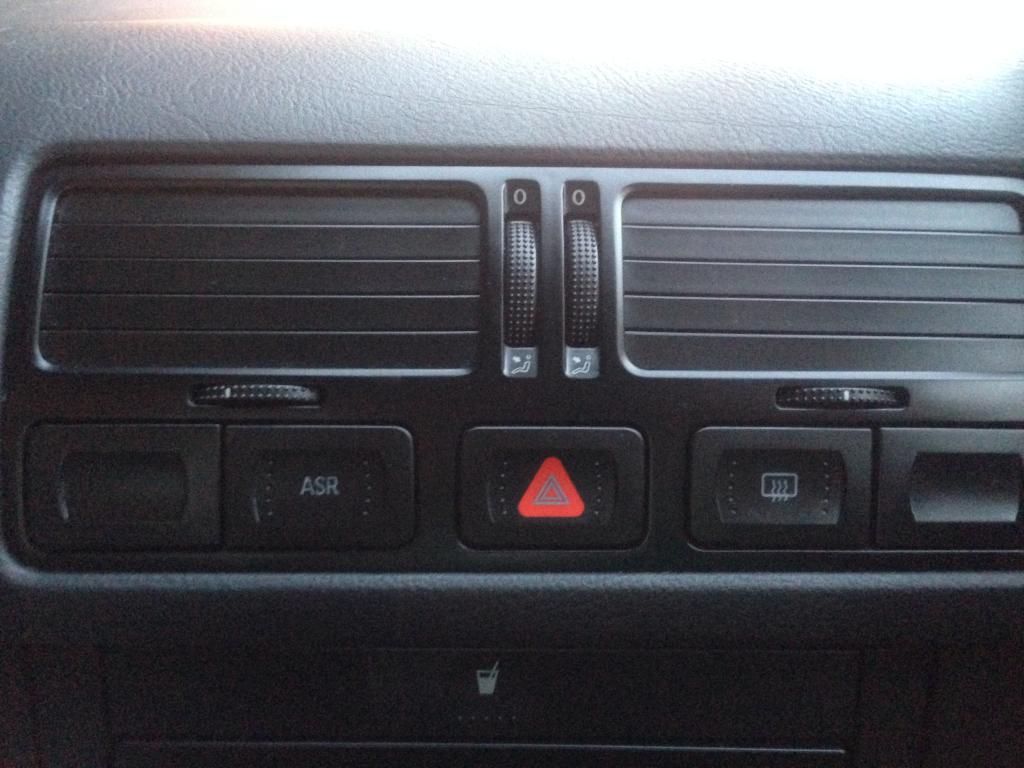

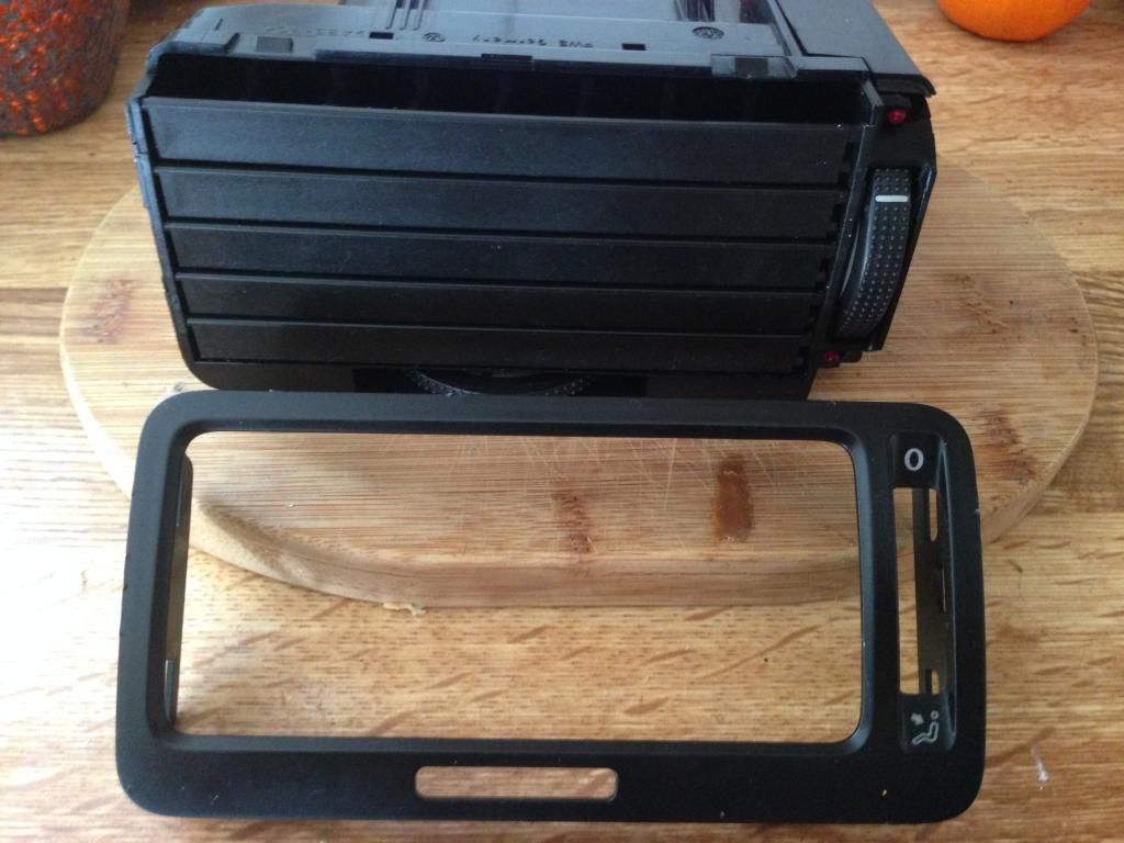

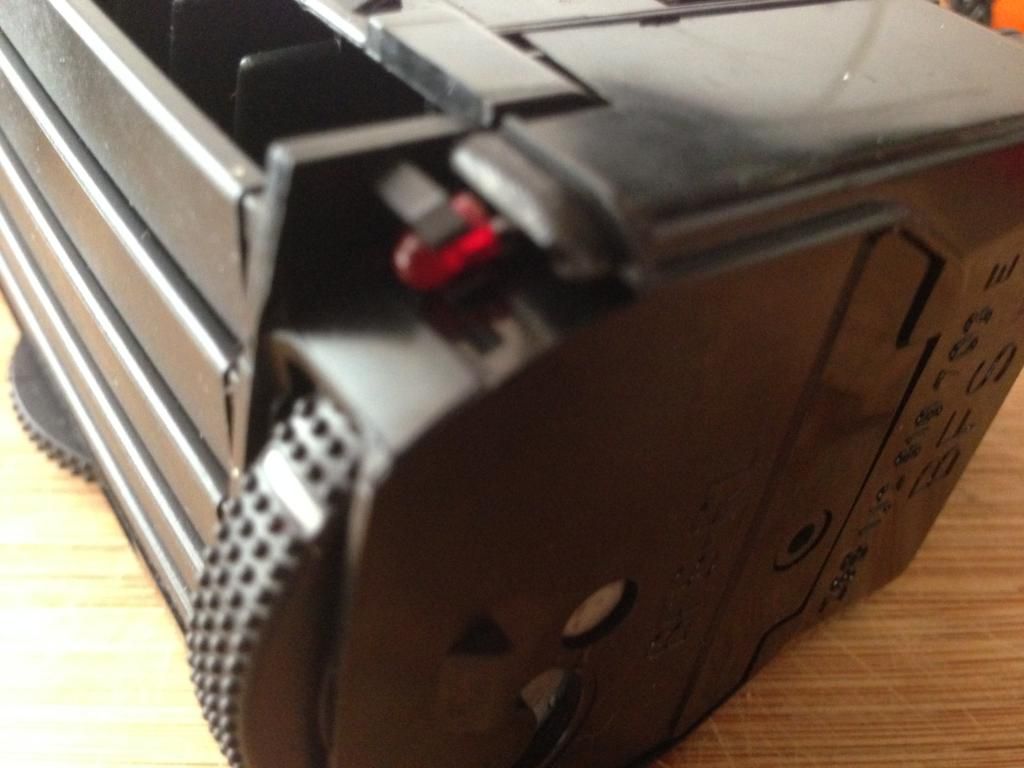

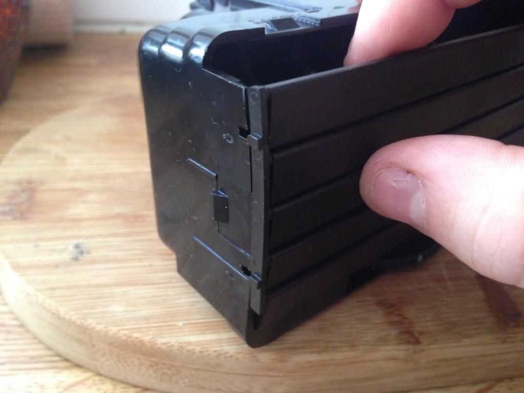

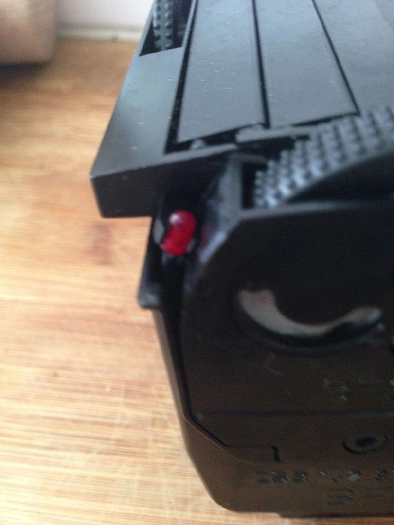

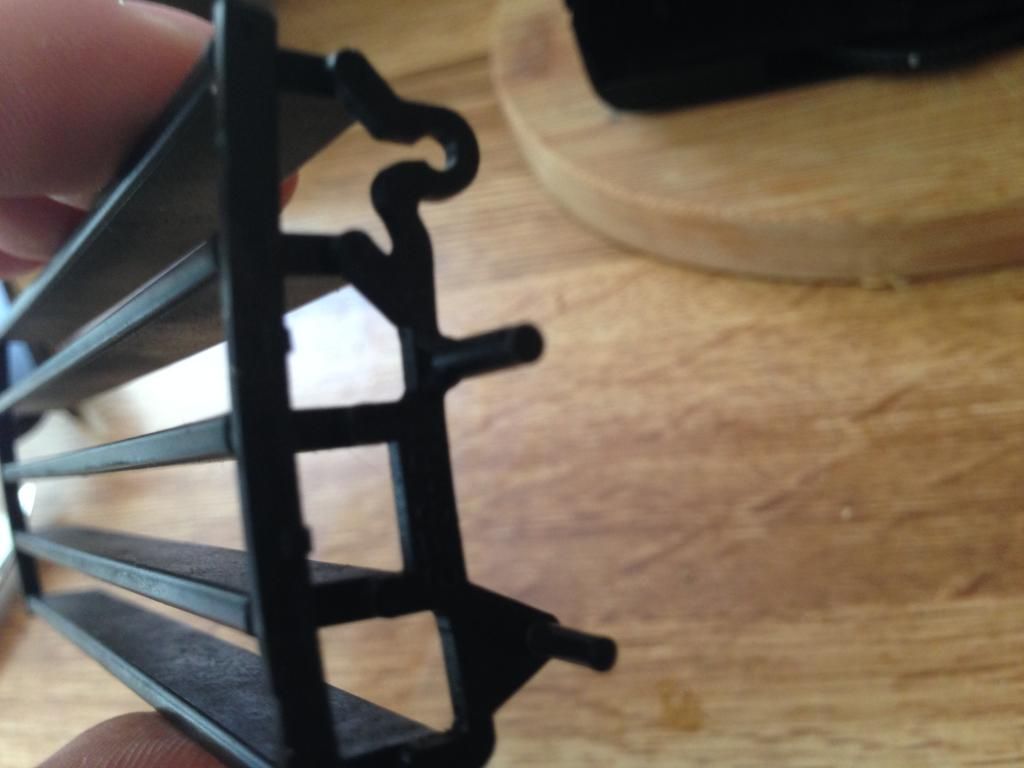

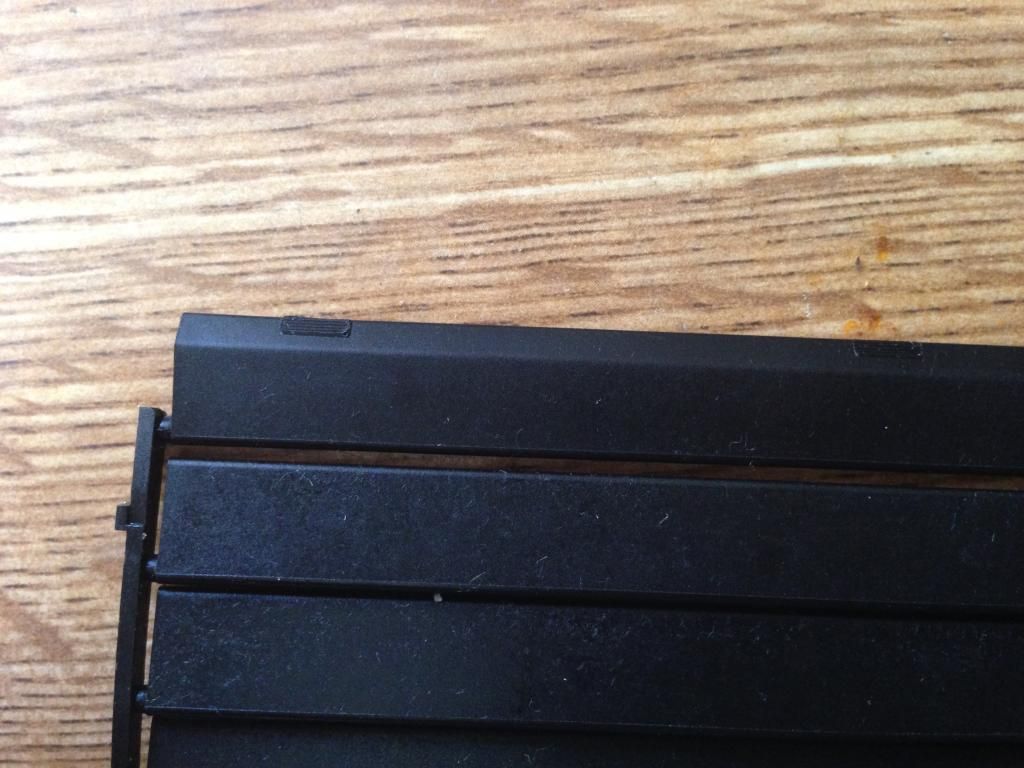

So had a few days minor work on the golf, still feeling my way with this one! Nearly everything so far is lighting related, however its the small changes that are the best if you ask me.

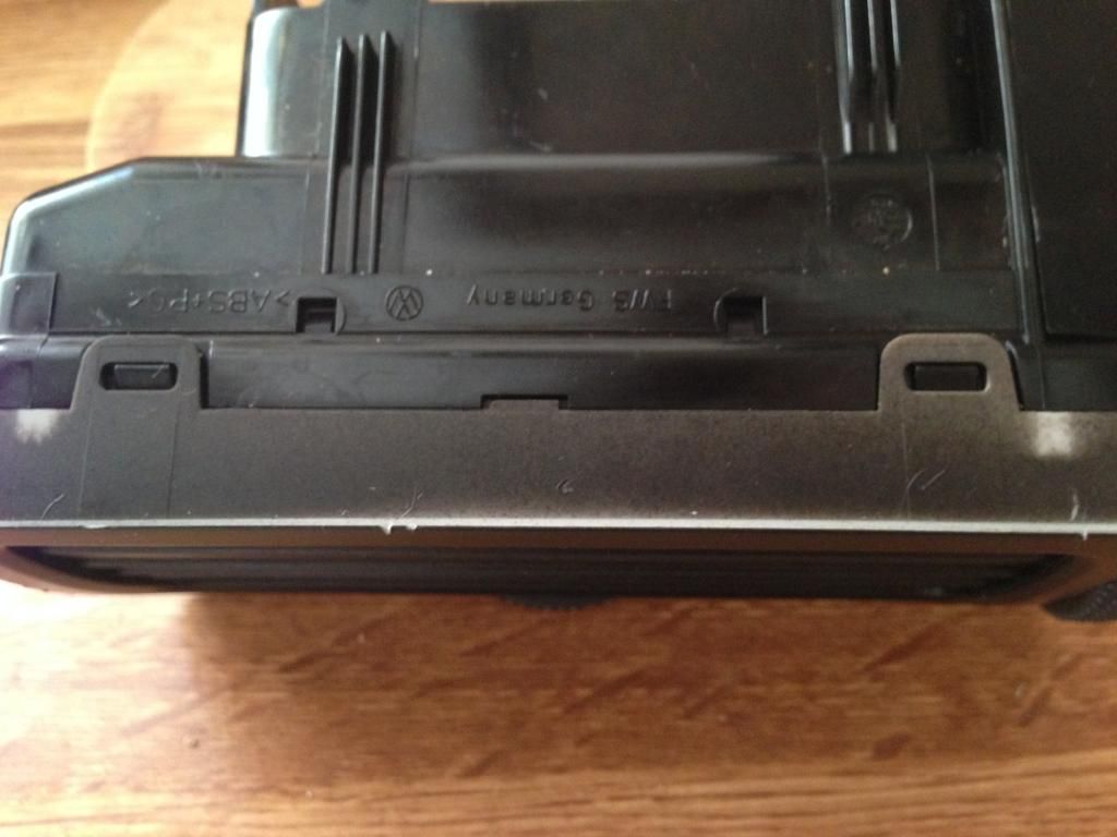

Managed to lay my hands on a full set of bora vents and a w8 light for cheap (no scene tax added wink.png ) and a custom w8 adaptor plug. Was VERY impressed by the packaging as they came from a lad on facebook and have had problems in the past
FECB654C-8741-4443-B02E-58F5A3D875DC_zps
Not being a wiring guru I have still to connect these all up however the vents and lights look better already!

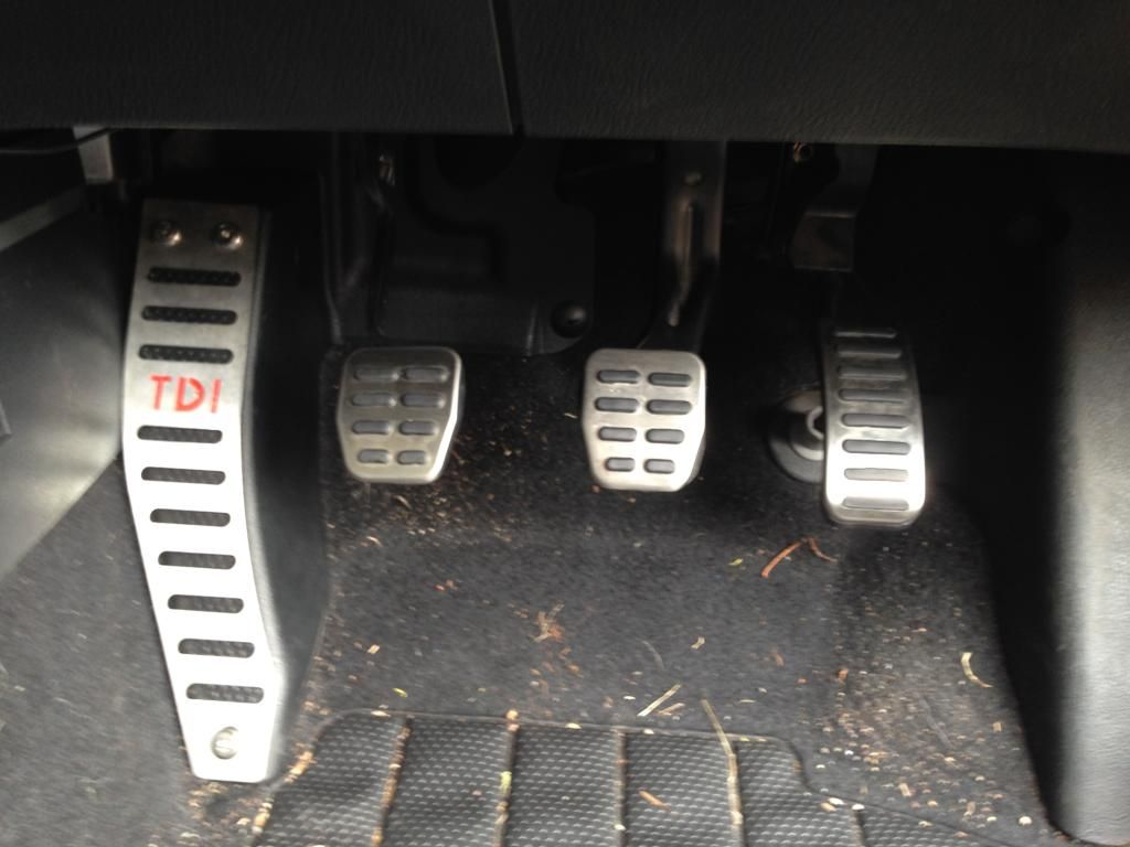

Lastly (yup been in the car a lot recently) I fitted a dead pedal cover and Audi TT pedals. The dead plate was a pain to put in, as to drill through the cover means having to drill right next to one of the fitting clips. Taking it slowly however paid off, and then with the plate screws in just enough to hold it I refitted the foot rest before tightening the torx screws. This meant the cover slid on as it should then the plate screws could dig into the carpet rather then obstruct the fitments. The pedal covers were a breeze to fit as well, (top tip: Soak in hot water first, makes the rubber skirts so much easier to work with!)
The gas pedal I got is too large to fit on its own accord, however a trimmed down number plate pad solved that problem  thumbsup.gif
Just needs a quick hoover and will look mint!

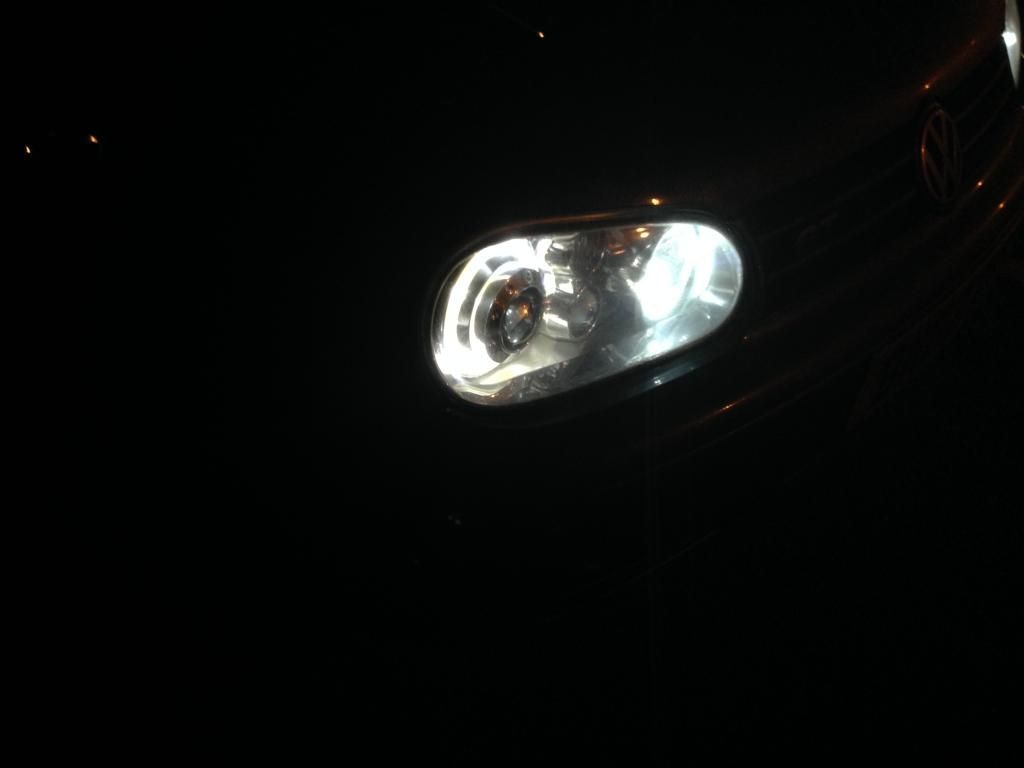

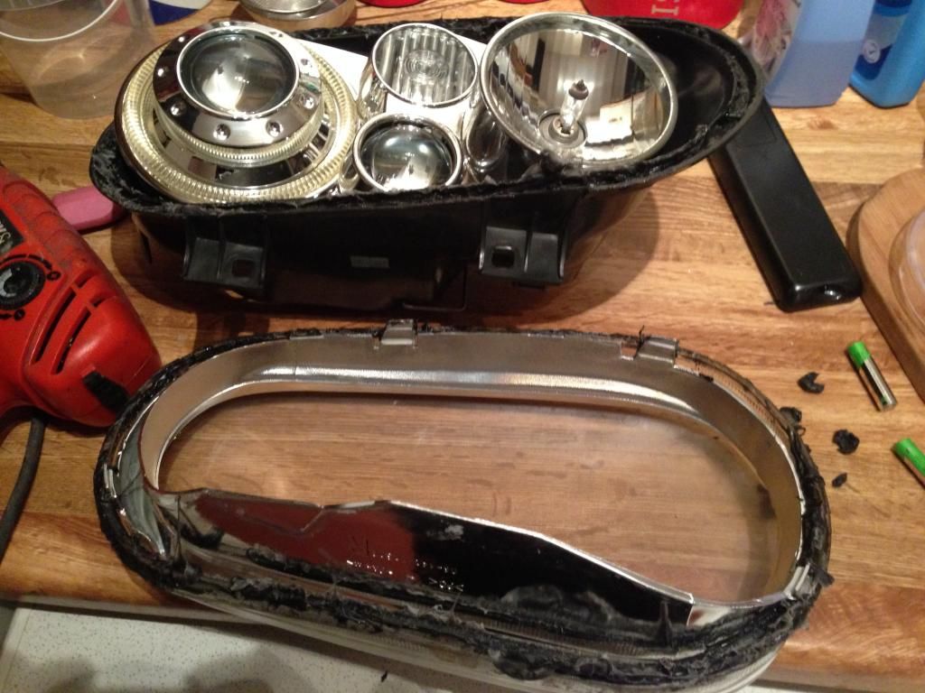

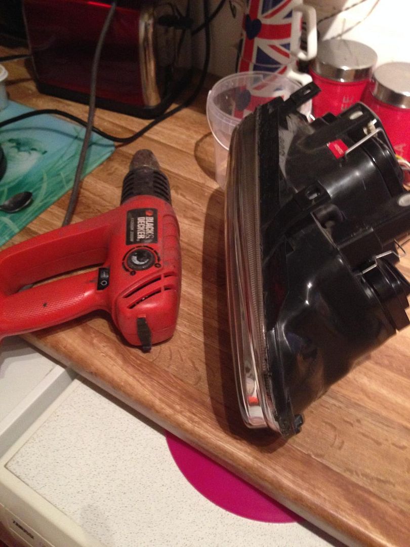

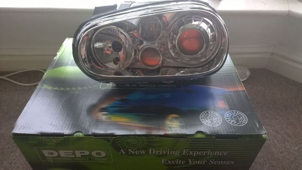

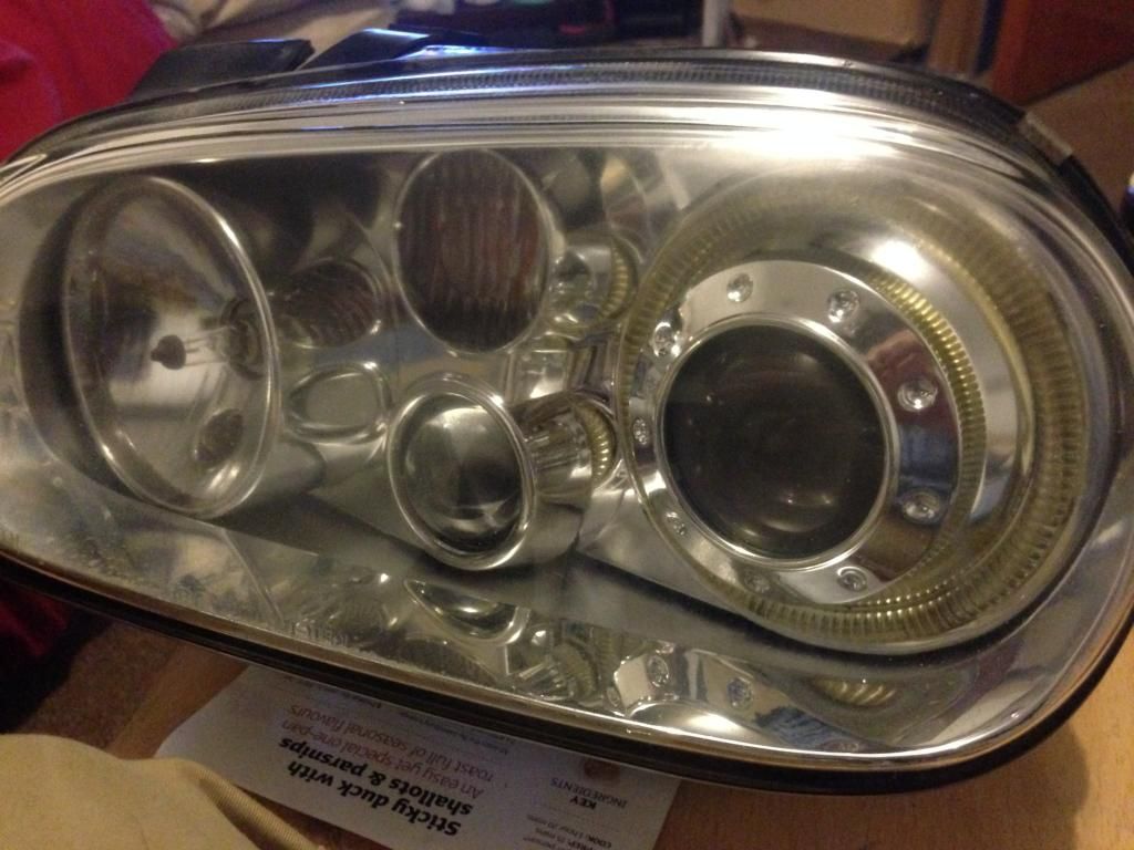

So after having them sit around for a few weeks getting in the way I decided it was time to install my depo projectors.
7674E380-A752-4FF9-AB72-41CEF67BE57A_zps
Sadly they only have one "halo" around the main beam, I'd prefer two but all good things come to those who wait. Picked these up for £40 with wiring harness, motors etc. Lad who had them had bought an estate with them on but weren't to his taste. (Can't see them looking good on a wagon).
Both the units had seen better days, the lenses were misted on the inside, reflectors worn and faded in places :(
I started by stripping out all the bulbs and taking stock of what I had. I decided early on that the halos would need to be LED upgraded to match my current side lights, and until I can sort out a headlight washer system not keen on whacking HIDs in so would be swapping most of my current bulbs over.
The only bulb that didn't want to play was the drivers sidelight, this wouldn't shift for love nor money. Pliers, WD40, brute strength was doing nothing apart from destroying the holder itself.7EECE433-1EBC-43EB-B259-F69D53F5C095_zps I even managed to get my finger through the high beam socket and press on the top of the sidelight, still nothing :(
This left me confused and frustrated for a while, and forced me down a route I hadn't wanted to take!
2241C1F0-480B-4F29-B7F8-5FB9138538DE_zps
After (much swearing, anger and slightly burned fingers)
55FF24DF-FF94-405B-8973-DD2AD26B5C1F_zps
I managed to eventually pull the damn bulb out the front of the unit, and replace it with my LED. Also cleaned up the unit as best as possible, cleaned inside of the lens, wiped over the housings but as I said before they are showing their age a bit. To reattch the lens I jsut heated the glue again with the heat gun and oven and pressed together with the securing clips provided with the lights.
The actual fitting I didn't take any photos of mainly because it was raining, started just as I got the first unit off, but also because we all know how to change the headlights in these things ;)

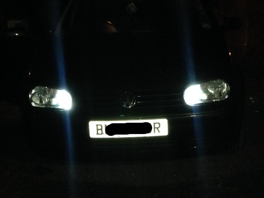

Sadly the halos didn't light up as well as I'd hoped, even after buying the LEDs from Italy recommended here: https://uk-mkivs.net/...sion/?p=1864681 Admittedly I went for the 6000K ones to try and match my current sides but this wasn't to be. I have a feeling the plastic covers for my Halos are somewhat yellowed, and short of pulling the units apart again and trying to find replacement covers I'm not sure how to address this.
Anyway, here are some night shots
5DB4B1D4-3F86-44A2-8C2C-06B3697323BA_zpsB9655357-25C8-4E0F-8BA9-36710751DD67_zps

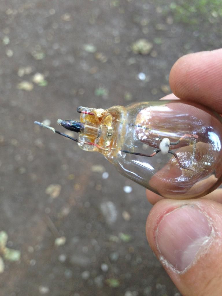

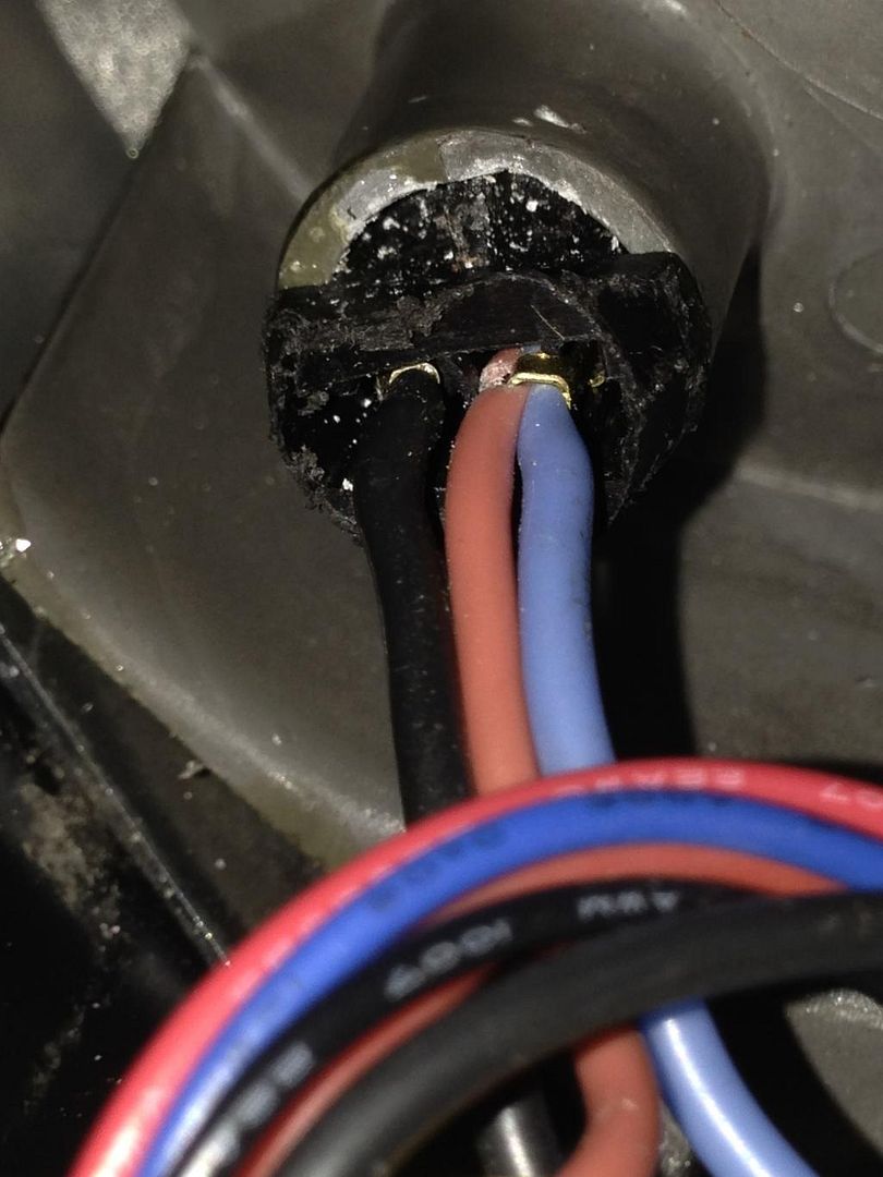

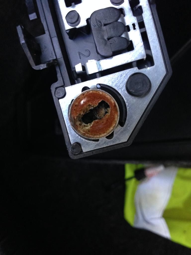

Soooooo quick update, noticed that my rear fog wasn't lighting the dash symbol, quick check later and the fuse was blown, replaced fuse, blew again  :(
Got to thinking that the only recent change was the headlights, so off they came (with the help of new screwdriver set for £7 can't argue, got to love Lidl)
 and gave them a full inspection. It turned out the fog light on the passenger side had been messed with and the wire in the holder was making contact with the holder itself, causing a short. Lucky I'm a lazy, messy kinda guy and still had the original lights in the boot. Swapped over, tested, back to normal service  :Y:

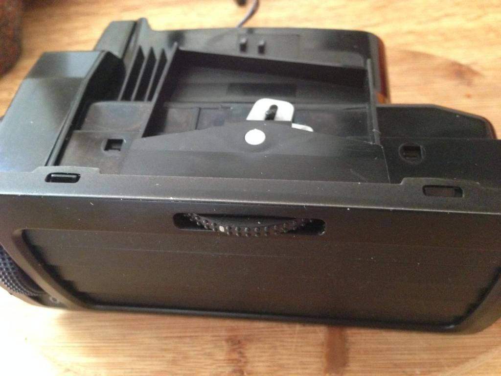

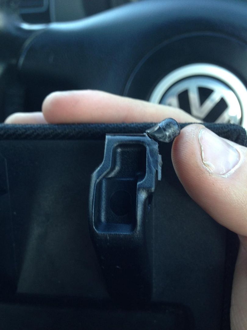

Sadly while removing general rubbish from the interior I noticed the arm rest lid wouldn't open fully. Managed to spot a screw stuck in the hinge but no way of getting it out. Leading to this:
43FD5ACC-5DAB-444C-9808-83E45C107195_zps
Applied locktight to the wound and seeing if its strong enough to be refitted tomorrow, I hope so because off on a jaunt down south to see the family and would miss the comfort of an armrest.

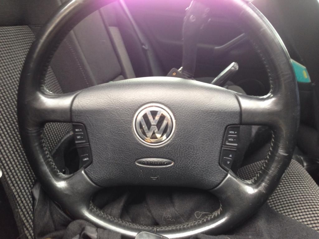

Hi Pepy, saw earlier in your thread you were planning to retro fit a MFSW, have you gathered any parts yet? I've got a minter with the correct stalk and wiring to go with it, PM me if interested.
From:                                                      To:

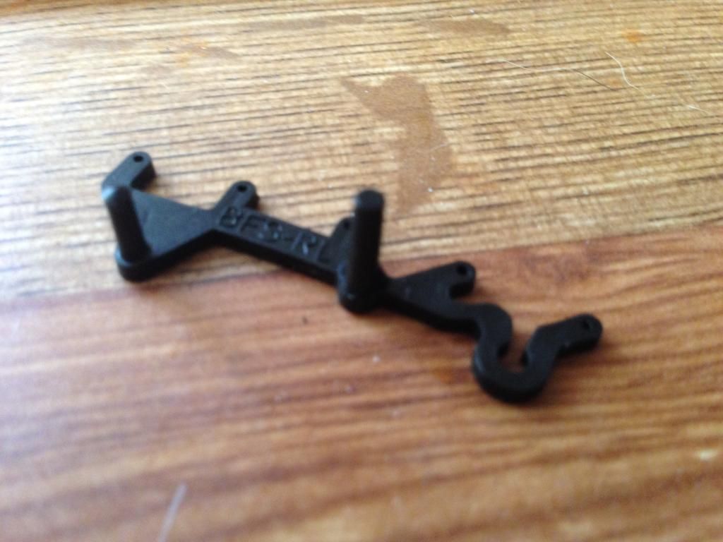

So long story short, one of the slats went in my passenger side vent, and having some time on my hands decided to do a little write up (as a quick google didn't give any results)
After removing your vent (you will know how yours are wired in, be careful you don't damage the connections) you will need something like a jewellers flat-head screw driver or thin blade to undo the clips. I used my trusty penknife  :Y: Sorry for the pictures, was a spur of the moment job so an Iphone was the best I had to hand5109C93B-AFBD-4B0A-9099-7FDFF67AE3A4_zps
Locate the tabs on the top 44744A61-1ADB-47CF-B4E3-F67C3442F0B8_zps
bottom
996D38C8-7CCD-4C1A-AF5B-36962320EA70_zps
and sides of the vent
B2C7395B-5ECE-466B-9C50-679498778DFC_zps
Carefully pop these off, starting with one side, then the top and bottom, then the last side. This way you reduce the stress on the clips as they come off (don't seem the strongest)
Once the faceplate is off you are left with this
88A269DB-27A8-4F37-AFCF-E54285AB2828_zps
You can see the LEDs which illuminate the symbols on the top and bottom of the wheel housing, if you're handy with a soldering iron I'm sure you could change these to a colour of your choice. (See the spoiler for a close up)
Spoiler

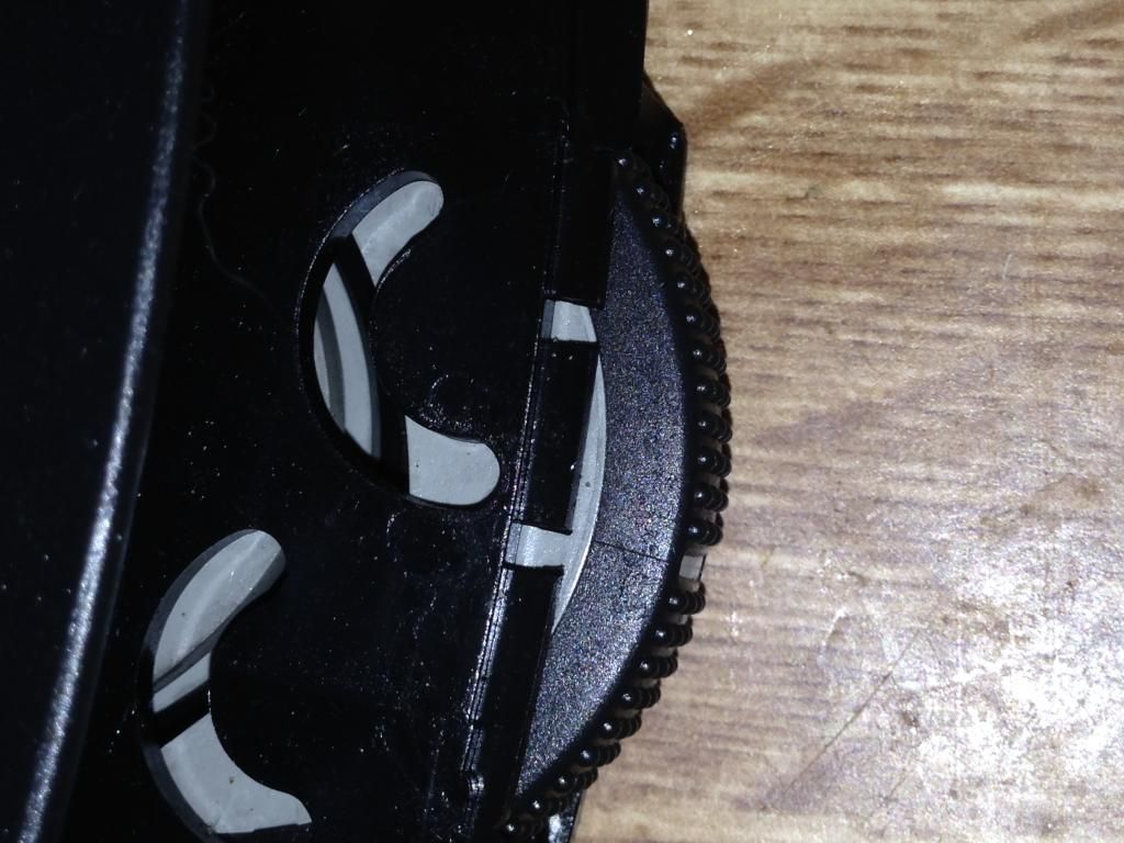

Removing the faceplate the vents popped out for me, and you find yourself faced with a very simple set up. The vents are held between two strips of plastic and are just clipped into it using the little stalks on the end of the vents. On the wheel side you have a little frame which connects the bottom/back of the vents together so they move in one smooth action. Pictured below is the frame in situ and independent of the vent
91993E4D-2DDD-417C-BA3A-43B614998249_zps
4AF7C5DC-B253-4D20-AD13-8017743A518A_zps
At this stage fixing the actual slat is easy, very gently lift the side strip of plastic and pop the stalk of the vent back into the hole. You might find it easier to remove the frame for this, again it just pops off. The "hook" part of the frame is the top, and if you forget which end of the vents is top, its helpfully marked by the top slat being bevelled and having slight ridges on it  ;)
77549257-95A5-4E25-8E40-79E7DEDDA8F7_zps
Once the slat is back in place, reattach the frame starting at the top and work down each slat, this makes it much easier.
Pop the slats back in, locating the pins on the frame into these grooves
1B8A6BF6-649D-49C7-9E77-CD81779EB5DA_zps
and locate the other side using these tabs
20079BD8-9917-423B-8DB3-555F4E0C7072_zps
Test the slats movement before reattaching the faceplate, you will have to hold them at the bottom of the wheel as shown, this is normally done by the faceplate as the slats will edge out slightly if not under pressure (this creates the lock feeling on the wheel)
1A2BA877-150D-4B49-84BD-3A62CBB99073_zps
The hardest part of this was putting the faceplate back on, it takes a fair bit of wiggling to get all the clips back over their tabs. However I now have nice smooth vents again  :D

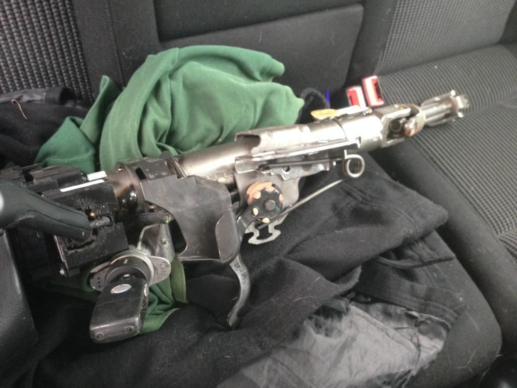

So, new windscreen fitted yesterday, however made quite a find which I collected today
59362FEE-D541-48EC-A14D-47075344DA39_zps
D4E93123-5D89-4066-9370-D6C2CB36A04D_zps
Shes a little battered, in need of some TLC but managed to pick up the wheel, airbag, clock-spring and indicator stalk all for £35. Bit of scrap value with the column as well, so all in all rather pleased. Couple of weeks and the other half will be driving herself so I can take the golf off the road for a few days and install.
Don't suppose anyone has a spare 451 relay knocking around anywhere?  :whistle: Glad spring has sprung and can get to work on the paintwork finally.

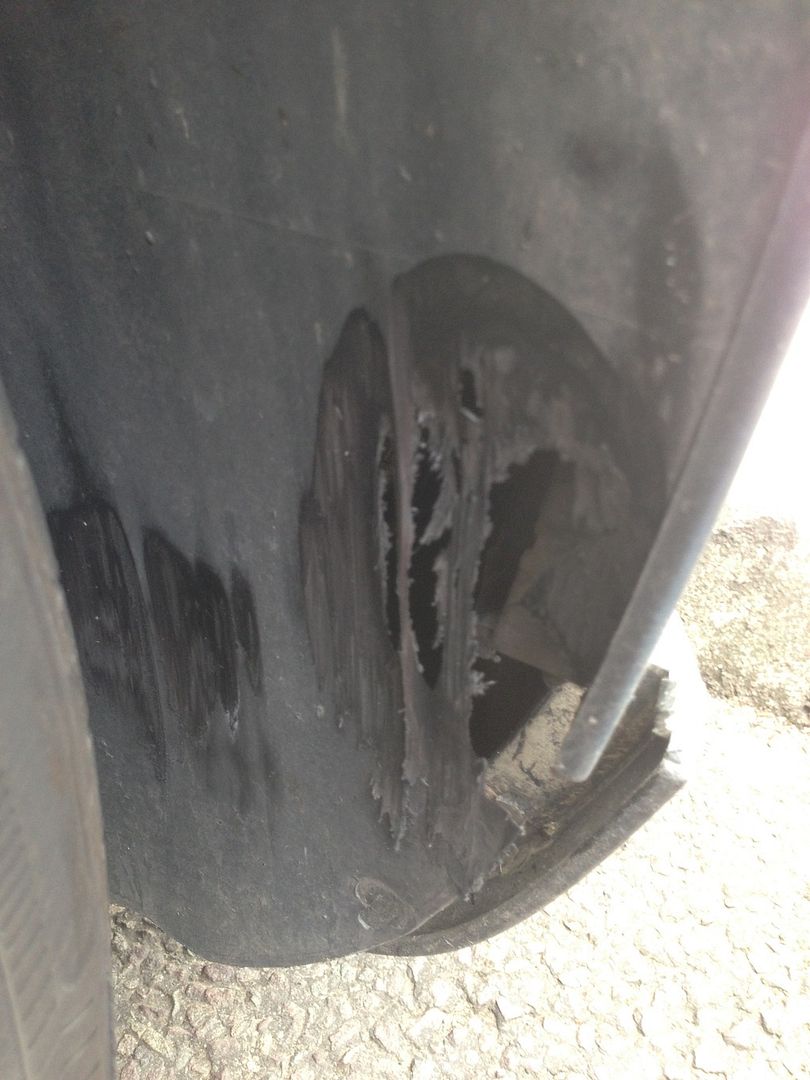

Doing my pre winter clear out of the arches to minimise the chances of rust, and discovered that my drivers wing is rusting  :dash2:  Sadly, its pretty bad, so if anyone has or knows of a drivers wing (rust free) preferably in LC6X let me know  :P
Its scary how much crud builds up though, heres mine 04574E7B-54AA-45ED-A259-0F6164C76E10_zps
