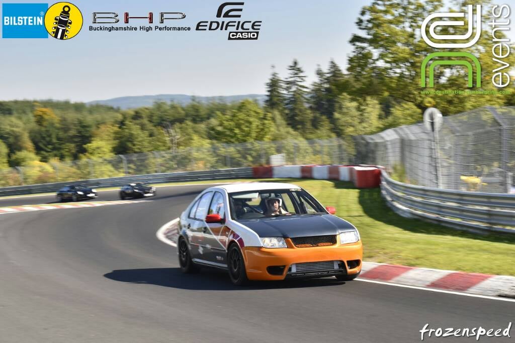

What started off as a wild idea between a few of us on the forum is now edging ever closer to reality.
The brief: Build a track ready MK4 platform car. Car has to be lightweight, safe and able to transport driver and passenger to various venues across the UK and Europe. (It also has to be road legal if we want to drive it on the 'ring)
The people: Harveysduvet, Wilko and myself Tabs
Suppliers who've helped: AutoPS - AmD Essex - SuperPro Bushes - Brakes International - Greenlight Insurance - VWSpeed - Forge Motorsport - Awesome GTI - Revo - Milltek - Autotecnix - K-Mac Caster and Camber Kits - Opie Oils - SFS Performance
The car: Bora Sport 1.8T (Because they handle better :D )
The plan makes use of our collective experience over the past few years of improving the frankly woeful MK4 chassis. A brief run down:
  • Completely strip interior, inc. sport seats, headlining, lower dash, airbags etc.
  • Bolt in cage
  • Lightweight seats
  • Four Point harnesses
  • TT/R32 spec suspension
  • Completely poly bushed
  • Racing spec coilovers
  • 6 pot racing brakes
  • Lightweight 17" alloys
  • Engine tweaks - to be revealed!
With the right amount of power, less weight and agile handling we're confident we can build a reliable, competitive, track car for less than 5K. Inc. price of the car.
We'll be using this topic to keep track of the work being done.
This how she currently looks:
