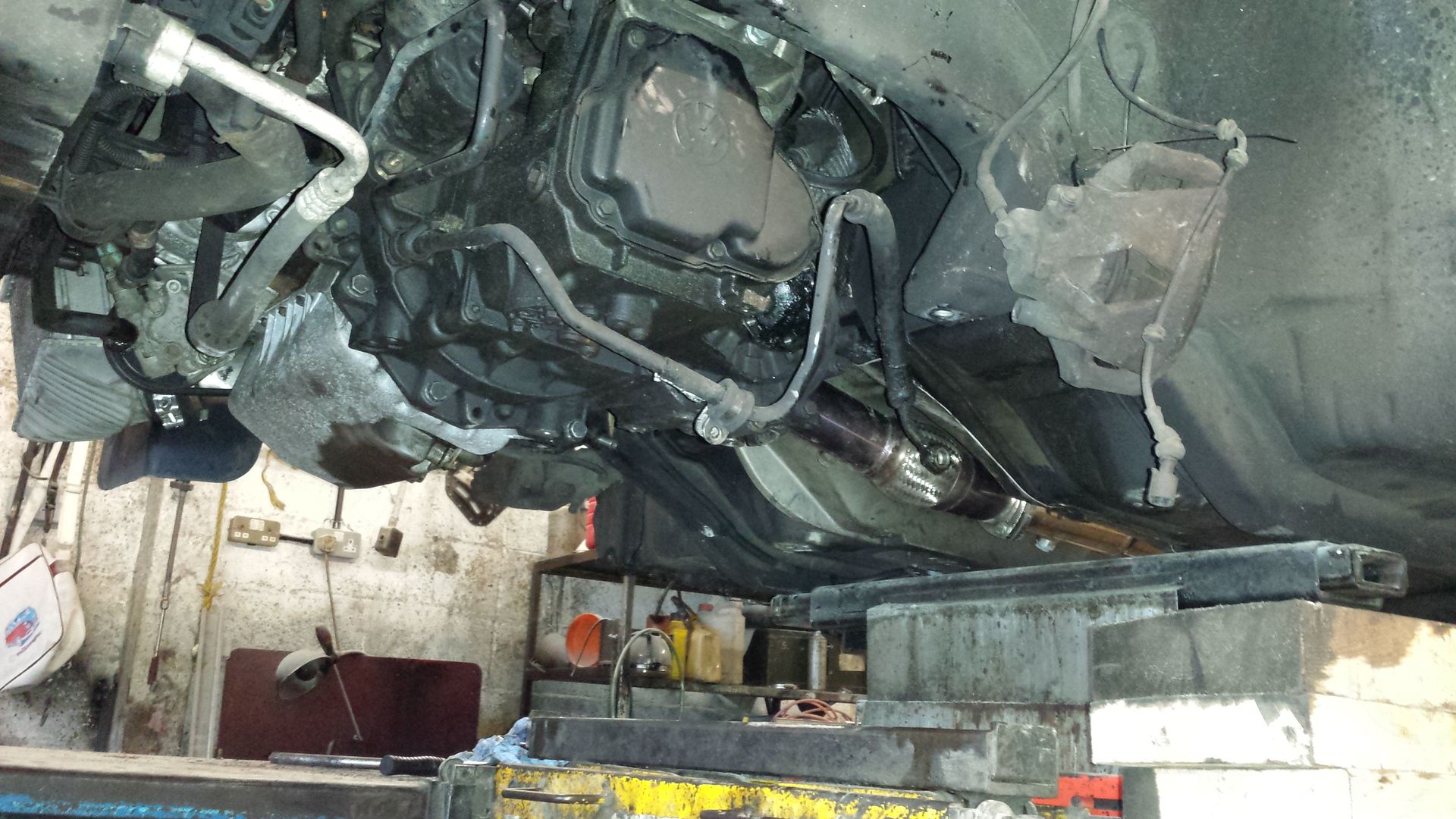

I'm building a budget Track/drag car, with handling/track being the primary focus. But It will probably be doing time at Santa Pod with the VWDRC next year, If things go well.
So what is it? It's an early MK1 Audi A3. Known for the moment simply as 'The A3'. It's a tatty looking S reg (1998) 1.8T and it cost me a whopping £150.
The first port of call for any race car... it went on a diet!
I stripped out the seats and quite a lot of the trim, but the dash, carpets, headlining and boot trim are still fitted... for now.
Then I started crossing off faults one by one, starting with what I through was a knackered gearbox mount... Turns out someone has sheered 2/3 of the gearbox bolts, so it was wobbling around on one loose bolt :o
Drilled through them suckers though and nut/bolted it. Job's a goodun. :Y:
(excuse dem photog skills yo)
general grubby engine shot.
So there you have it, the first instalment of the race car. There is much to do, may parts to buy, and a lot to learn, but basically this will be a budget track toy that I plan to build for £1K.
Stay tuned...

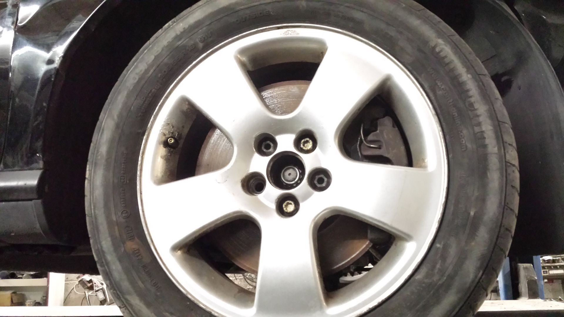

Well I now have a Leon cupra r subframe, control arms, quick rack, H&R front ARB, 312mm front brakes, and hubs. More on the hubs in a second...

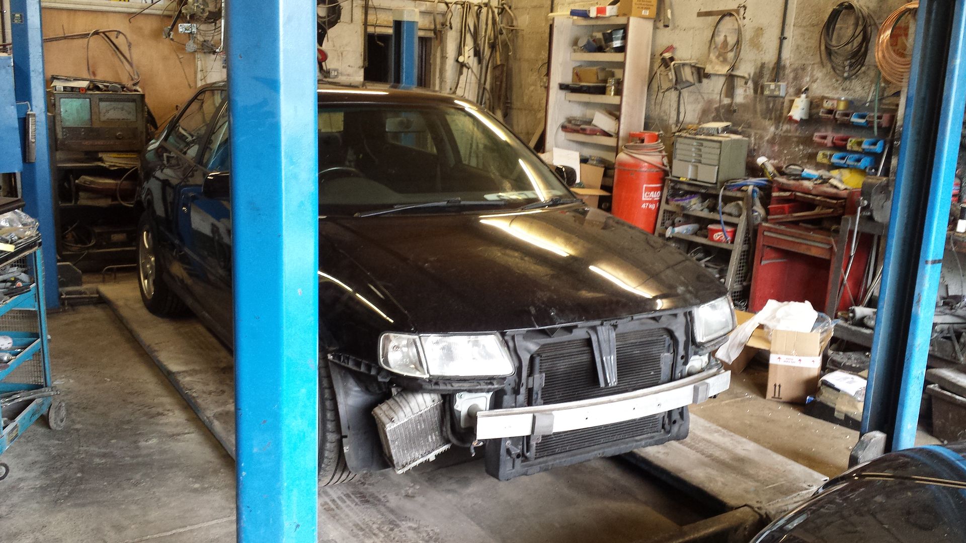

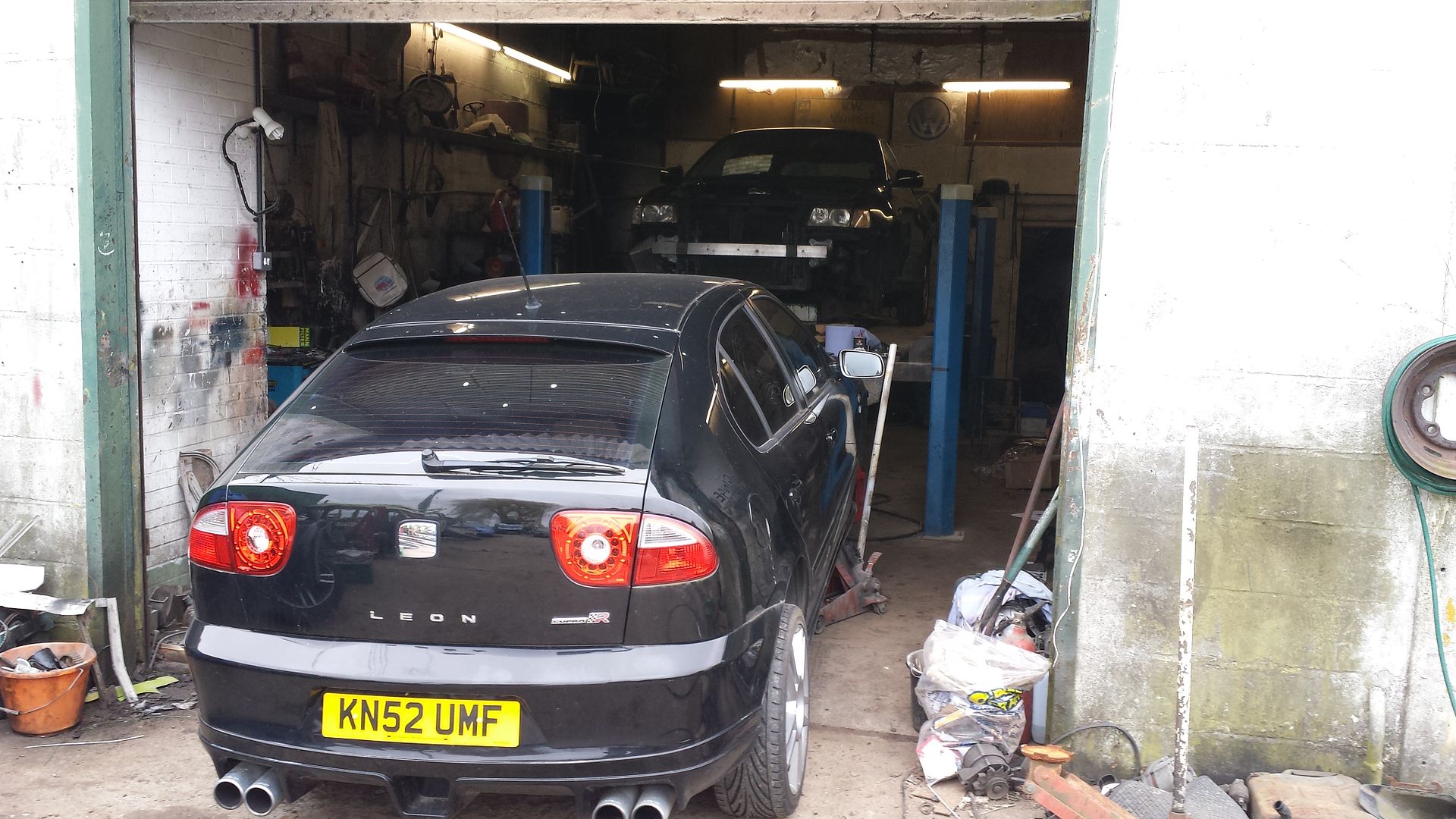

A3 on the ramp:
Big advantage having a girl friend who's dad is a mechanic, with his own workshop, where the fun and games can happen.
Jay's Cupra in place, ready to donate it's organs to a good cause:

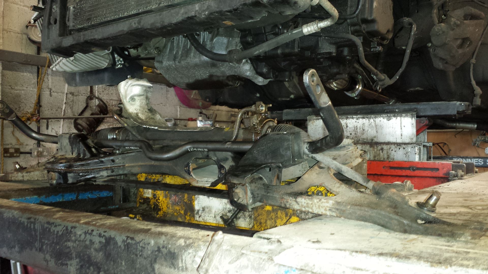

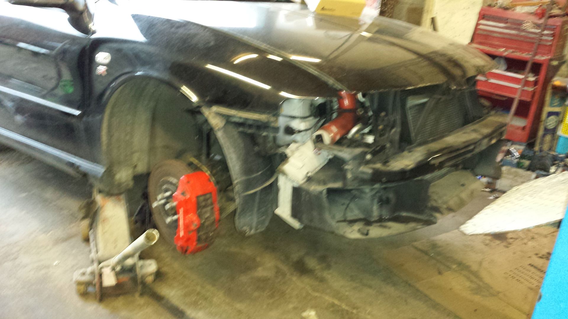

First thing I did was drop the subframe off the A3... Easy job... when you know where all the important bolts are, which I didn't. But it did make it easier second time round when I had to take it off the Cupra.
blury picture of the broken cupra:

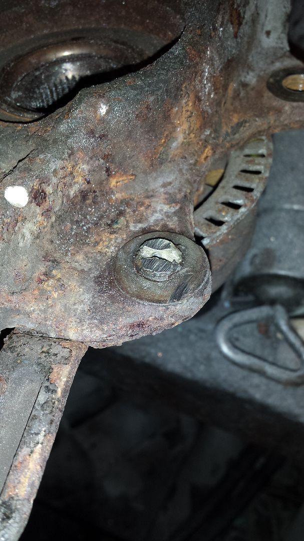

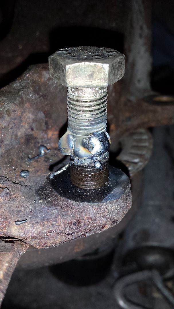

Then while trying to remove the adapters for the big brake kit on the cupra, this happened:
So I practised my welding skills, which are FAR from perfect, but it did help extract the stud.
Tired, defeated and rather peed off, I went for a shower and bed.

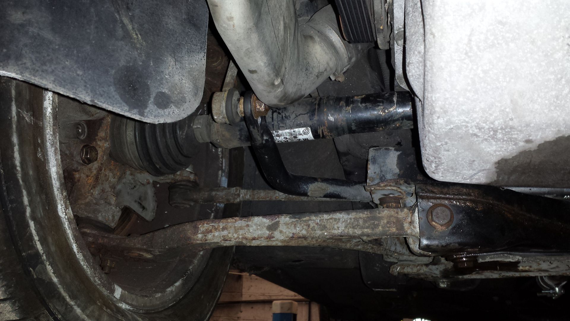

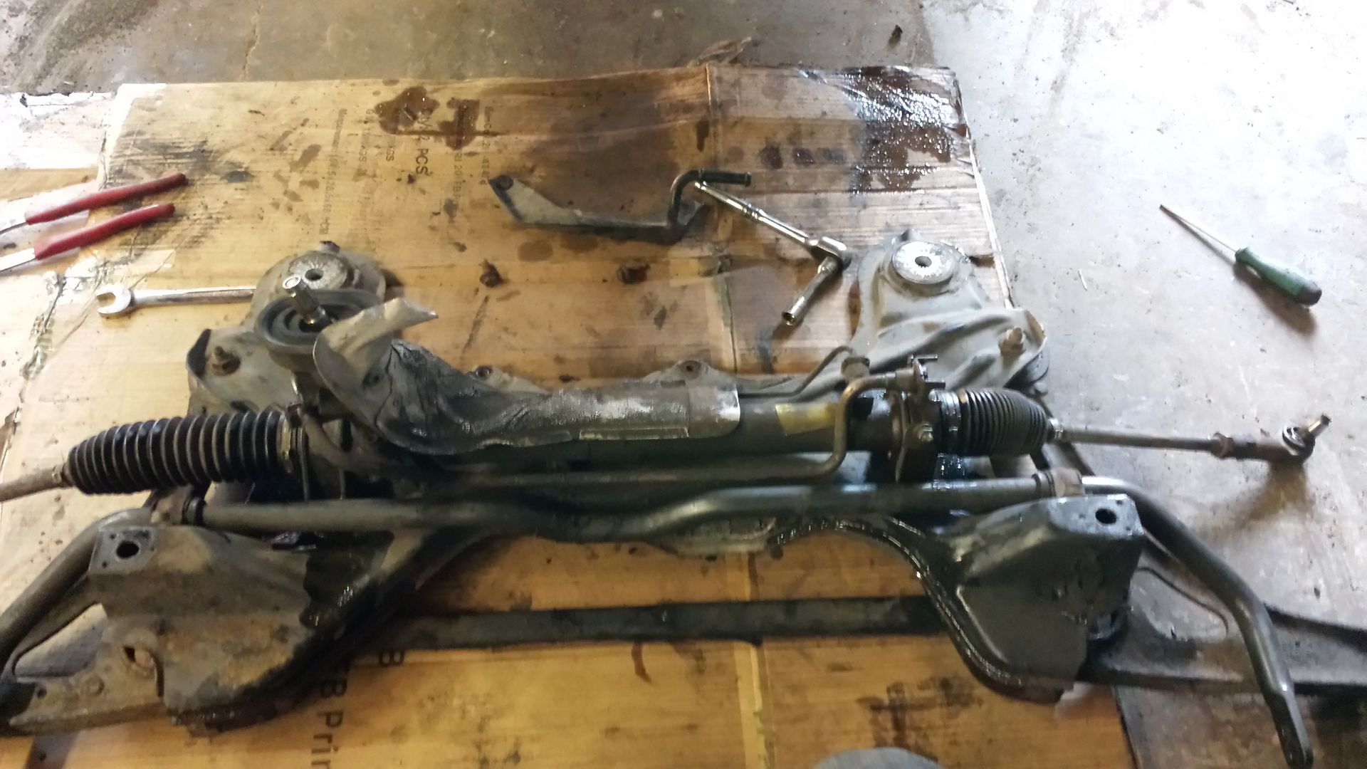

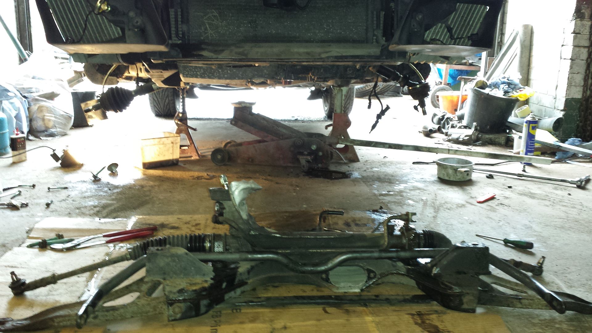

Fresh start in the morning and I started by taking the subframe, and all other related paraphernalia off the cupra:
I then lifted it on to the A3, and started nipping bolts up. At which point Jay turned up again and we continues horsing around with the welder and breaking things. I kept miss-placing my tools, and hitting things with hammers.
LCR subframe:
Note the cut ball joints. Would be fair to say I was starting to regret taking on such a task. Every bolt on the cupra seemed to either strip the head, or start undoing, then bind up completely. I had to cut the ball joints and brake carriers off, which ultimately left me with two buggered track rod ends, and a knackered hub.
But despite the trials and tribulations, We managed to get both cars back with 4 wheels on, so we could free the workshop up for Monday morning, when 'proper' work was going to be done.

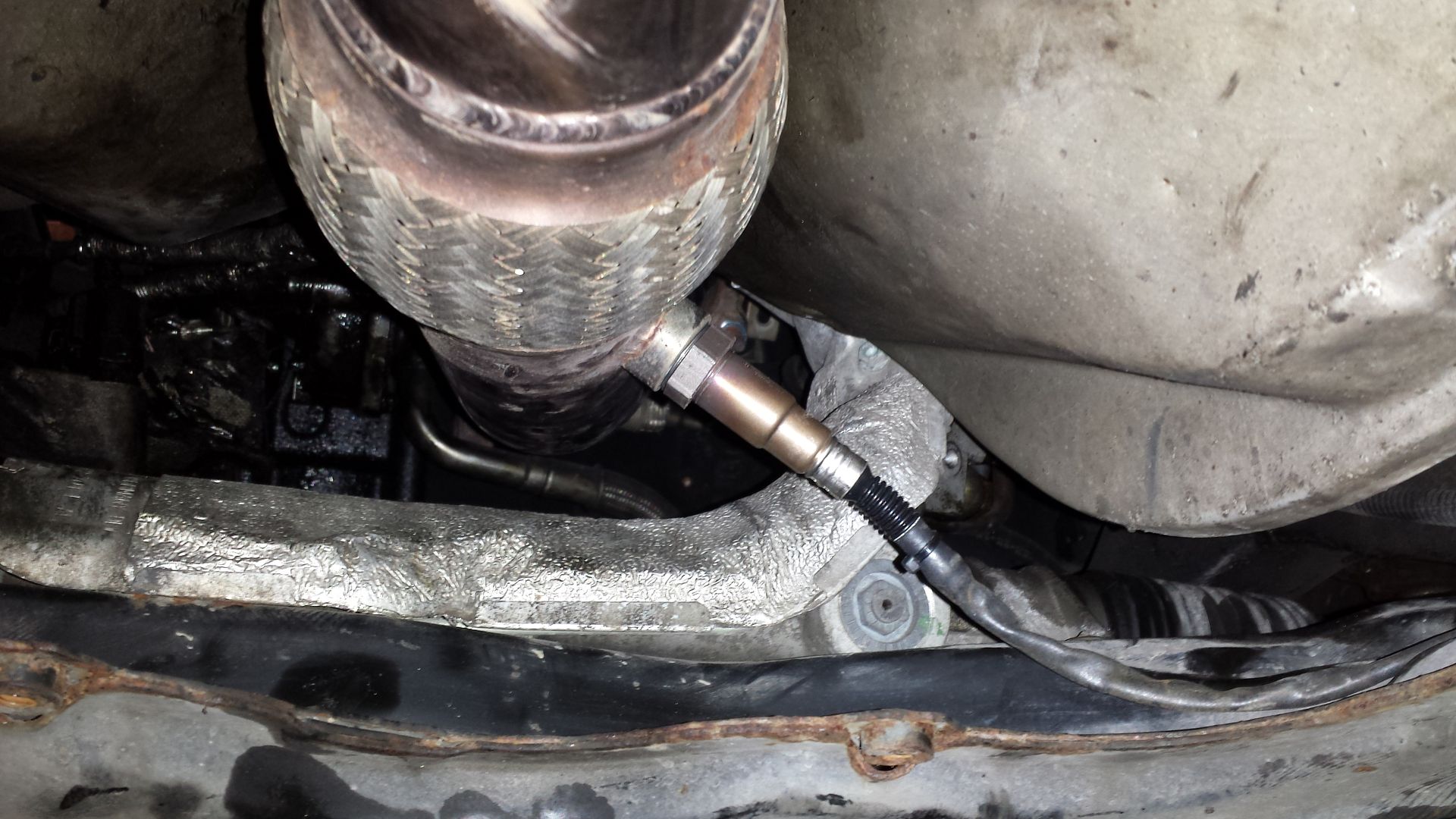

And finally, i gave the car a lambda sensor, which should help it fuel a bit better:

New tie rod ends and balljoint are already on order, as are some new knuckles. Gonna get some bew bearings too and just swap the whole lot over when the coilovers go on.
You have done the right thing adding that lot ..... makes the car handle from shoot to good.
You will need a rear ARB to match that front or you will suffer from understeer still.
I do hope so! Rear beam is getting polly bushed and roll bar'd soon :)

That's a fair amount of work done in a couple of days :Y: It really is well worth the swap, it's a night/day difference
I'm surprised you didn't nab the 4pot callipers while you was at it
6pots, actually! with ECS floating rotors front and back. The thing about a BBK like that is they're way over my budget, you have to run 18" wheels, which means buying 18" track day tyres... expensive! And they wouldn't actually help me all that much on a track!
312mm front + 256mm rears, in a stripped out car like mine should be more than enough i reckon. Decent pads, braided lines and cooling ducts would be the only other brake mods I would consider at this point.

I agree for the most part, the other bonus with using smaller brakes is you are not adding a huge amount of unsprung weight. I'm sure I have read somewhere that 1kg of unsprung is equal to 3kg sprung.
Im off to brands at the end of april so ill let you know how my 312's hold up, I have a feeling that if its a nice dry day they will start to cook though. I think the LCR 4 pots will be the way to go if this is the case as they just fit under 17's which is still a compromise but may be necessary.
If they are fine though ill probably go the other direction and look at lightweight 16's with low profile tyres. which should help unsprung weight and give a bit better acceleration form the overall drop in wheel size
