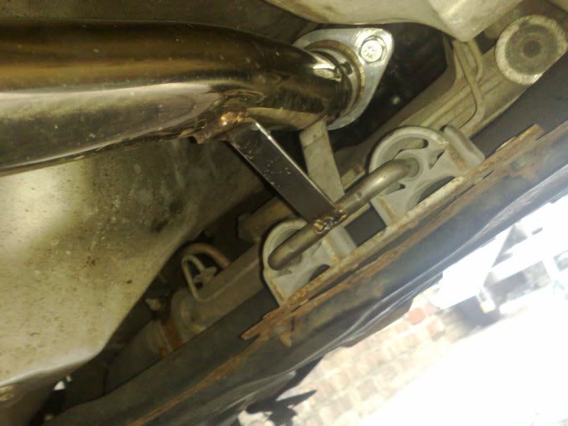

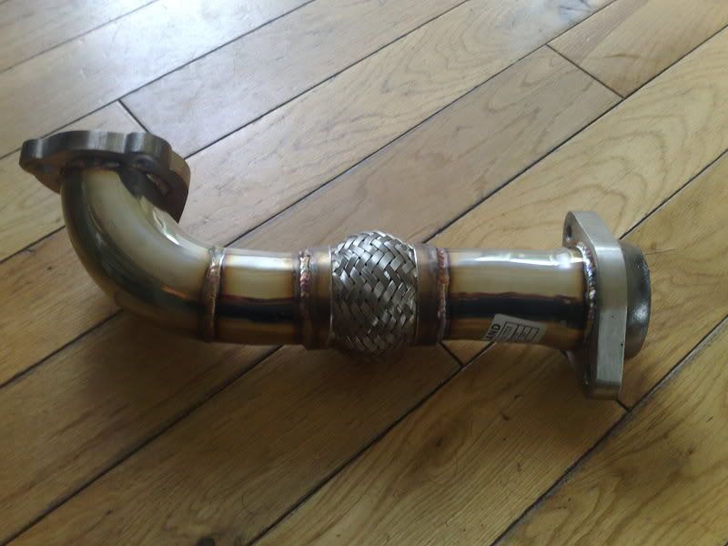

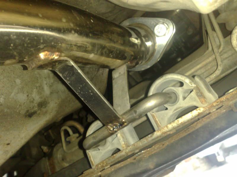

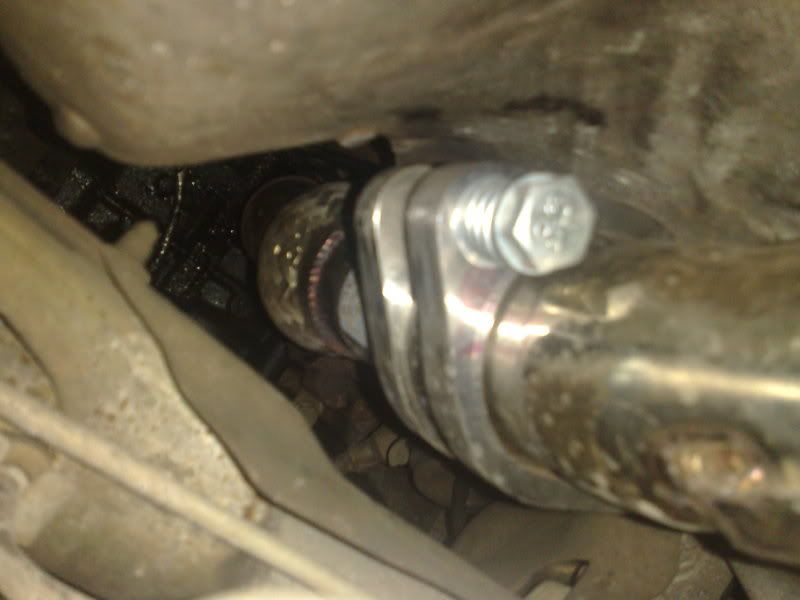

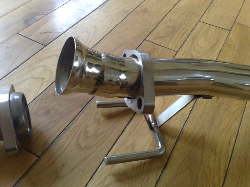

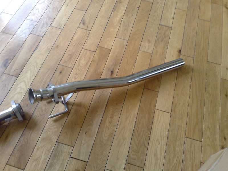

Some pics of my decat which has been on a while now
#34 Stuart1
Stuart1
  • 134 posts
Posted 09 October 2010 - 07:21 AM
car is coming along nicely mate,
where did you get the decat from? and does it fit to a standard system?
cheers Stuart...I got the decat from Hottuning on ebay. They are in belgium. It fits directly to the existing exhaust with no problems.

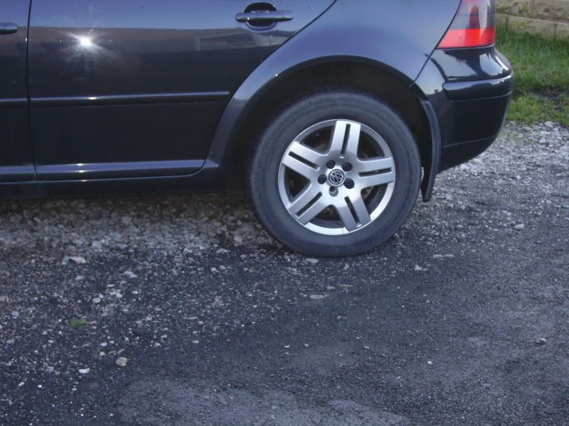

just looking through some old phone downloads and came accross these from when i first got the car in 2005
15 inch stock wheels V 18 inch R32 O.Z. Arristo's [I]
I can't find any listing for the De-cat. What ID is the de-cat, has it made much difference and did you buy it recently??

Posted 17 October 2010 - 01:12 PM
Ive had my Decat on for about 2 years the diameter is OD 55mm which is standard...HTH mate[C]
Edit...turbo spools up quicker and gives a nice whirring sound at low revs

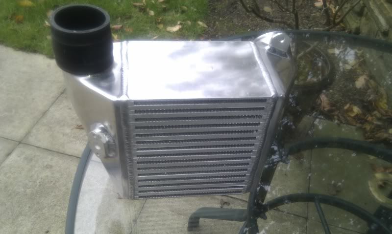

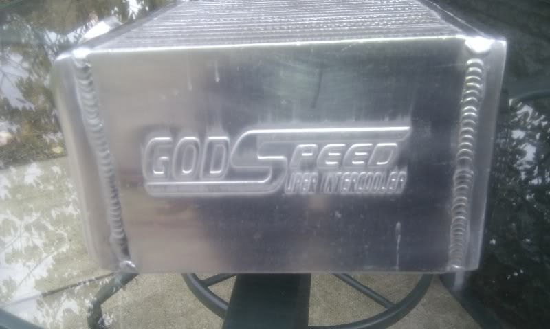

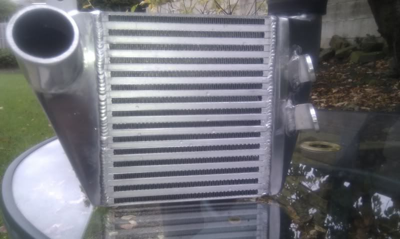

Found a really cheap SMIC on the Bay...been researching for a while.
just ordered the above and will fit it along with a 1.8t pancake pipe. Just need to sort some silicone couplers.

 Hi mate, looking good, what make is the smic?
craig

dont know yet till it comes...probably some cheaply manufactured stuff but size wise it looks good. It has got to be an improvement as its quite a bit bigger. watch this space [C]

intercooler looks nice!

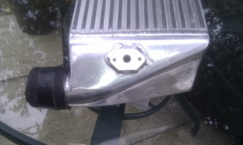

This arrived this morning next day delivery. Seems very well built inlet and outlet are 60mm.

will do mate not sure if I can get the pipes to do it this weekend. Good job I didnt order connectors on the sellers say so of the inlet and outlet been 2 inch as they are 60mm. Im sure the 57mm top hose to EGR will stretch on. Ive got a 1.8t pancake pipe (60mm end onto intercooler) I just need to adapt the other end  onto the red hose from the turbo behind the front wheel.
i'm sure the 57mm elbow will fit fine, the SFS adaptor was 62mm and i made the 57mm elbow fit it.
Very interested in how you adapt the red turbo hose though, as i've never looked at mine so no idea what would be involved

Right its on...Fits like a glove! I have kept the PD130 pancake on for now as I couldnt get the required adaptor for the 1.8t pancake pipe. The intercooler mounts all lined up perfectly, you do need to use the spacers off the old rubber insulated cooler mounts. Just take the metal spacers off and use them as packers. there was a very slight problem mounting the MAP sensor as the holes did not line up 100%. it was a gnats c0ck out. To get round the problem I took the 2 metal bushes out of the sensor holes and it all lined up and perfect. I took the SFS adaptor from the EGR replacement pipe and used it in the end of the pancake pipe. I had a 60mm coupler that came with my 1.8t pancake, this coupled the intercooler inlet to the sfs pancake adaptor. The outlet on the Intercooler is 60mm and I managed to get my 57mm bend straight on this coupled up to my EGR replacement pipe. Pics to come shortly.
Went for a test drive,  got the engine up to temp and gave it some beans all I can say is wow!!!!!!!!! what a difference[:o] Picks up really well, hardly any lag and just seems to rev so much cleaner[:D]

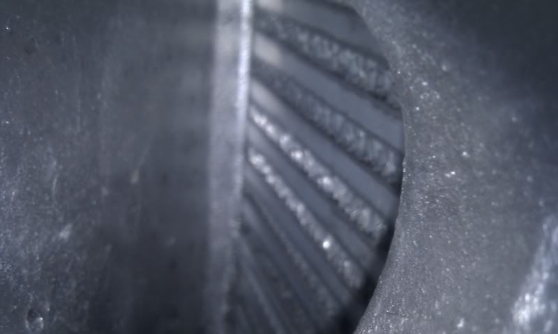

130pd pancake pipe...complete with notoriously poor VW design clip system
1.8t pancake pipe (top) has 55mm inlet and 60mm outlet 130pd pipe has bayonet fittings
SFS alloy adaptor to 60mm hose spiggot
SFS alloy adaptor stuck in end of pancake pipe and connected to the IC with 1.8t 60mm coupler
http://img.photobucket.com/albums/v146/madman3/IMAG0800.jpg
view through vent...snorkel not fitted but should go back on with some cutting
http://img.photobucket.com/albums/v146/madman3/IMAG0801.jpg
