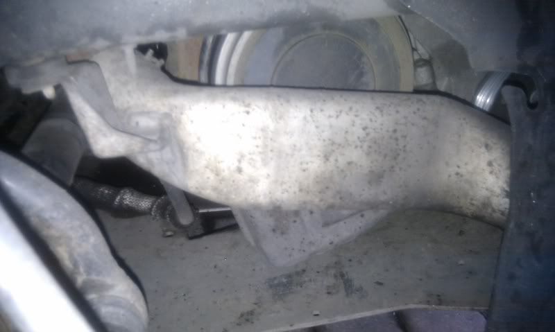

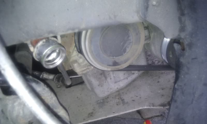

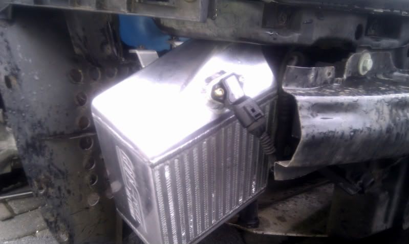

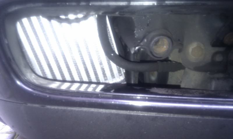

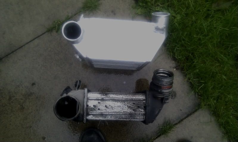

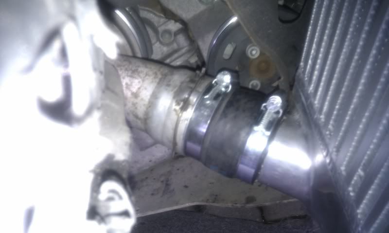

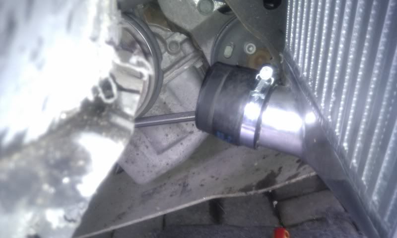

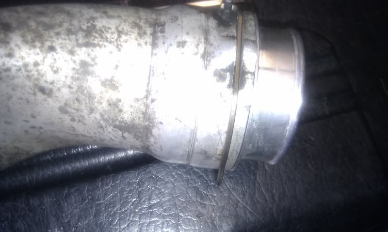

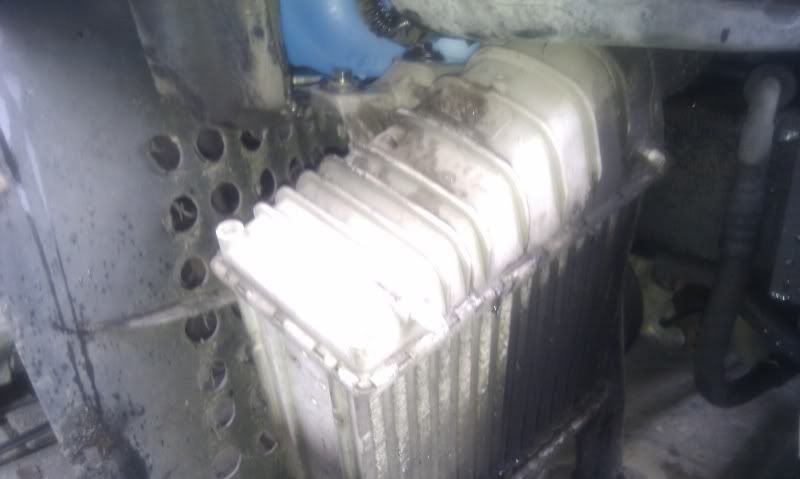

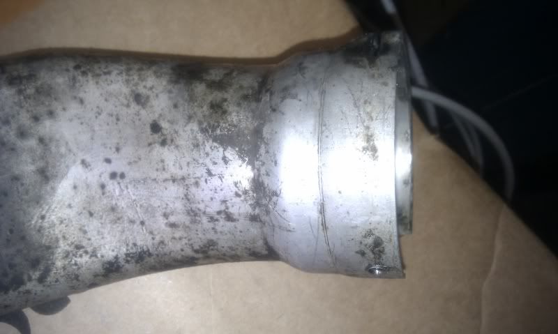

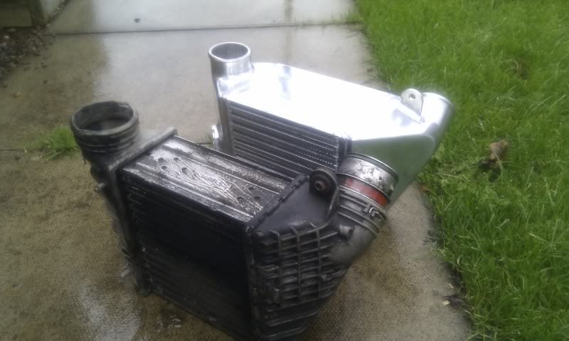

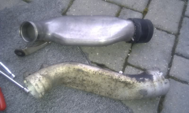

well the silicone hoses arrived this morning with the postman. So I jumped straight in and got the new pancake pipe fitted. First I removed the PD130 pancake
Pd130 to intercooler with 60mm coupler over SFS VW bayonet adaptor
The 57mm SFS connector in the end of the PD130 pancake to use intercooler with stock setup
Pancake pipe bolts up to existing mounting point on chassis and lines up pretty well

how does that fit to the standard red turbo pipe mate? i thought it had one of those silly VW bayonet connectors aswell?
looking very nice by the way, definately giving me ideasStick out tongue
Thanks
I used a 51mm coupler on the end of the pancake pipe and the bayonet connector on the red turbo pipe drops in and tightens up. I did squash the bayonet bits flat with a G clamp to make it more pipe shaped. I will help you empty your wallet mate[:D]
