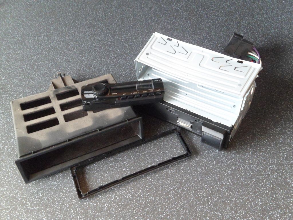

Another small update....

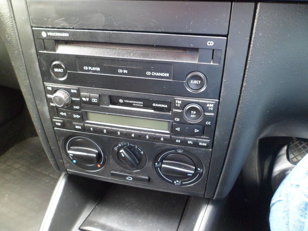

Factory Gamma head unit/cd player installed this morning.
Ok, fairly padestrian, we all know what they look like, none the less it represents an upgrade in spec (The car originally came a simple Beta tape player) A fairly decent improvement in terms of sound quality and also aesthetics :) They cost me the princely sum of £10 from a breaker car locally, and with a code provided gratis from my friendly VW parts guy it was easy to get up and running.
Nasty aftermarket head units are one of my pet hates, the one fitted to the car when I bought it was a particularly tacky  'light up like a christmas tree in Las Vegas' styled example. Glad to be shot of it...

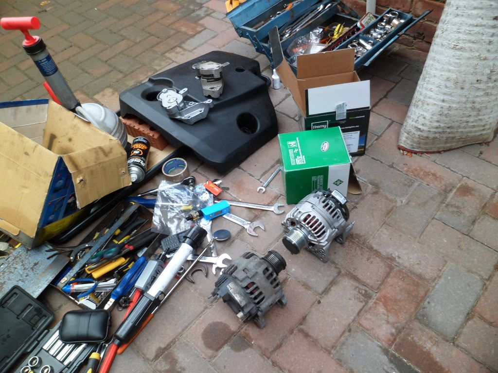

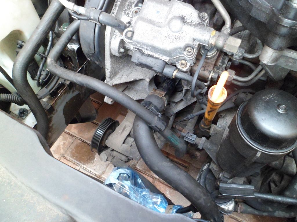

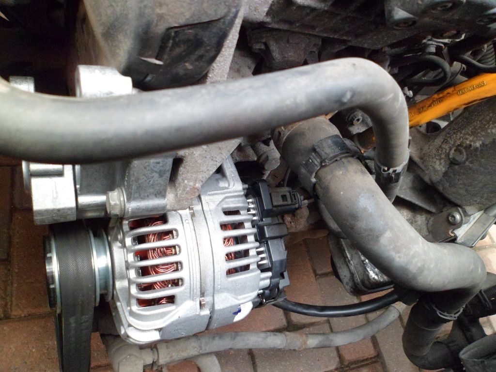

After a weeks worth of chirping/squeaking sounds it became clear that my alternator had seen better days! The issues were compounded by the fact the alternator clutch pulley was locked both ways and the tensioner had all but given up the ghost :ph34r:
Fortunately alternator removal is nice and easy on the SDI models with loads of room, pulling the old unit out was simple...
After a trip to Eurocarparts and the scene was set, a new INA tensioner and Delco Remy alternator ready to be fitted...
A couple hours working at a relaxed pace and job jobbed :)
I'm pleased to report that all's now well. The SDI lumps are noisy/agricultural at the best of times, but the chirping and belt soundtrack had to stop! Normal service has been resumed and the car can now return to 'business as usual.' The original Valeo alternator was a lowly 70A item where-as the relacement boasts a mighty 90A representing an upgrade in charging power  ^_^

is the sdi not a pd engine? That looks like a ve fuel pump. For some reason I thought they were pds unless there were different versions. What sort of economy are you seeing from it?
#6 RandomPrecision
RandomPrecision
  • 305 posts
  • Durham
  • Golf IV SDI 1.9 AQM 68PS
Posted 10 June 2017 - 10:26 PM
SDI's are VAG's normally aspirated (No turbo) diesel option, they use the Bosch VP37 pump IIRC.
To quote VW's marketing bumf from the time "The SDI engine is generally utilised in applications where reliability and fuel economy are of primary concern." Slow and agricultural (As mentioned) but uncomplicated and easy to maintain is probably the best way to sum them up.
RE economy, thus far the car seems to manage a reliable 55 mpg+ with mostly urban driving, I'd imagine mid 60's on a long motorway run although I'm yet to put that to the test TBH.

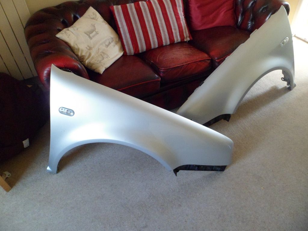

New wings this weekend for Project Slow :) The old ones had rotted out like so many do, largely due to the daft bits of foam VW saw fit to put behind them as new. Having found a pair of LA7W items in pristine nick locally (£15 each, I don't think the seller realised what a rarity he had stumbled upon) the scene was set.
New rust free front wings ready to be fitted.

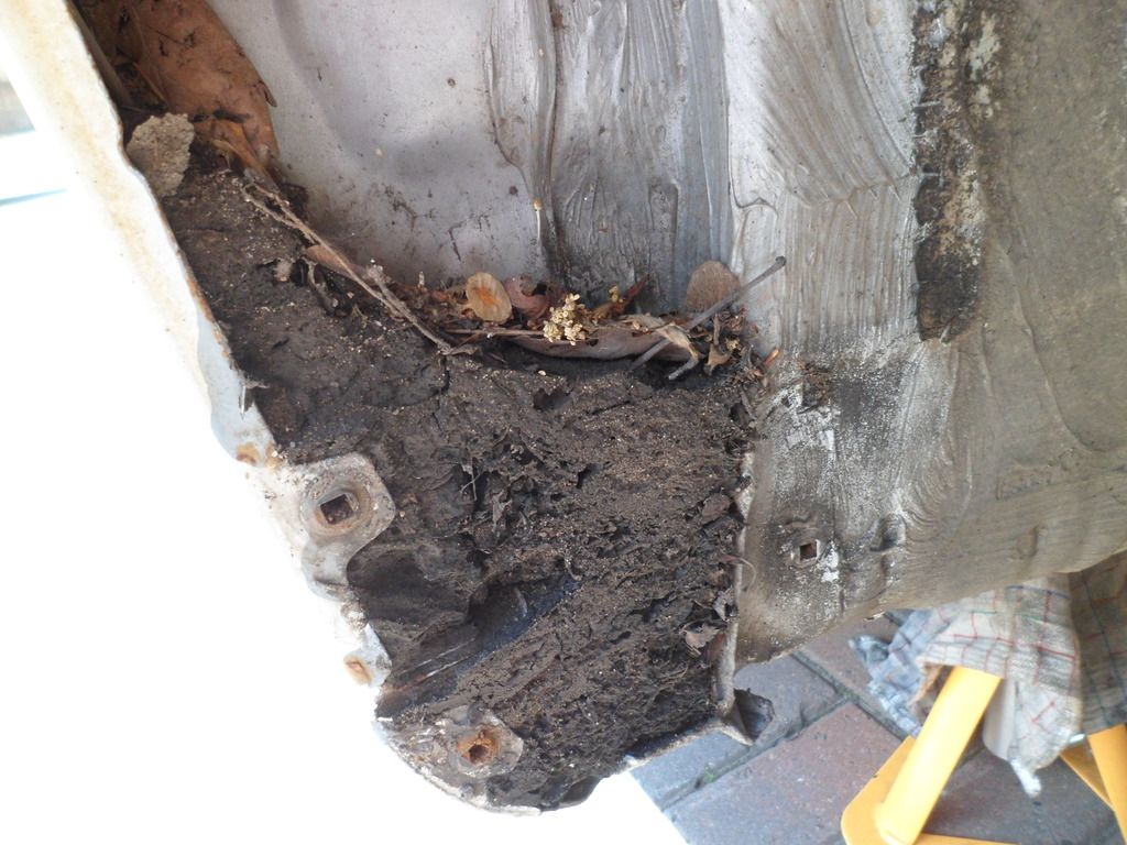

Getting started and first things first, the bumper, rusty wings and arch liners were stripped off to reveal this....
Every car I've ever pullled to bits, irrespective of manufacturer has looked like this, about 2 kg of soil and road grit, pull your arch liners and have a look people ;)
All was washed down with a 1/10 solution of Aldi's own brand APC, regular car shampoo just won't cut jobs like this IME...
After cleaning a four part process was adopted for any corroded bodywork revealed having removed the bumper and wings. First a going over with a rotary tool with various sanding wheels/wire brushes, follwed by Bilthamber's Hydrate80 rust converter, then paint, then Dynax UB underseal (Another Bilthamber product) spread over the high stress areas.
Dynax UB was also spread liberally around the inner arch area of the new wings to protect agains future issues...
New wings fitted and job jobbed ^_^  Im amazed at how good the colour match on the new wings was, particularly given it's a silver car (Usually one of the toughest colours for matching)
And closer to show the match/condition of the new panels...
Overall I'm really pleased, opting for an SDI on the basis of reliability/simplicity is futile if corrosion ends play before mechanical issues do. This represents another rough edge knocked off and also another step towards 'futureproofing' the trusty oil burner for years to come.

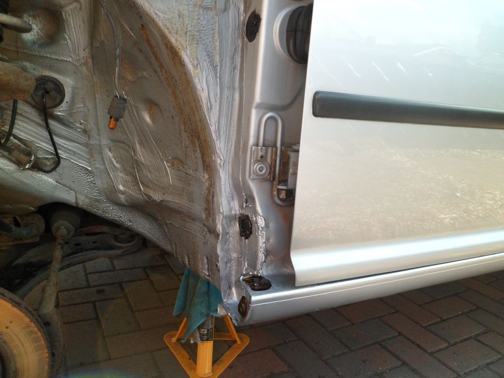

After spotting what looked to be a tiny spot of corrosion at the bottom to the rear arch/sill area on either side of the car I decided that the nettle had to be grasped and the issue neeed to be nipped in the bud sooner rather than later.
The products...
35009255753_2a0beb2287_b.jpgSAM_5517 by
First part of the job was stripping back damaged factory stonechip. As is often the case the area effected by corrosion is usually much greater than expected, here's a shot mid-way through the stripping back of the damaged OE paint...
35649825542_d8ce070a06_b.jpgSAM_5477 by
Any rust found was taken back to good metal using a rotary tool/drill with various wire wheel and sanding drums and given several coats of BiltHamber's Hydrate80. I've used this stuff on various projects over the years, I find it's very effective at killing/converting any traces of corrosion providing a good surface for primer/paint. When applied initially it starts out life as a milky blue colour...
35778561186_8bb1035298_b.jpgSAM_5478 by
And as the chemical reaction takes place the product forms a black/stable compound...

Hydrate80 is ready for overcoating after 24 hours, in the meantime I got busy with another BiltHamber product, this time their Dynax UB underseal. Again, I've found this to be really good stuff, outperforming Waxoyl or Dinitrol products by a mile IME. UB was applied to the inside rear arch area and also the inner edge of the sill rails...
35687007001_04d97fec5e_b.jpgSAM_5482 by
Killing time at this stage, I washed down the arch liners with APC...
35819216455_cba56f460c_b.jpgSAM_5472 by
Fast forward 24 hours and it was time to piant :) A couple of coats of etch primer first...
[url=https://flic.kr/p/WvCFBd]35778601126_24beeac360_b.jpg[url=https://flic.kr/p/WvCFBd]SAM_5508 by [url=https://www.flickr.com/photos/[email protected]/]
Followed by five coats of Refelx Silver, geting progressively heavier towards the last coat. Halford's off the shelf aerosols proved to be a very good colour match...
[url=https://flic.kr/p/Wjgc4L]35649926302_a346f2303a_b.jpg[url=https://flic.kr/p/Wjgc4L]SAM_5538 by [url=https://www.flickr.com/photos/[email protected]/]
Wheels back on down from the stands. The car will be left on the drive for a few days before being used to give the paint a chance to properly harden off.
[url=https://flic.kr/p/WnxAWV]35687077921_7188971c8c_b.jpg[url=https://flic.kr/p/WnxAWV]SAM_5531 by [url=https://www.flickr.c.../[email protected]/]
All done and job jobbed. Time for a beer :)
