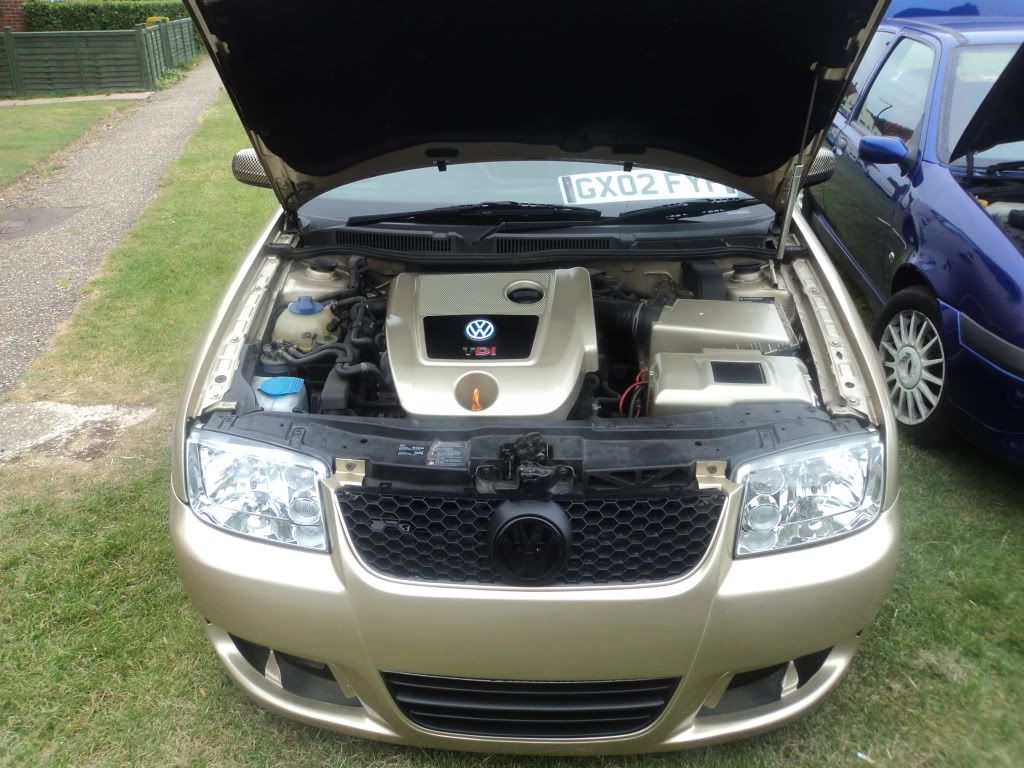

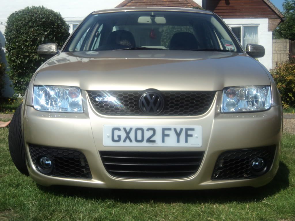

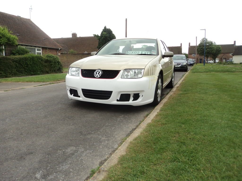

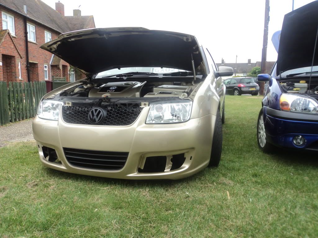

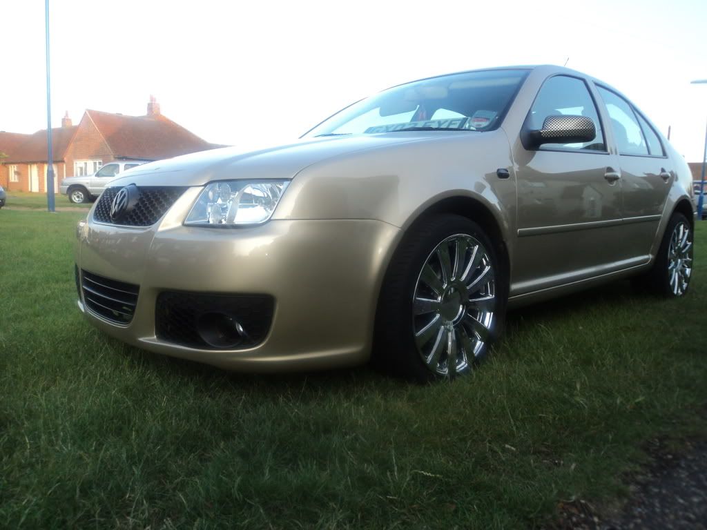

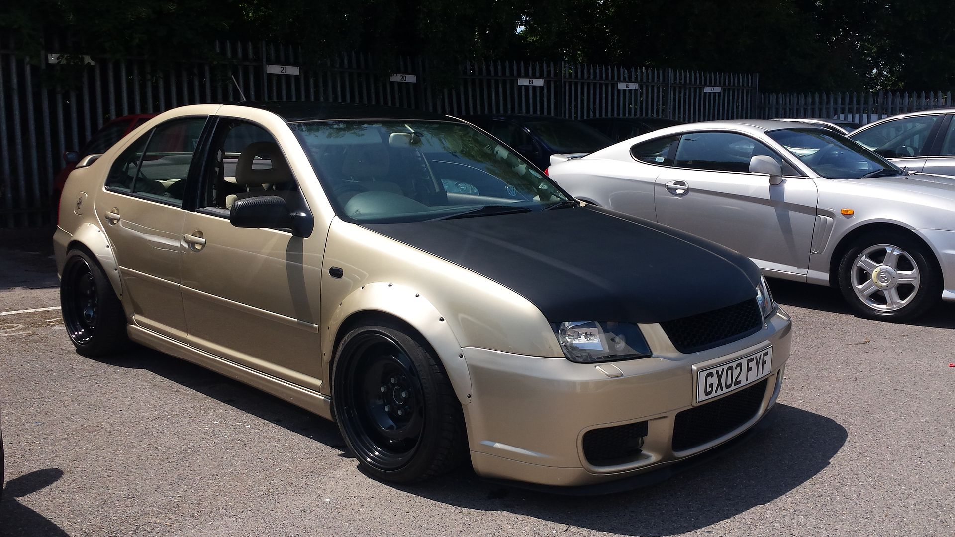

my R-line bora build
how it looks to date
current modifications
Engine + (bay):
upgrade turbo from 150pd
front mount intercooler + piping
EGR delete
panel air filter
uprated clutch + single mass flywheel
straight through exhaust + decat
custom re-map estimated 200bhp 310 ft-lb
battery relocated to boot
screenwash bottle relocated to boot
power steering res relocated
tucked/shaved wiring
A/C deleted
engine spacers
various painted engine parts
poly engine mounts
Bmw fuel cooler
Suspension + running gear:
Ap coilovers
uprated anti roll bars front and rear
upgraded subframe
upgraded wishbones
upgraded hub assembly
custom upgraded rear axel
fully polybushed (every bush)
solid alloy subframe mounts
312mm front brake upgrade
256mm rear brake upgrade
upper and lower front strutbraces
R32 quick rack (steering rack)
steel belly pan
rear camber shims
20mm rear spacers
10mm front spacers
wheel stud conversion
Banded T5 steels
Exterior + body:
genuine R-line front bumper + grills
genuine R-line rear bumper
honey combe grill
anniversary side skirts
Oettinger boot spoiler
cupra R chin spoiler

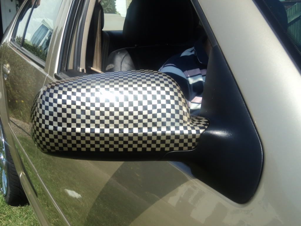

painted mirrors
black badges
custom headlights
tinted rear lights
tinted side indicaters
vinyl wraped roof + b pillars
pressed plated
Black boser bonnet
Arch extensions
interior:
boost gauge + pod
aftermarket head unit
custom door cards + speakers
amp and subwoofer in boot
interior retrim (camo)
infloor lighting
net optic brushed alloy trims
car came originaly fitted with
factory parkins sensor, cruise control, 6 disk cd changer, centre arm rest and all the usual
had 52,000 on clock paid £2500

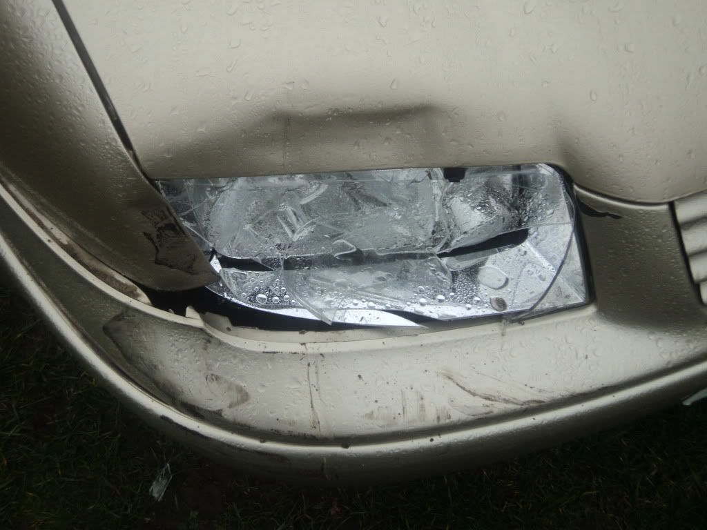

bad start my neghbore
hit my car the other night aparently not drunk
well least it gave me some insentive whilst it was in the body shop

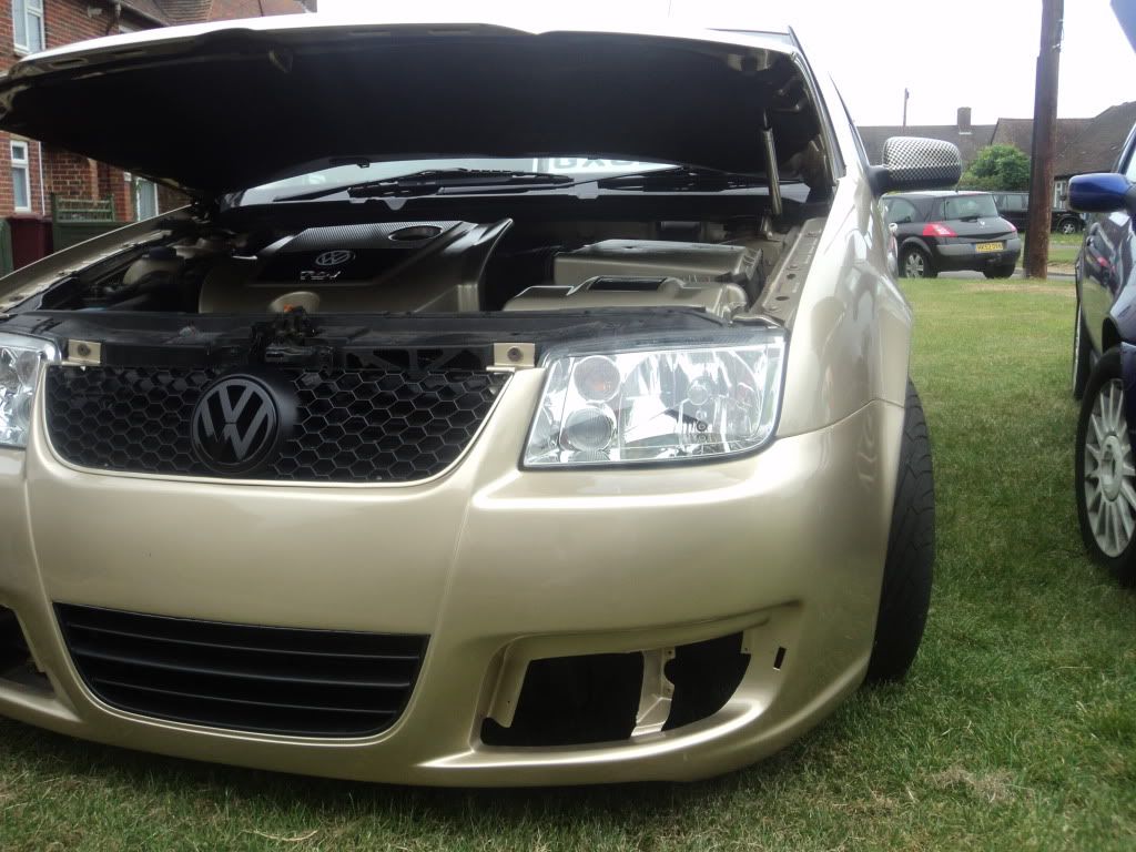

back from the body shop just waiting to get the last grills and fogs

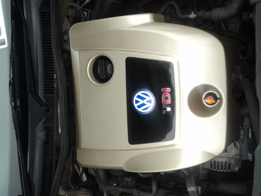

then thought i wold colour code the engine covers
got my new wheels now also withe last grills and fogs fitted and working
waing on my boot install to come back from the upholstery place at moment then can put some more pics on
oo just remembered iv got a sneeky pic of install befor it went for upholstery
http://i1211.photobu...-10_1137031.jpg
rearly need some r32 side skirts
wat u think so far

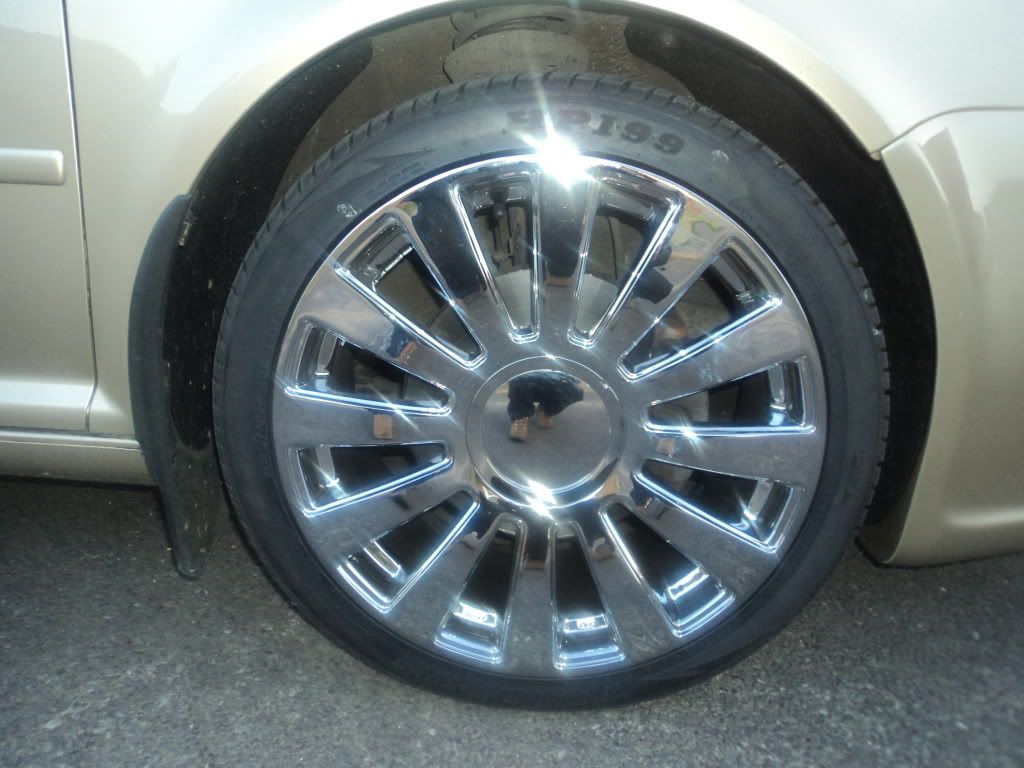

Posted 02 July 2011 - 02:38 PM

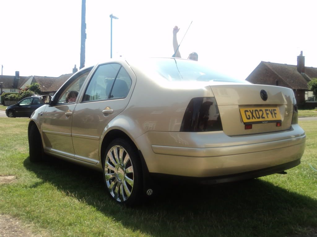

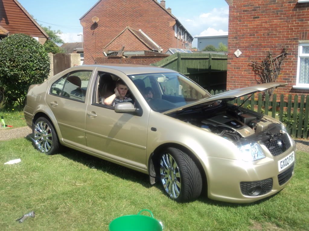

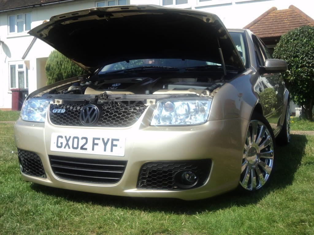

 saturday has come so the bora gets a clean, polish and wax
#4 callum_tdi
callum_tdi
    Boost Junky
  • Full Members
  • PipPipPipPip
  • 4253 posts
  • edge of sanity
  • MKII Models
Posted 02 July 2011 - 02:43 PM
 thats my nephew and daughter being lazy wilst i do all the work
police didnt seem to like my rear lights so had to get some stupid reflectors[paperbag]

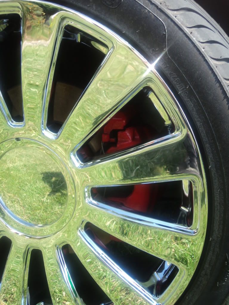

Posted 02 July 2011 - 02:44 PM
chrome is allot of hard work

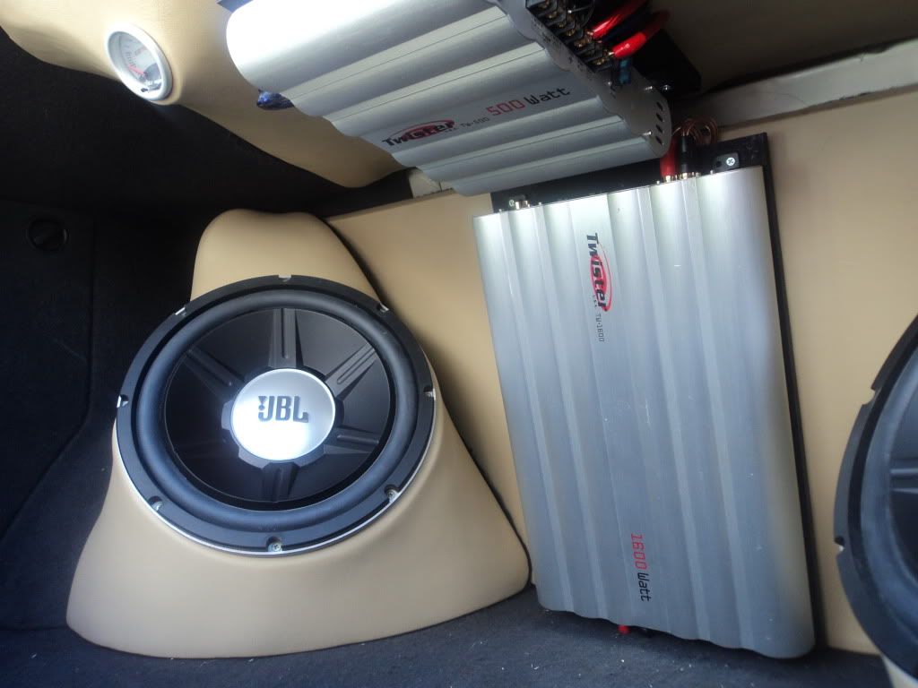

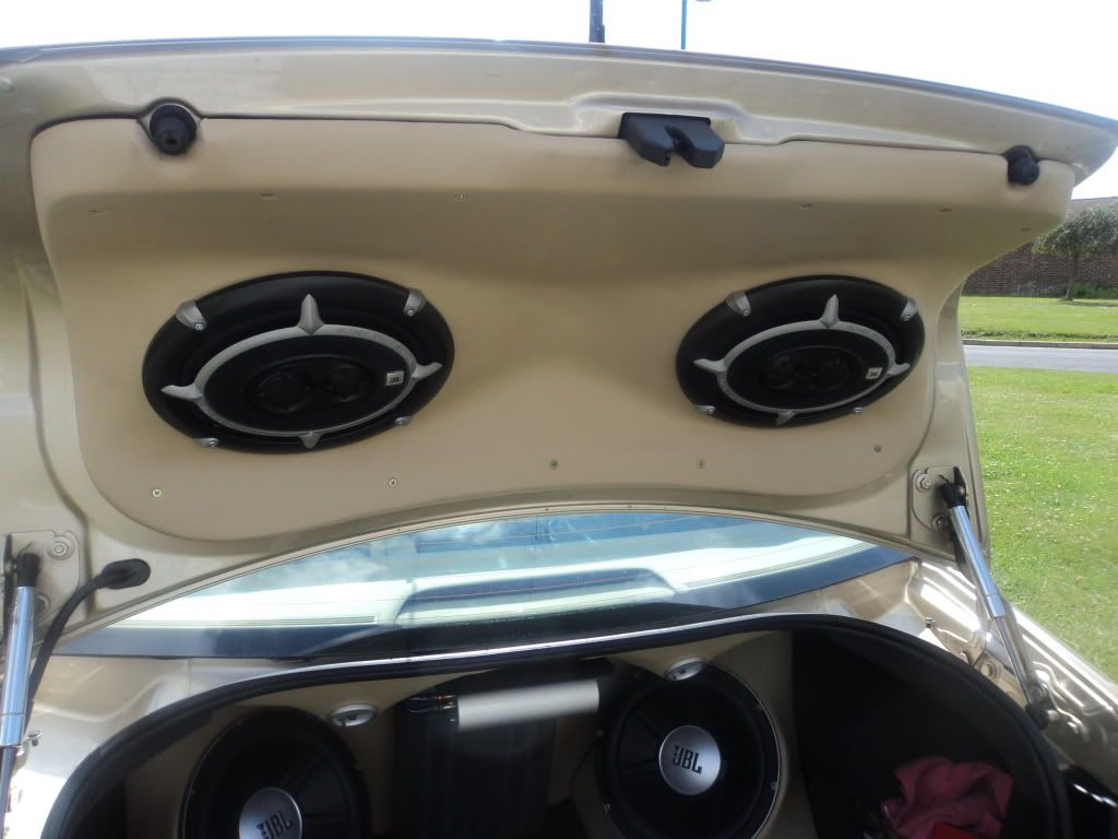

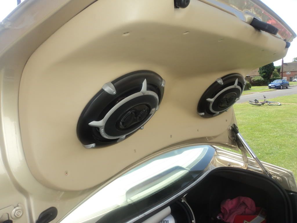

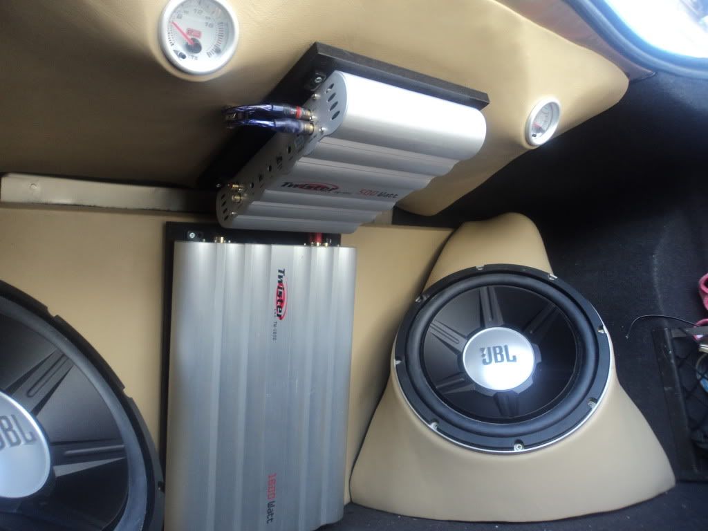

 finally got my sound system back from upholsterers this weekend [<:o)] so pleased withe overall finnish
got all fitted know and islooking good
#7 callum_tdi
callum_tdi
    Boost Junky
  • Full Members
  • PipPipPipPip
  • 4253 posts
  • edge of sanity
  • MKII Models
Posted 10 July 2011 - 12:58 PM
 dont know wat the missis is on about still plenty of boot space[*-)]

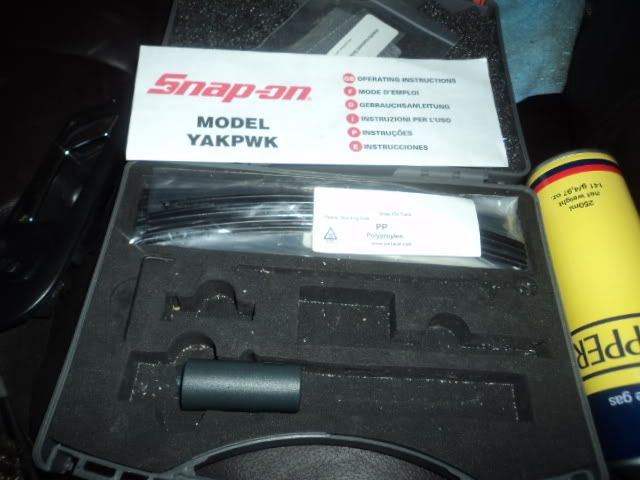

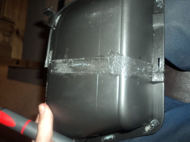

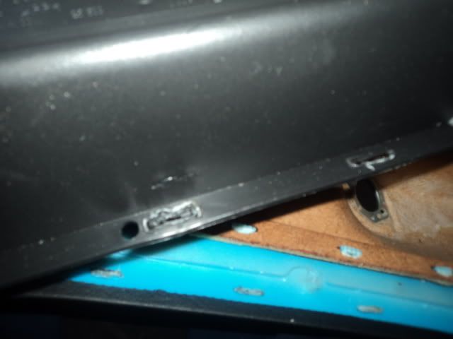

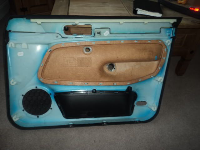

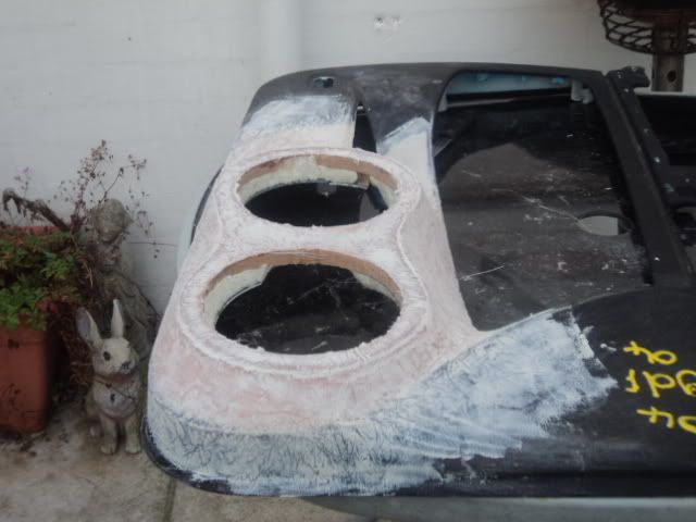

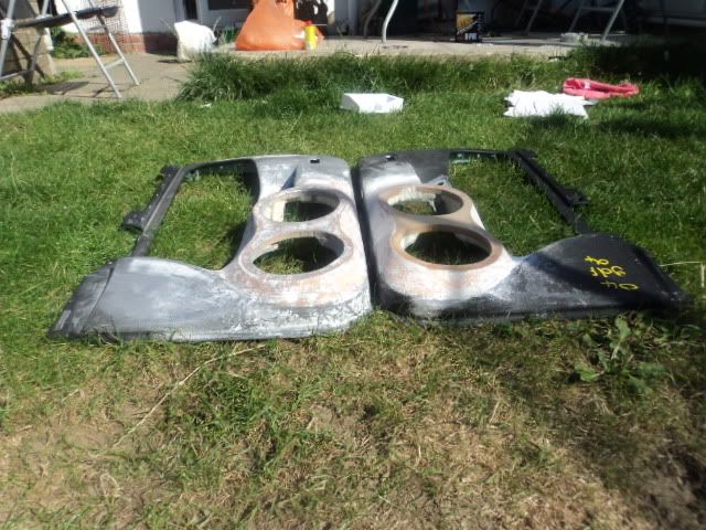

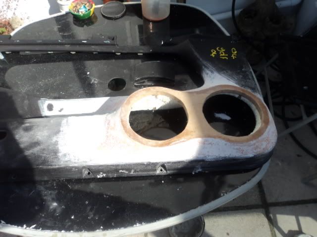

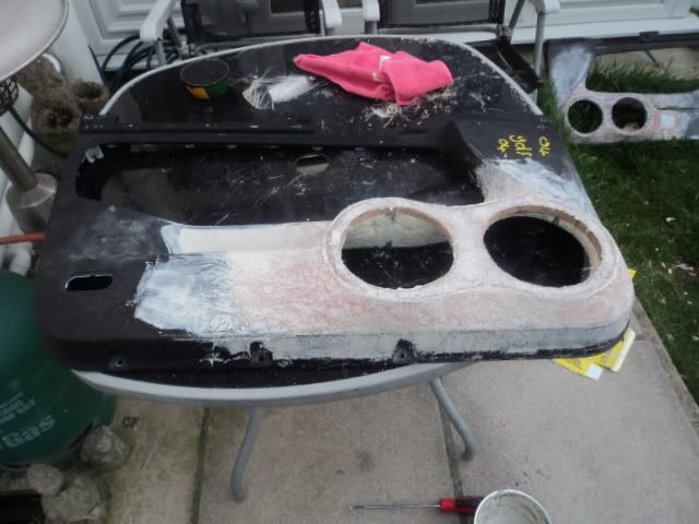

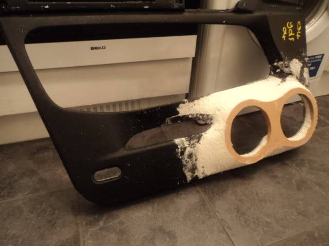

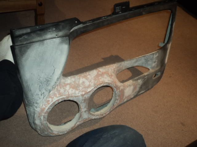

thanks to imagewerks finaly started my door builds thought id use the same method
using snap-on plastic welder

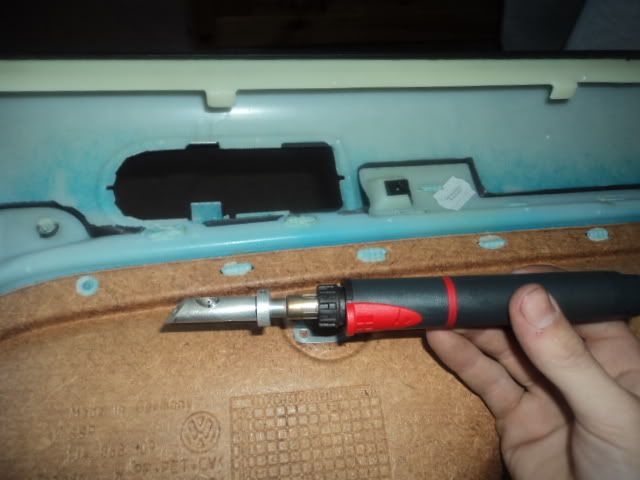

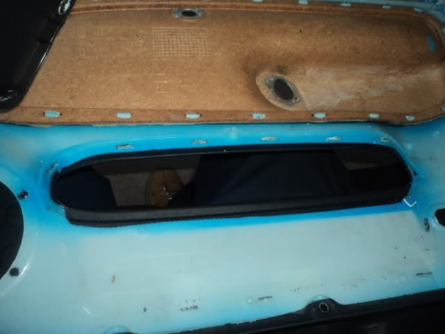

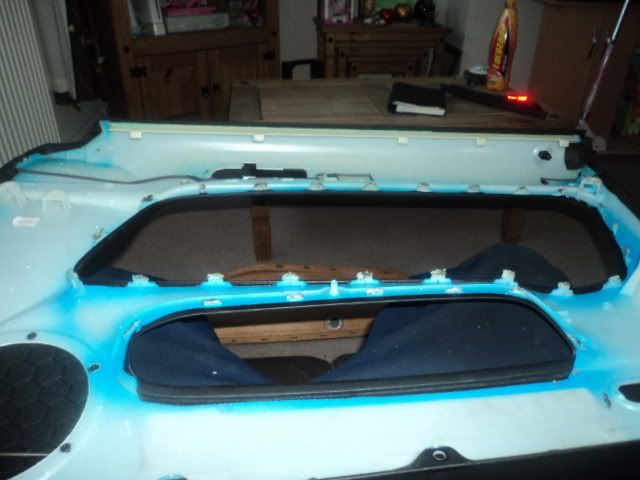

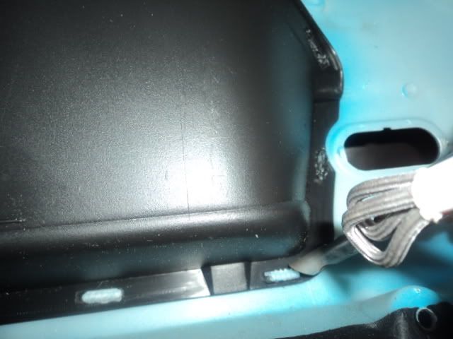

started by unpicking all the melted plastic that holds every thing together but not removing it sinply shaping it to fit back through the hole so it can be reused for reassembly
then removed the cloth section the same way
then speaker grill
then along with the top section

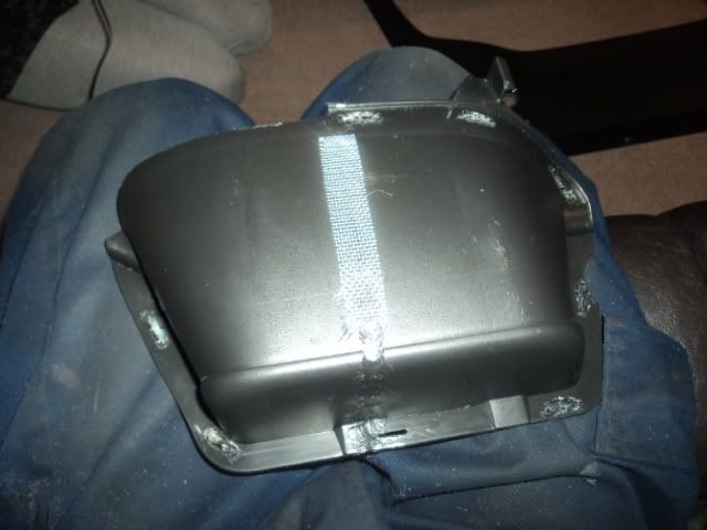

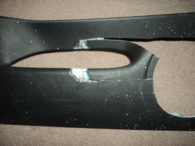

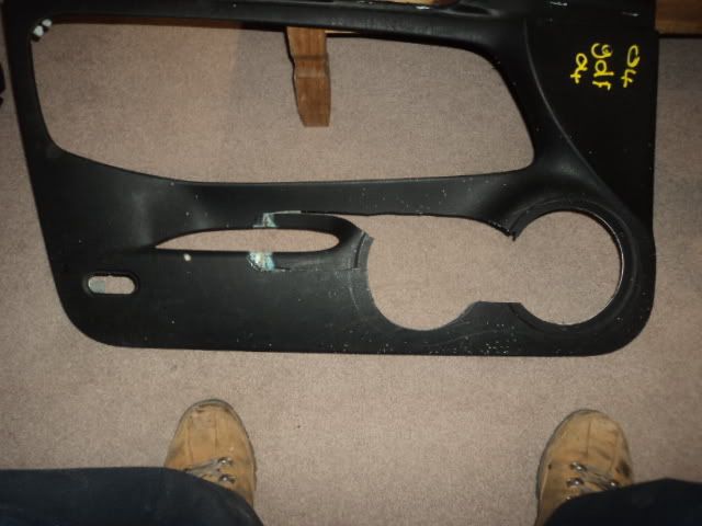

once all apart can start working with the peices first up is shortening the door pocket on the main panal to make room for the speakers
then of coarse is shortening the actual pocket
cut to size to match the opening then welded together
http://i1211.photobu...di/DSC00212.jpg
when it is holding nicley added som reinforcment grid/mesh and melted in

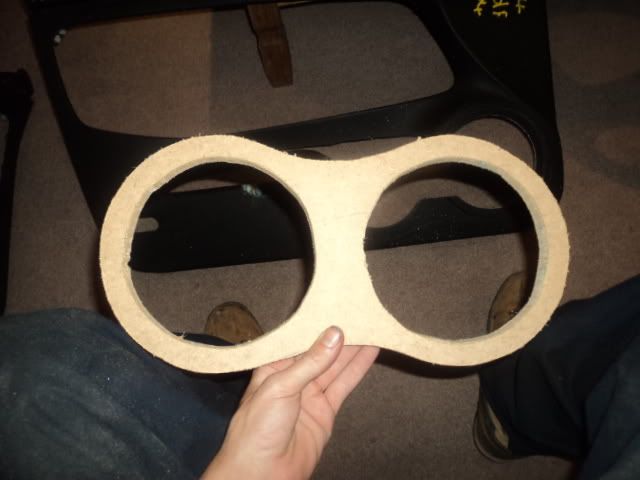

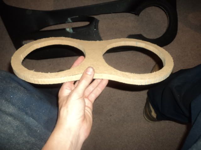

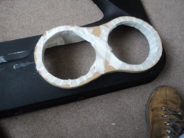

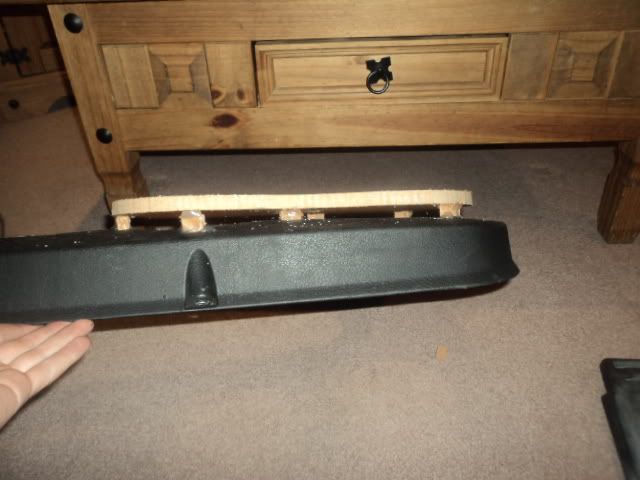

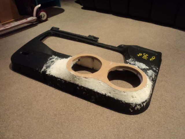

now i cut the baffle for the speakes to mount out of some 12mm mdf
then shape the door slightly for the baffle

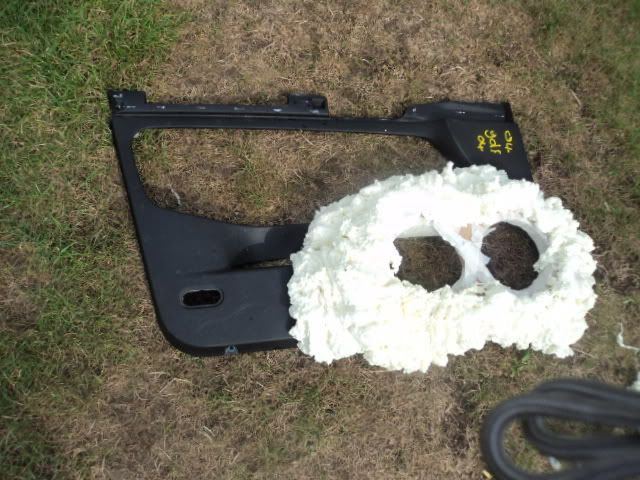

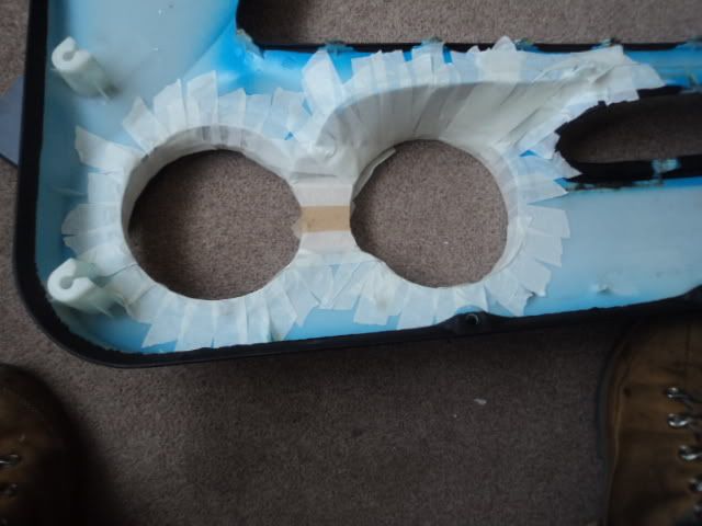

once shaped using some scap mdf and hot glue gun mounted the baffle to the door
then when its all cold and set mask up all the inside of the build
then u can start working with the expanding foamjust used cheap homebase sff nothing special
spray a fine mist of water over the work peice to begin as this chelps the foam to set get in all the tight spots first then build it up all around

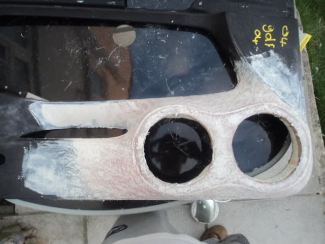

[Img]http://i1211.photobu...di/DSC00228.jpg[/img
next steps
cut excess foam and shape
aply fibreglass resin let set
light sand
then skim of filler and sand
then a couple of layers of fibre glass mat reason for first skim of fillef is so ther is no air bubbles uner the mat
then re skimm with filler then off to upholsterers for wraping

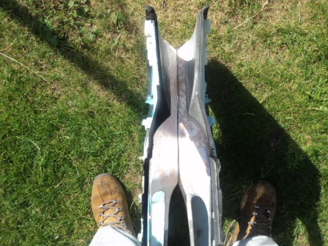

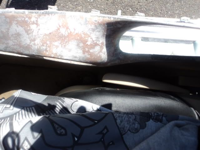

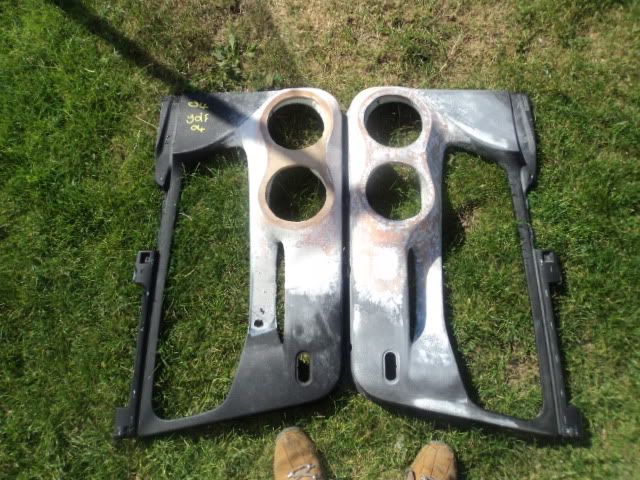

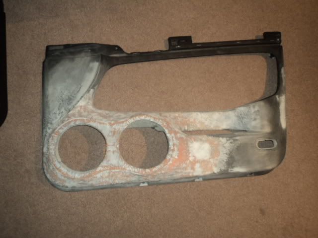

 little update started shaping the foam on the door card but as allways it got to dark to carry on
heres a pick of a near finnished drivers side but thought id show how i got there with the other side

Posted 14 August 2011 - 04:21 AM
Coming from someone who now can't open his glovebox properlyWhistle,do you still have full seat sliding with them sticking out like that?
yeah should be ok mocked up the baffle to the actuall door and the only thing that looks close is the up and down lever on drivers seat supose i could shorten that if it became a problem so should just have the glove box prob but thats liveable dont think iv used it any way lol

 heres a little pic for chris tested the panal to check the clearence now its together started to get paranoid after u mentioned lol
 this is with the seat further foward than my driving position so it looks fairly clear
and another
a little progress today first layyer of resin then skim of filler with a bit of shaping just so theres less chance of air bubbles between foam and matt
its so hard to try and replicate a shape without a mould but think im getting there
now with two layers of fibreglass matt ripped not cut as i find it shapes better but forgot to take pic untill i had added a heavy skim of filler
been using 40 grit emery cuts through filler like butter and dont have to worry about scoring as there being wrapped in vinyl and not painted
trying to get a passat cc finnish on the interior with two tone beige/black

Posted 14 August 2011 - 02:52 PM
Good work so far,a pair of 6s seem to look neater than a single 8in.
Am I to assume that you're fixing the speakers to this rather than to the nice solid inner door skin?
Chris.
P.S. 40 grit FTW[clap].

Posted 14 August 2011 - 03:04 PM
 yeah 16 cm speaker 145mm cut out yeaqh mounting to this
you like me 40 grit then lol so much easyer when u havent got to paint

Posted 14 August 2011 - 03:12 PM
You know it'll resonate like a biatch and colour the sound a LOT don't you mounting them like that? That's why the best sounding speaker cabinets aren't made from cardboard and 3mm thick plastic.
Chris.

Posted 14 August 2011 - 03:26 PM
 arh should be ok plenty of people have made builds like this even seen about 10 speakers on one door still sounded good, will prob get allot of deadening in there though
its only for personal use though so not gonna be entering any sound offs or competitions so not to worried
loving the grape thread most random one iv ever seen

Posted 14 August 2011 - 03:34 PM
Mine is also just for personal use,doesn't make it right just because every one does it like that though.How about building some sort of enclosure behind both of them so they only use the airspace in between the inner and outer door skins,just like the original speaker does?
