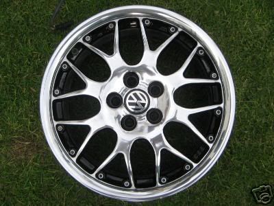

  • WHEEL CLEARENCE
  • Before you get excited and rush out to buy a BBK, you gotta think about your wheel clearance.
  • ***NOTE*** rims are different sizes,different thickness walls, and therefore some may not fit.
  • these are the minimum wheel sizes, some may be very close, and may need the wheel re-balance with the weights put on the outside(not the rim face, but just not in the way of the caliper)
  • also some rim designs may require some spacer to fit around the caliper.
  • ***alot of BBS split rims or deep dish rims will struggle to clear brembos or other monoblock calipers, normally a 10mm spacer is all thats needed to clear them***
  • 334mm R32 brakes require 17"wheels
  • 312mm TT brakes require 16"wheels
  • 288mm Brakes require 15" wheels
  • 280mm Brakes require 15" wheels
  • 256mm Rears need a 16"to clear the caliper(15"spare doesn't fit)
  • most porsche brakes need a 10mm spacer on the front

    #15
    • Validating
    • 873 posts
    Posted 13 September 2007 - 04:34 AM
    Thanks - I was thinking about getting some RXII's to replace my MontrealI's just for something a little different!
    RXII is the RX as a 2-piece split rim.
    Here is a pic -although these have been well polished and had the backs painted black - sooooo cool[H]
    nb these are available as 6.5 and 7 inch widths, but I guess it is the extra material needed for the bolts that makes them not fit 312's - no wonder there is SO many of these for sale on ebay and.
